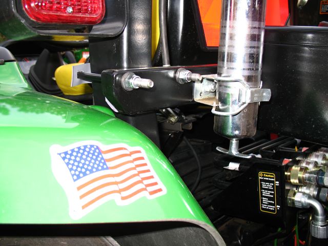

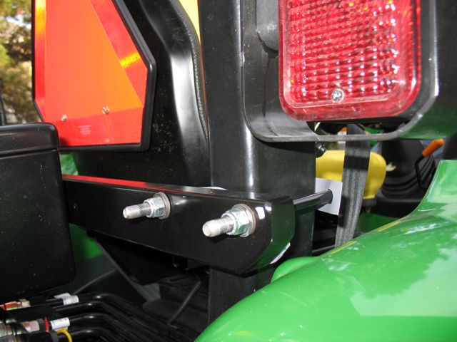

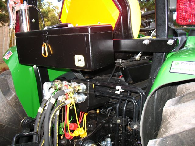

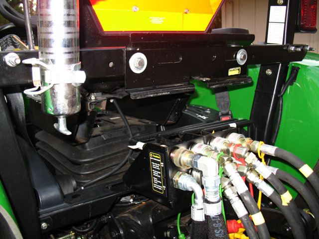

This is my solution for attaching a metal JD tool box to my 4720. It should be adaptable to most ROPS structures on other brands of tractors.
The bracket itself is a simple 1" x 2" square tube with the ends closed in. It is attached to the ROPS using square ended U-bolts. I placed some rubber gasket material between the bracket and ROPS so they would not rub metal to metal and create a rust problem.
The toolbox is actually 35 years old and has been in my family for its whole life. I repainted it this year when I made its mounting bracket. I believe JD still sells this same exact tool box today.
One unique thing about the JD tool box is that it is removable. The tool box has its own bracket which is what is actually attached to the 1" x 2" ROPS bracket (see photos). The tool box itself attaches to its bracket using an internal pin.
When the tray is in the tool box and the lid is closed, the tool box cannot come off its bracket no matter how much it is bounced around. However, when you open the tool box, remove the top tray, pull the bracket pin, put the top tray back in, and close the lid, you can take the whole tool box off its bracket and take it with you where ever it is needed. Also, when you have the internal pin in place and put a lock in the tool box hasp, the tool box is securely locked to the tractor. Very nice design!
BTW, as you can also see in the photos, I added a mounting bracket for a grease gun to the tool box ROPS bracket while I was at it. Can't run a tractor without a grease gun! :D

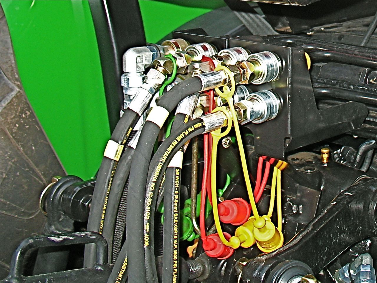

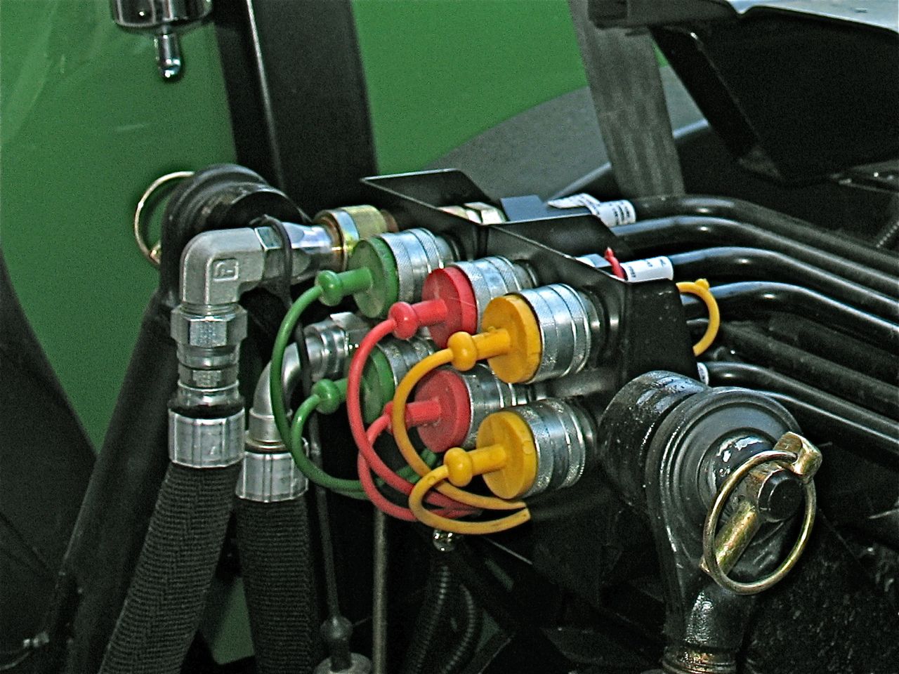

Nice looking piece of workmanship. But I have to ask will you know how to hook up those hoses if they ever get unhooked?
/ JD 4720 ROPS Toolbox Bracket
It's all done by color.
Each pair of the three valves has a different matching set of colored male/female dust plugs/covers.
The male dust plugs are attached to the female SCV conctors on the tractor. The female dust covers are attached to the male hose ends.
I also marked each "top" hose of the each pair with yellow tape so I know which hose plugs into the top coupler of each pair.
Hopefully the attached detail photos make it clear. Piece of cake! :)

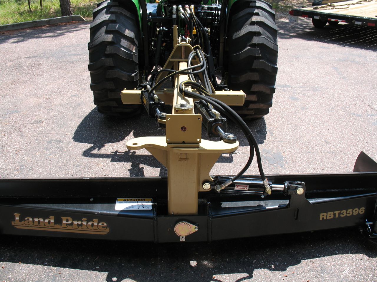

And just in case you're wondering what all those hoses are controlling, see the last photo. It's a Land Pride RBT35 rear blade with hydraulic angle, tilt, and offset. Sweet! :D
BTW... The far left SCV/Hose is JD's power beyond circuit. It's waiting for something like a backhoe sometime in the future.
