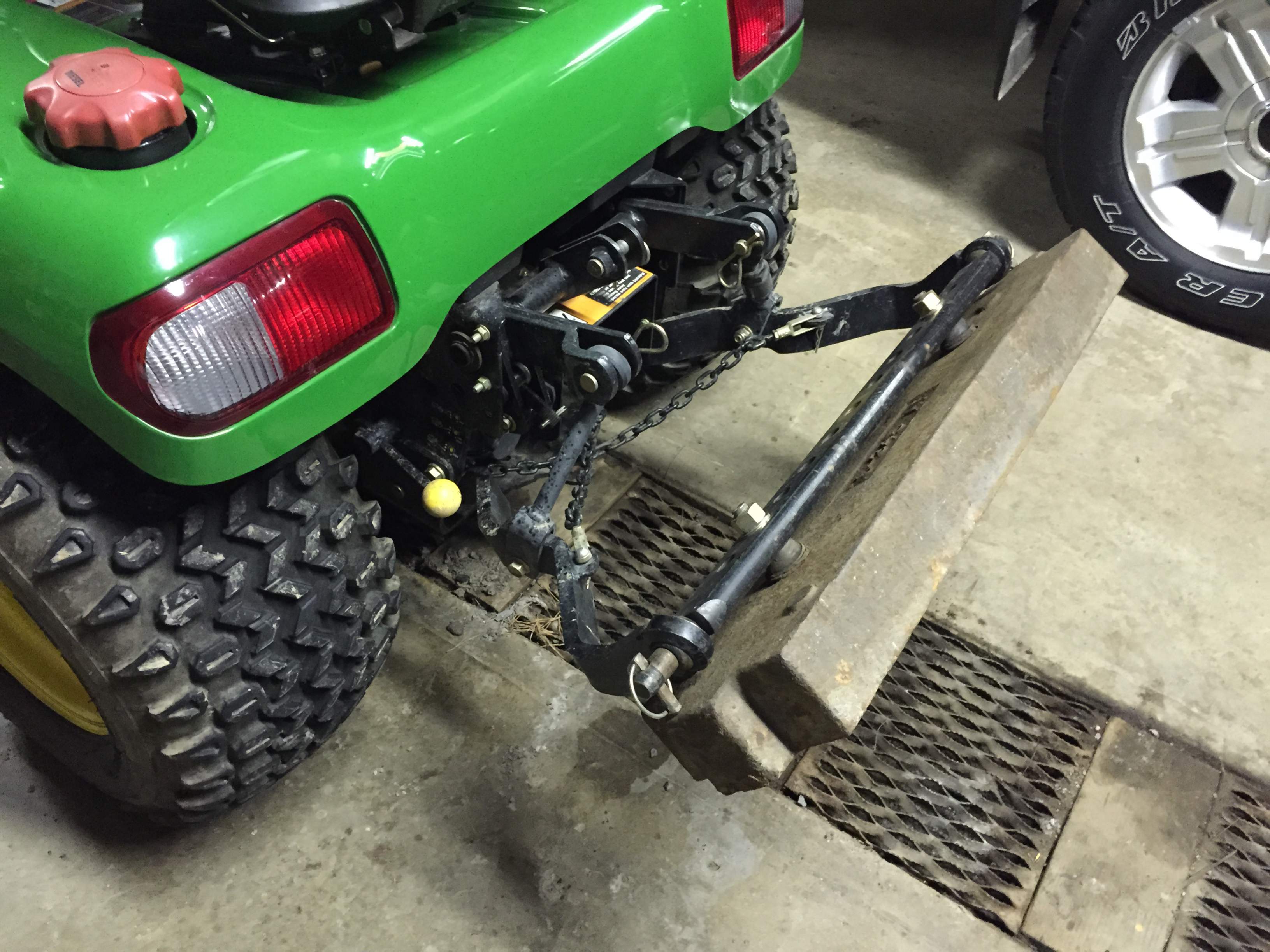

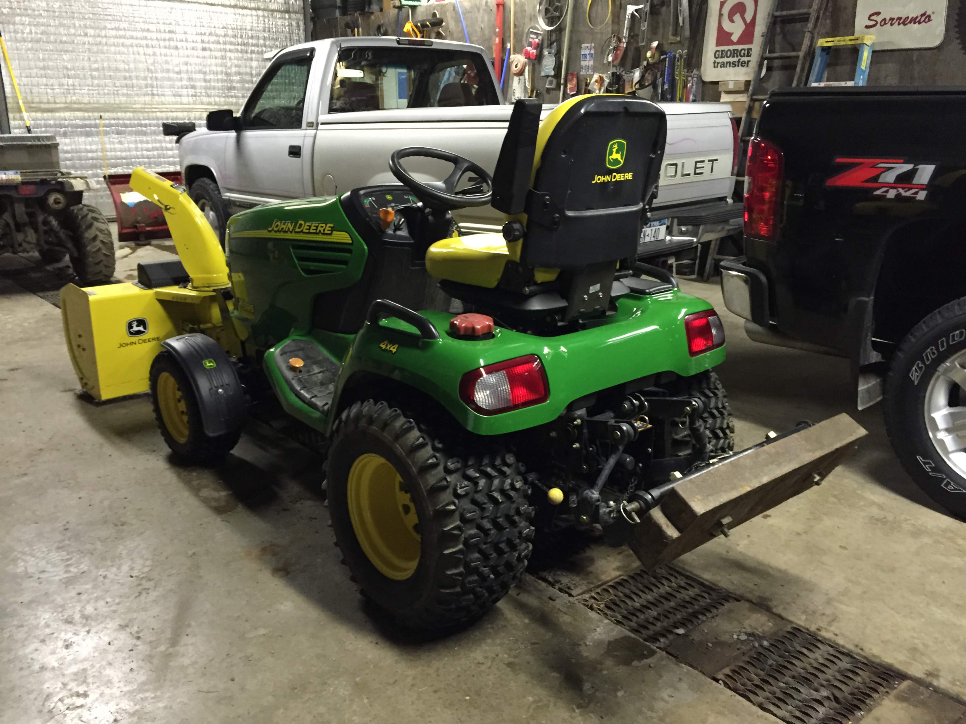

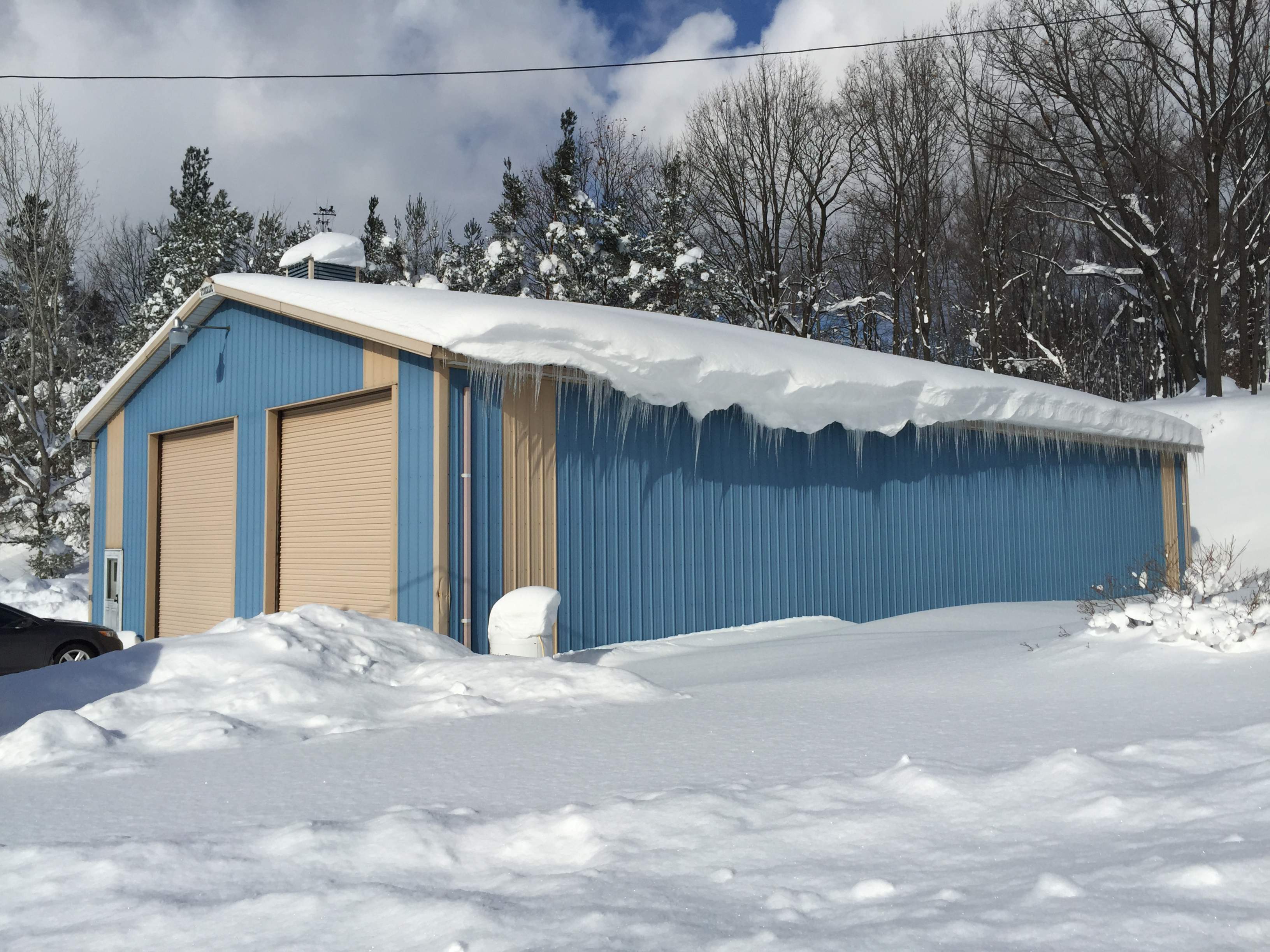

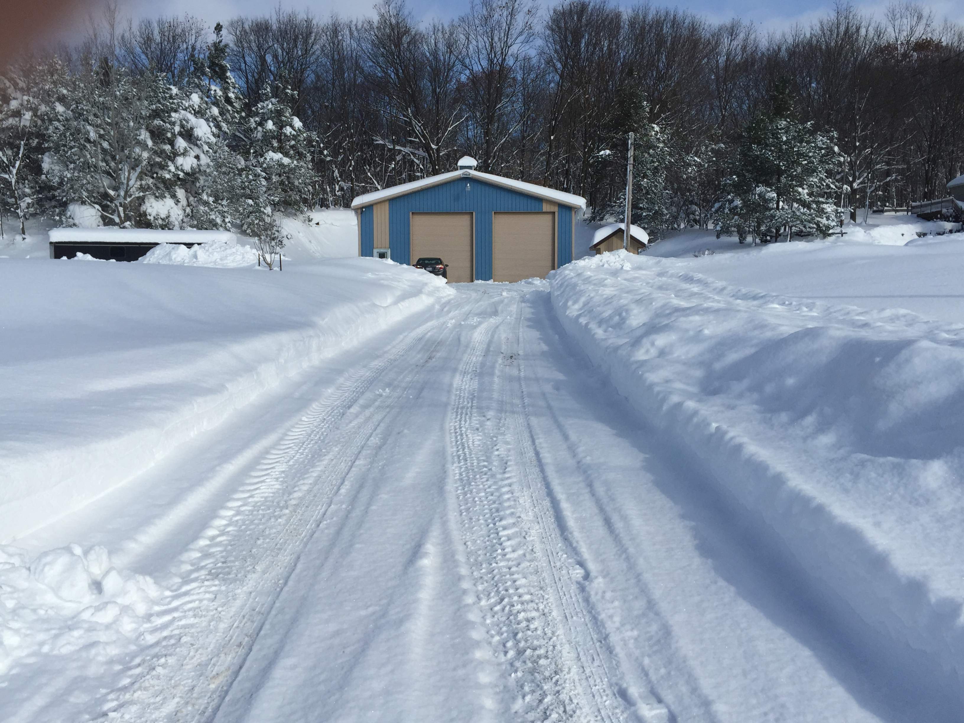

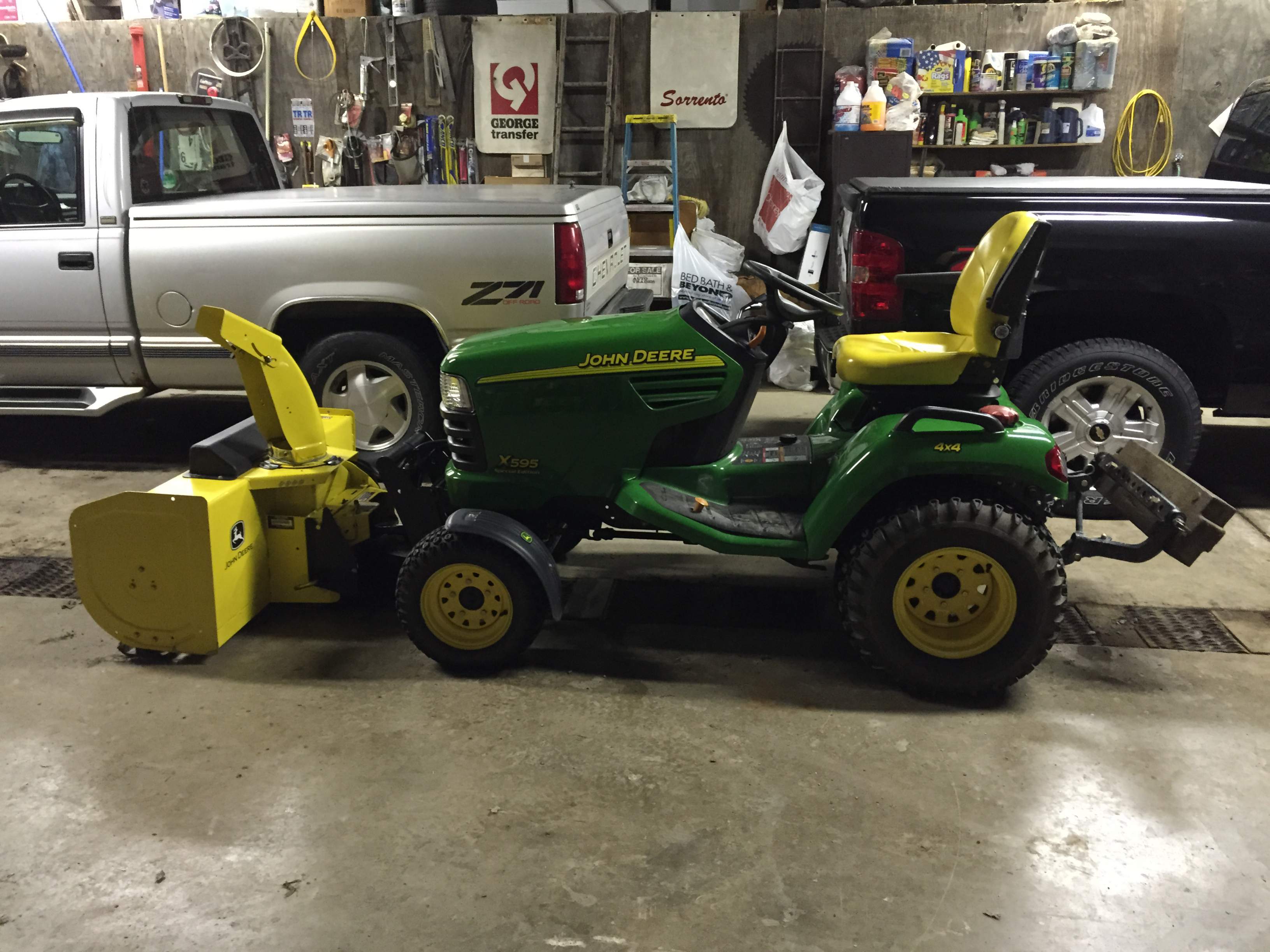

Well, so much for insurance, but he is awful happy that he bought the blower. He lives in Attica, NY, which is in the snow belt, not too far from Buffalo/ Lake Erie. Had lots of snow last week. I was back home for a funeral and got to take a look at his purchases. He got his plow truck stuck a couple of times and used the JD to help clean out around it. He also did alot of cleaning up with the blower. He really likes it and glad he made the purchase. He did get the JD stuck at one point, so we added an old elevator weight on the 3-pt. Hopefully it helps. Here are a few pic's. Thanks again guys for the info and help.
