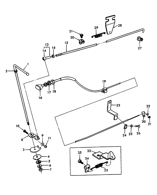

How do I adjust the throttle tension? The throttle moves from desired rpm to idle when operating.

My 4410 did the same thing. All I did was take apart the dash by the throttle enough so that I could slip a wrench down to the throttle and tighten the bolt that goes through the throttle pivot point. It didn't take much tightening and the problem was gone.

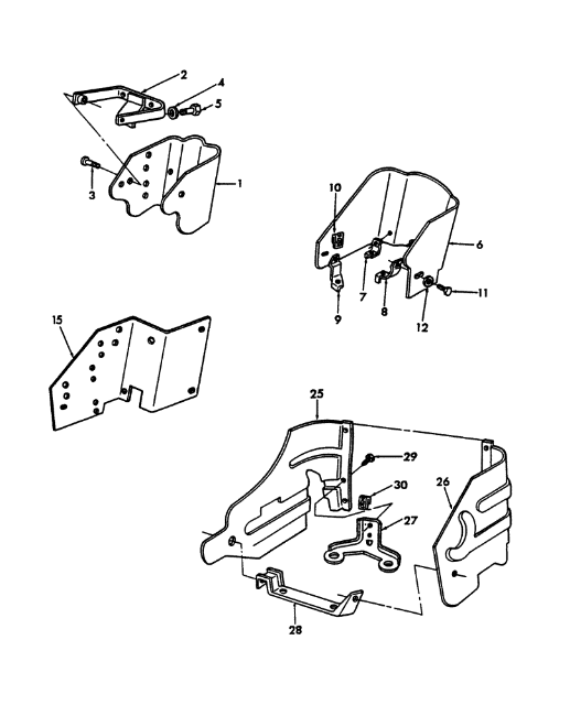

Any advice in taking the side panel off under the dash without taking of the steering wheel and the dash module.

I don't know if yours is the same as my 4410 but I just removed the blolts (screws) that I could and then by bending the plastic panel I could get my hand in with a small wrench. It wasn't a comfortable job but it worked. I got in from on top.

Rusty, your 4610 should have a steering gear cover held on with 3 or 4 screws. The cover is a "U" shaped piece of sheet metal like that pictured #6
ForumRunner_20150131_183645.png. Tightening nut #7 should get it tighter. If the friction disc #4 has oil on it, it will have to be replaced.

If you oiled the friction disk I've fixed them by cleaning them up ( break fluid or asitone should do it).
