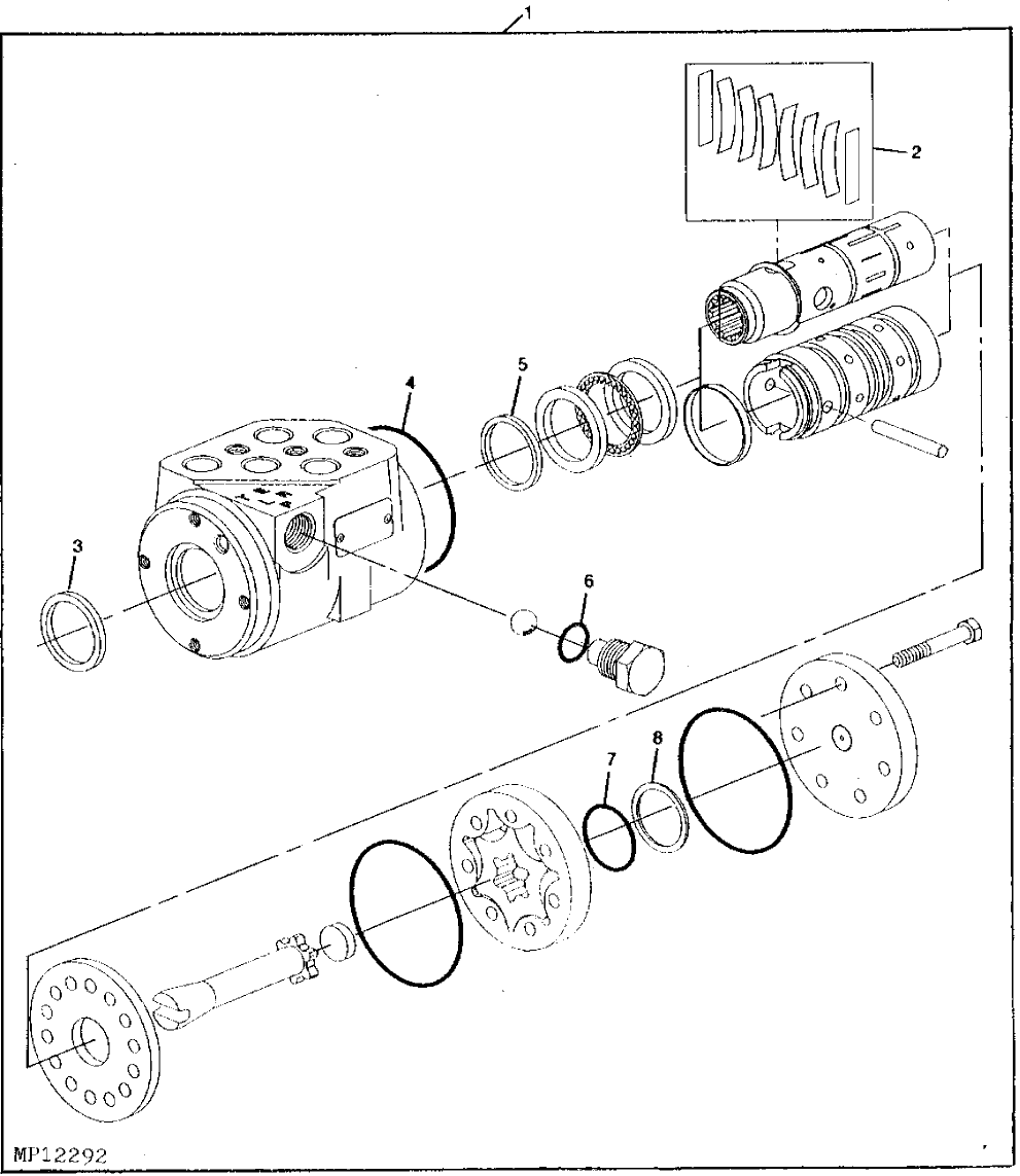

Hey all,
I noticed while schlepping some compost around that my suicide handle was in a different position with every trip to the pile. The cause is that the wheel doesn't stop turning at what should be the limit of travel. The steering gear stops at a hard limit, but the steering wheel can still be turned without a lot of force.
The issue appears to me to be the steering control valve, but I have no idea if there is a simple/cheap or difficult/expensive fix. Does anyone have any experience with this issue, or brilliant ideas?

Remember, you have boosted the hydraulic pressure. The orbital will bypass at full lock and you would have needed more force prior to your mod.

If that's the case, it's a side-effect that I haven't heard anyone else report. The IRV shim is supposed to be a very common mod.
I guess I noticed that the issue existed before the mod, but to a much smaller extent. You're saying that there is a bypass somewhere? Integrated into the steering valve perhaps?
Goat
/ JD 445 steering wheel keeps turning #4
I've not had one apart but I was told they bypass internally. Ball bearing type from memory? There's a seal kit available but no other parts listed. We only ever replaced the one that leaked as the customer wanted the warranty on the complete unit Vs. the rebuild. The apprentices took it and dismantled it one lunchtime and I last saw it in the recycling...

I looked up the pic. You could open that plug on the side and see what you find?
Thanks Spanner.
Wouldn't hurt to look. If there is damage or debris stuck in it, maybe I could avoid a replacement. I need to tear into it again tonight anyway. Higher hydraulic pressure = new leak to find and fix.

If there is no mechanical linkage from the steering controls (steering wheel in this case) to the front wheels (spindles/tie rod) you have hydrostatic steering.
If there is mechanical linkage you can have power steering. Whether a power steering box, or assist cylinder.
I think the JD 445 has hydrostatic steering too.
/ JD 445 steering wheel keeps turning #11
Yes to Zeb's thought.. the steering wheel in relation to the position of the front wheels is always changing. And at against the stops in both right and left, the steering wheel will continue, albeit slowly, to move.

Yes, no problem unless there is excessive turning.. which I've not experienced as "normal" operation.

Agreed not a problem. Most people do not notice the steering wheel slightly changes position unless the have a knob mounted on the wheel that gives them a reference point.

I've never experienced anything like this before, so the confirmation of 'normal' is appreciated. I didn't understand the difference between hydraulic and hydrostatic steering assist.
I still think that what I am experiencing is a bit excessive. When I say a different position, I mean as much as 180 degrees different.

A failure in the steering would be the speed of the turning, not the position degrees, I believe. If the speed is slow, no problem. If fast, then likely a problem.
There is no mechanical connect between the steering wheel and the front wheels.
Hope this eases your mind.
When I mow, the suicide knob (grew up calling it a necker' knob) continually changes position but not noticeably fast.

Both my 300 series and my Kioti do the same thing. It's normal. In my case it seems like I can turn the steering wheel faster than the front wheels are turning.
