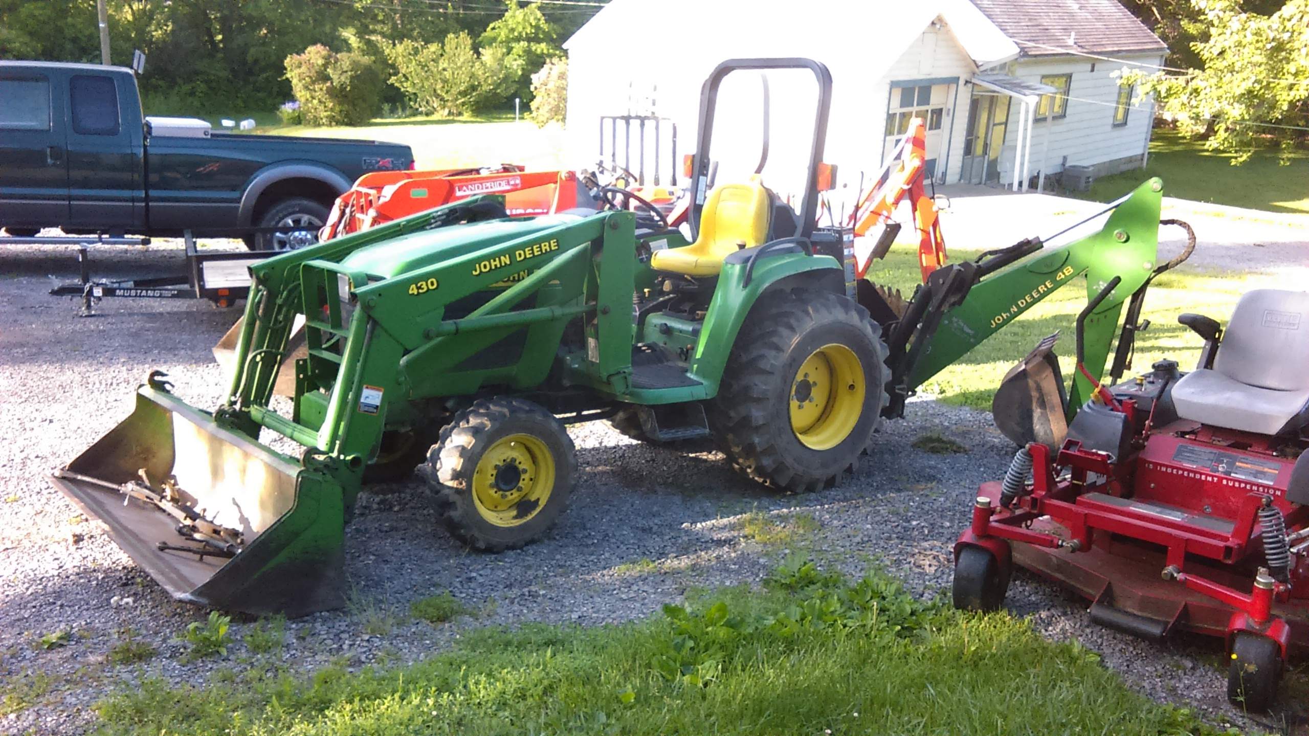

Hi guys, long time lurker first time posting. Last year I bought a 4300 with a loader. Then I started looking for a backhoe for it since I'll be building a shop soon. I ended up finding a 4400 with under 500 hours in better shape complete with a 430 loader, 48 backhoe, mid PTO, foam filled R4 tires, etc. Second owner had it since 20 hours at a small farm and stored under a car port or barn. Looked good and the price was right so I bought it. The 4300 will be for sale soon once I fix some minor issues with it.

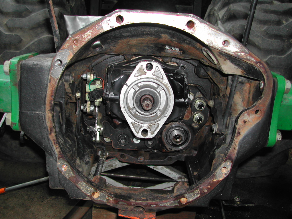

Dad picked up the 4400 for me and noticed that when you first hit the hydro pedals, it doesn't move unless you give it about 1/2 throttle, then it chatters like it has air in the system. Also runs away going downhill sometimes, but has plenty of power pushing dirt and the steering/loader/hoe all work great. We've worked on a fair number of hydrostatic lawn tractors so decided since the fluid didn't smell the best (suspect it is the original fluid) maybe the plates in the hydro were scored allowing loss of pressure. Pulled those out and weren't too bad, but resurfaced them anyway. New JD hydro fluid, filters, suction screen cleaned, etc. Drives a little better but still not nearly as smooth as my 4300, and still the dead pedal when first started.
It's sitting in dad's garage at the moment 5 hours away, I hope to get it hauled to my place soon and better investigate the transmission.
So, do the symptoms ring any bells?

You have to split the tractor and disassemble the HST. Not all that complicated (relatively speaking) but it is tedious and does take time.

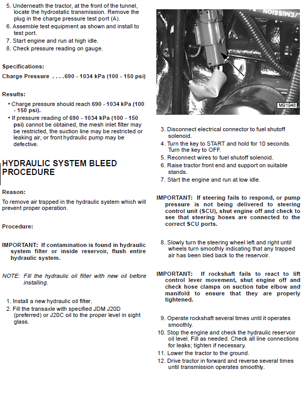

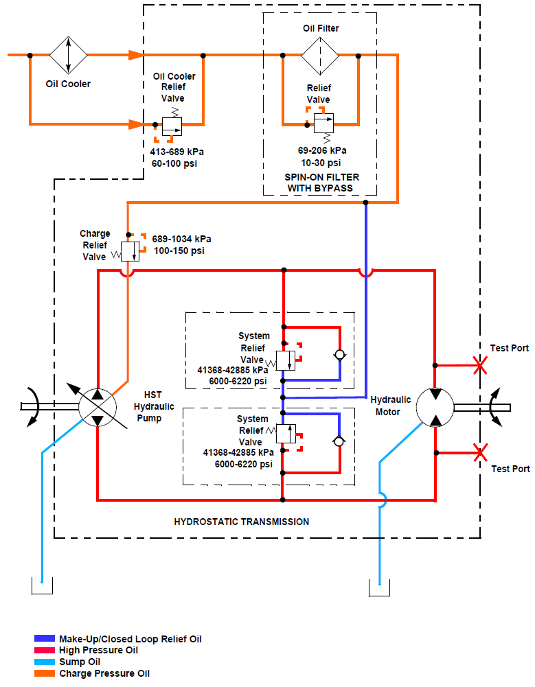

Started looking through the tech manual, my best guess is a problem with the charge pressure relief valve. Either a broken spring or debris caught under the poppet letting the pressure drop too much at low RPMs, and while the tractor is not running maybe it's letting the oil drain out of the pump. That's making an assumption that the relief dumps to reservoir, which the manual is not clear on.

According to the schematic (which could use a little more detail), the only logical place the charge circuit oil can escape back to the reservoir is through the charge pressure relief valve. It's certainly not leaking externally.

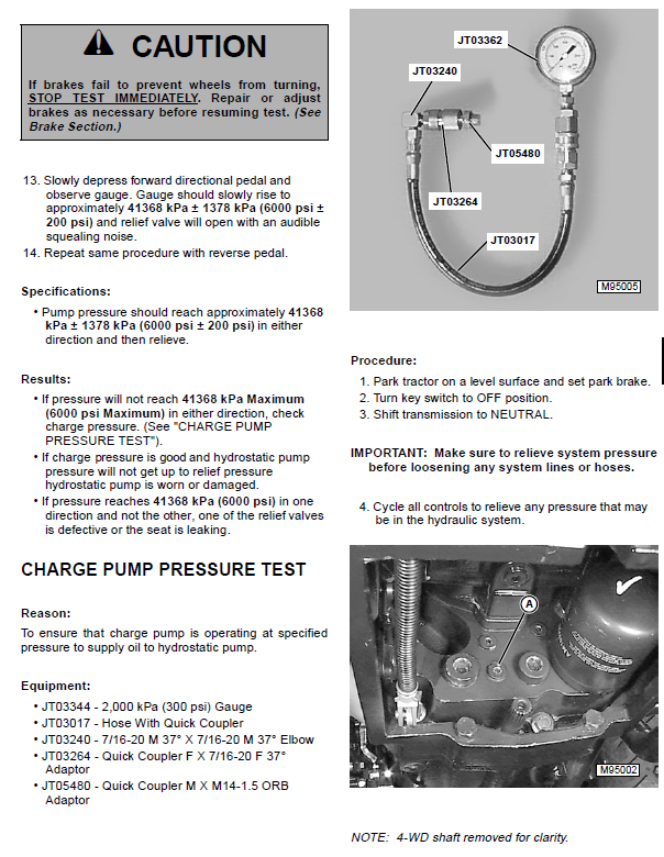

I agree with you that to chatter as bad as it does it seems like it would have to be ingesting air from somewhere, so if the valve looks alright I'll have to get a gauge to check for at least 100psi of charge pressure and see if the oil is foamy at the check port and go from there.

There are pressure test ports for charge pump and the FWD/REV functions. You should get something
like 150psi for the former, and nearly 6K psi for the latter 2, on relief. You can get at the test
ports thru the hole in the bottom of the housing. It is a tight fit, I know.

As luck would have it I talked to my dad yesterday about my theory and explained what to look for. Tonight he called and said after taking out the charge pressure relief valve, it looked like the poppet was sort of off center when he pulled it out. Cleaned out the hole with a magnet and a rag, put it back together and now it drives like brand new! Nice and smooth even at idle. Gotta love it when a theory comes together! Too bad we didn't check that first before splitting the tractor and re-finishing the plates, but only cost us time, some sealant, and $15 for the manual. Now to get it hauled down here and start building my shop :cool2:
