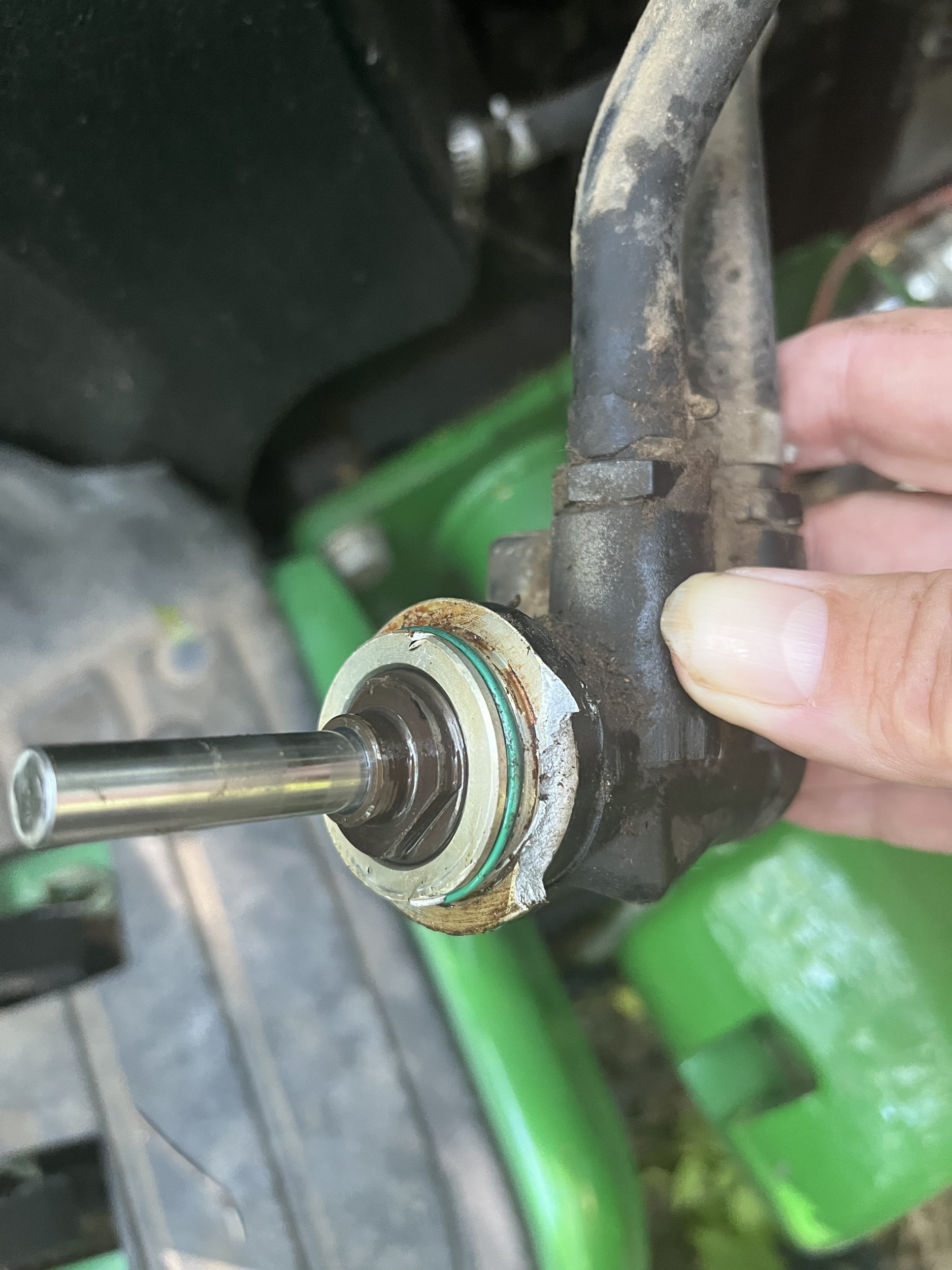

When you say "bit of fluid escaped", is that what is running down the side of the engine block or is that possibly fuel?

Got new part
   / JD 4320 sub compact
#14
I replaced this part. Cranks over but does not start
Any suggestions

Have service come out. Looks like cam shaft that spins were fuel sensor goes is frozen
They r going to have to take in
I afraid on how much it will cost
   / JD 4320 sub compact #16
Sorry we could not help you get it going. I really can not imagine it will be too bad price wise to fix. Most likely it is a simple thing that will just take time to locate.
Please Let us know how it turns out.

Thanks for advice. It’s well appreciated
My bigger concern is tractor is way out in woods. So a arm and leg to get out

I would look closely at the wire on the fuel solenoid. Could have pulled off.
I need help
Was brush hogging and a large branch hit one of the hydraulic lines shouting off tractor. I removed the branch but now will not start. A tiny. Bit of fuild escaped
Turns over but no start. I’m in the middle of no were
Any suggestions??? I will go to dealer tomorrow
