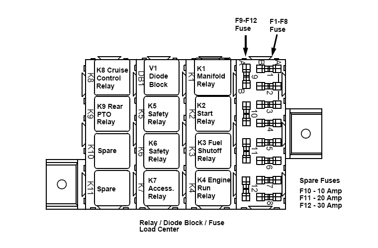

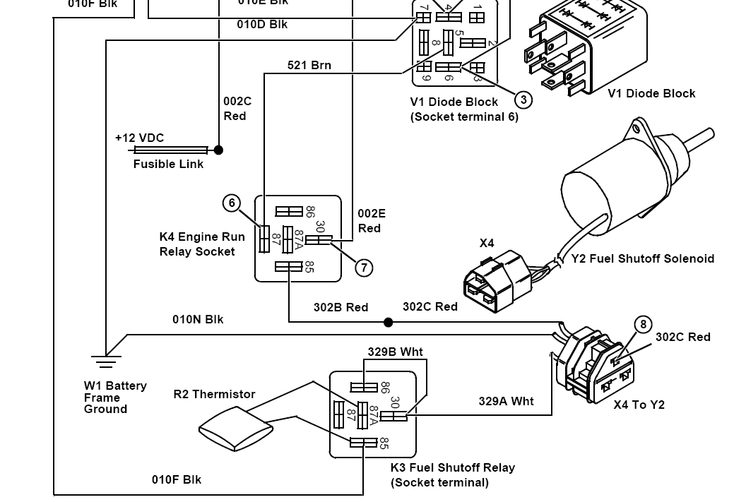

I'll check out the sediment bowl and thermistor this weekend. Anyone have a diagram where I can find the thermistor? I guess I could run by the local JD dealer to see if they can print me out a copy. (I just need to break down and buy the FSM).
   / JD 4300 won't crank #29
It is on the back side of the fuel shut-off relay socket.

Small Updated.
Finally had a chance this week (after ordering the service manual) to check a few things. Fuses test good (although they were really dirty; so I cleaned them up). Looks like the thermistor had been replaced before. On/Off switch on seat tested good. Fuel solenoid was clicking on and off properly and had power to fuel pump (using test light).
I'll try this weekend to go through the book replace the fuel filter and clean out the sediment bowl.
