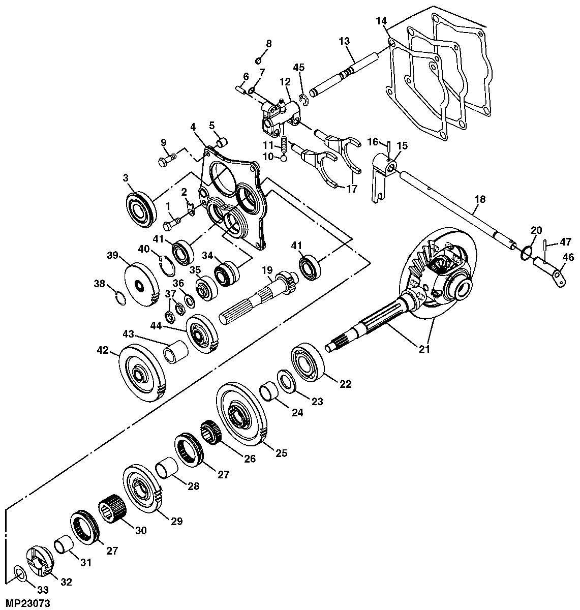

/ JD 4300 Sync Reverser Transmission Problem #6
I'm going to go out on a limb here and say that it's either the shift forks or the synchronizer for B range. If I'm right it's going to cost more to split the tractor and put it back together than for the parts. If the gears are wore enough so that the syncronizer gets walked off of the gear then they will need to be replaced too.
/ JD 4300 Sync Reverser Transmission Problem #7
I agree with pmsmechanic . If I looking at parts photo correctly parts #29 is mid range gear and collar(parts key #27) must engage that gear.
