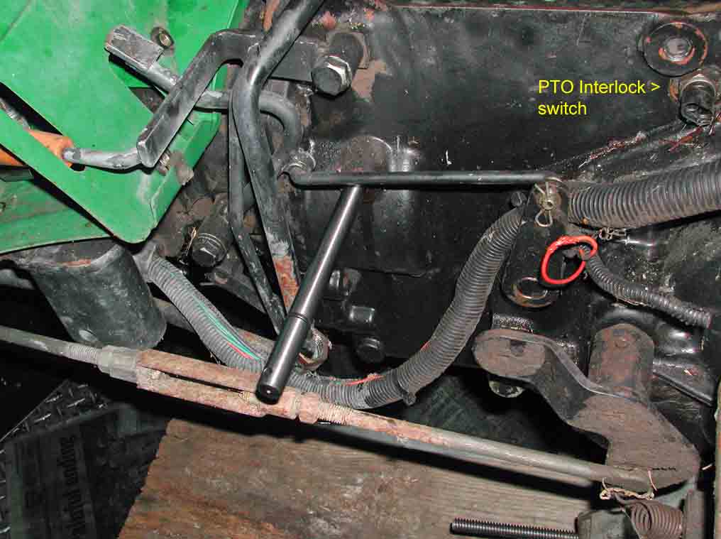

Here is where I am putting the new range shift shaft into the side
of the gearbox. You can see the infamous O-ring groove where it
breaks. This shaft has gotten pretty expensive, but it is hardened
steel. I am not against making one without the groove, but I think
if you don't force the lever, it will not usually break. Mine shifts
quite easily, when the gears are not loaded. I also put an O-ring
between the body of the bellcrank and the housing to keep water
from getting in there and making rust.
I have noted the PTO interlock switch, which eventually fails, keeping
you from starting the tractor. Mine failed shortly after I bought this
project. I have jumpered and soldered the wires and sealed then with
silicone (orange wires).
Starting the tractor with the PTO already engaged may actually be
desirable. It is also the most gentle you can possibly engage this
kind of PTO, essentially eliminating shock to the clutch pack.

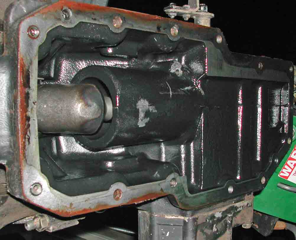

Before I close up the hatch, here is a photo of the 3-pt cylinder.
Hema makes these by boring the cylinder right into the cast steel
of the housing. Some other tractors have a cylinder bolted or welded
in there.

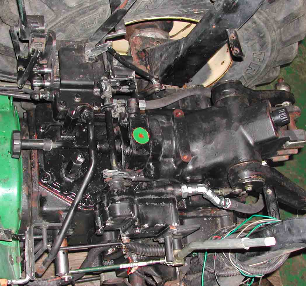

Closed up and rusty patches cleaned & painted.
The green bit in the middle is a homemade dust cap for the load check
valve (JD now wants $15 for the plastic cap that often falls out).
You can see the new range shift bellcrank and linkage at the bottom of
the photo.
I have replaced the power beyond hardline between the AUX valves
and the 3-pt cylinder valve with a hose and QDs for a backhoe PB
loop. The inline filter, which looks like a fitting on the 3-pt cylinder
valve, had failed. I would not be surprised if most of these out there
are inoperative.
