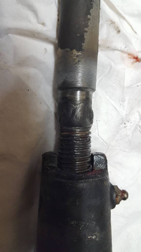

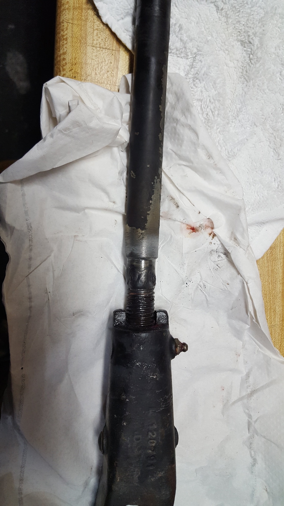

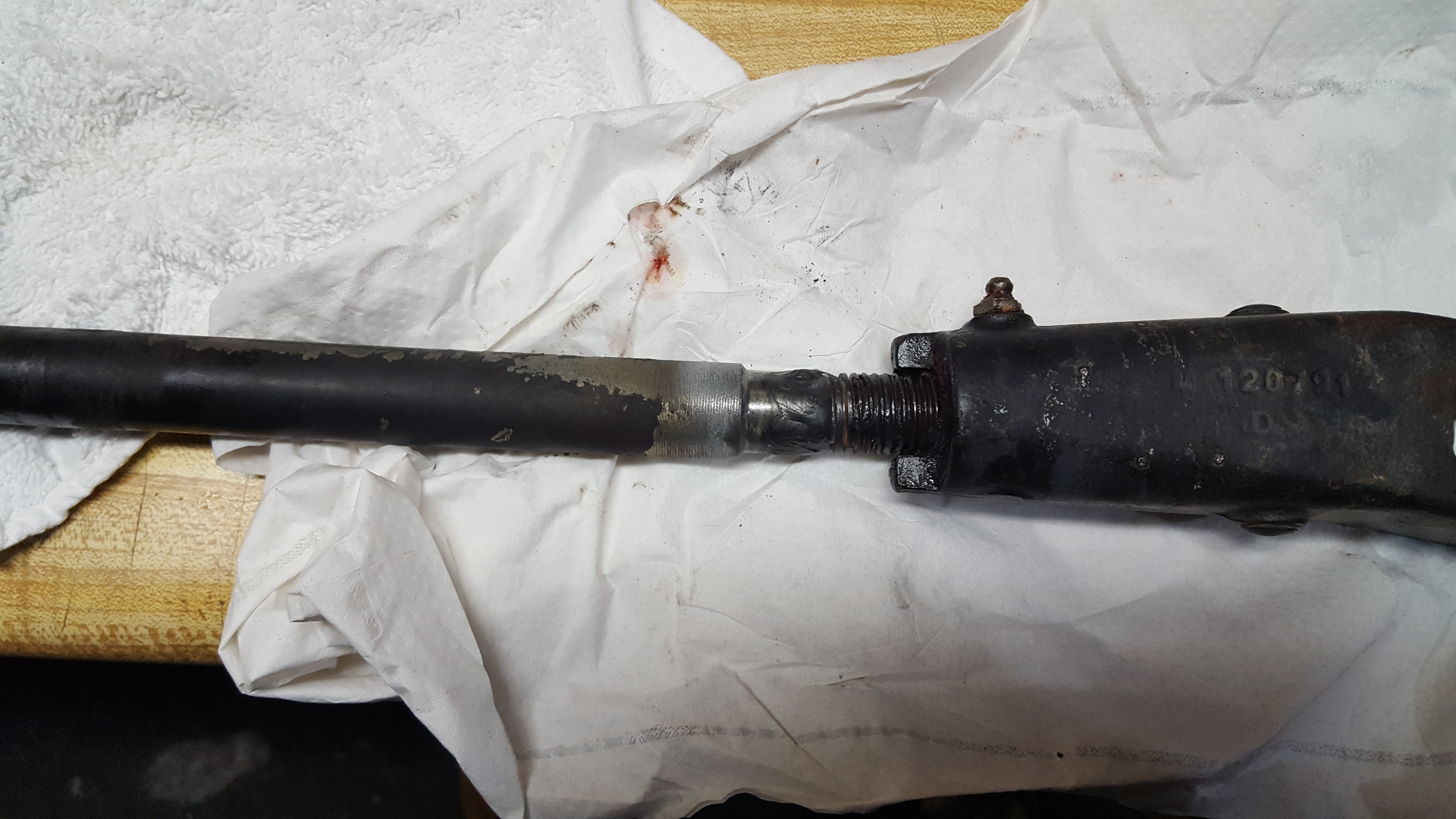

I have a used 4300. The rear says it should be able to pick up about 2,200 lbs.? Well this is twice now the left lift linkage has broken on me. I had it welded once and now it broke in another spot. Both times in the threads. I was only picking up my disc at this time. Anyone have problems with this too? Seems to be a costly repair at $255 per break!

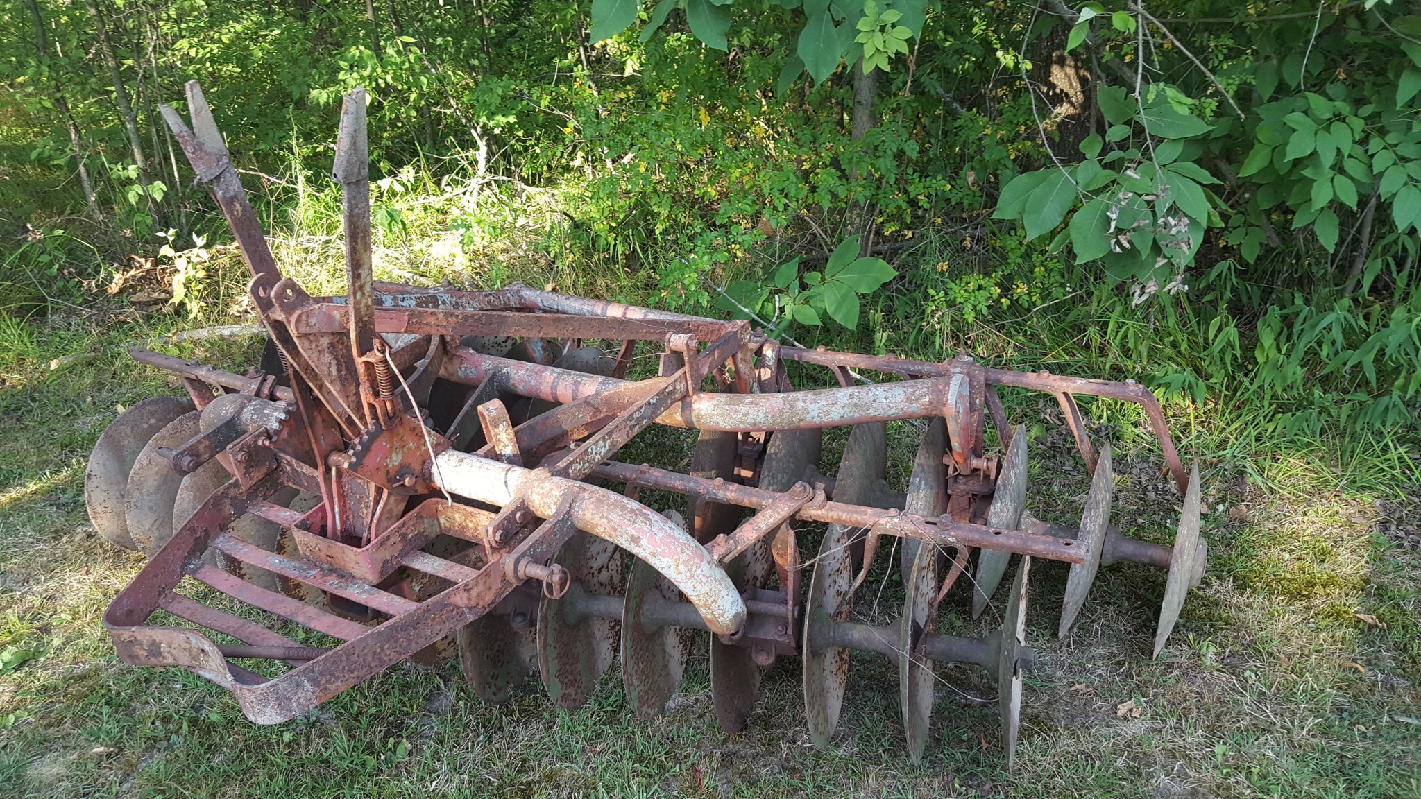

What is the weight of your disc?
Spec for Three Point Hitch lift capacity is at the Lower Link bullseyes.
Tandem Disc Harrows are cantilevered far to the rear to the Lower Link bullseyes, making disc effective weight much higher than scale weight when pans are not contacting the ground.
Then, when the disc bounces, transient forces increase weight on the Lower Links further.
   / JD 4300 Lift Link BREAKING!
I'm not sure the weight. It is an older 8' tandem Massey. I know its probably too big for the tractor, but my old Ford Jubilee 9N handled it decently. So figured this tractor would be piece of cake!
The first time it broke, I was carrying a small load of wood on a carry all. Again, I don't believe it to be anywhere the lifting capacity.

Here are some pics of it after it was fixe the first time. This time it broke off further down in the threads.
