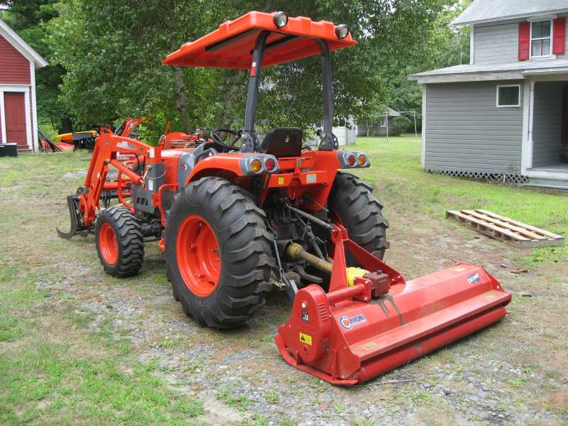

I have a Kioti DKse40 which will do everything you ask. It is the identical tractor to the 45 minus precisely 200cc of displacement and 4hp and about $1500 when I bought it. I run a six foot flail at 400rpm less than PTO speed and it does a great job in fields and bush hogging. The KL401 loader is great with 2700lbs lift at PP so would do well for moving hay bales. The tractor is also pretty heavy so with loaded rears you might not even need (much) extra counterweight to handle bales.
I don't know the current price but I paid a little more than $18,000 for the HST version with loader and extra remotes three years ago. Tractor has been totally reliable and is a work horse.:thumbsup: The electrohydraulic clutch does lurch more than a manual clutch but I've never had trouble running the flail, a bush hog, chipper or a tiller. Just make sure the engine is at idle speed before hitting the button.
Kioti pricing is sometimes tricky as some small dealers quote list thinking that because the list is less than the Kubota list they will get your business. That is obviously wrong as most Kubota dealers discount by 10-15%. When I found a Kioti dealer who discounted a similar percentage, I saved about $6000 compared to the local price on an equivalent Kubota (L3940). I've never comparison shopped vs JD or NH. FYI, the Bobcat CT440/445 are the same tractor as the Kioti DKse with different paint and different but comparable loader. Not sure of the pricing but unfortunantely I believe it is only available with HST.
