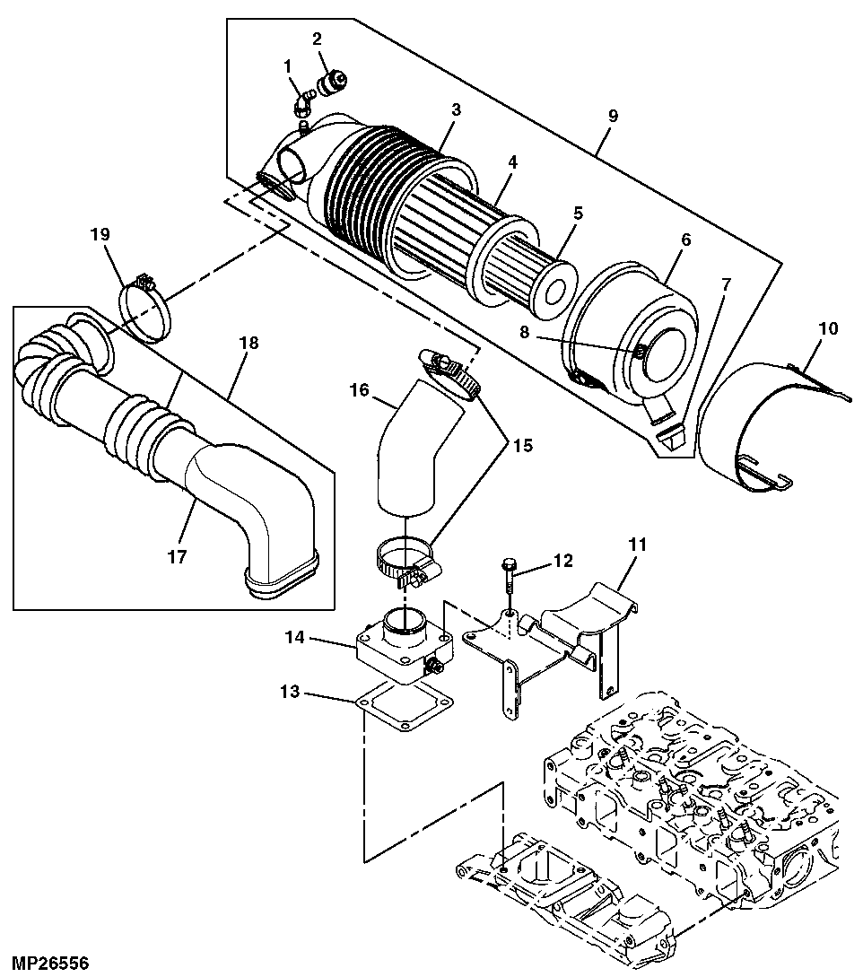

As RG1 wrote, its a DI engine so no glow plugs, but there is a intake/grid heater (#14) that's active when the key is in the start position I think.
AIR CLEANER
Cart key PART NO. PART NAME QTY SERIAL NO. REMARKS
1 M808310 Adapter 1
2 M807334 Indicator 1
3 M810109 Housing 1 (SUB AM881018)
4 M113621 Filter Element 1 PRIMARY, (SUB FOR M807332)
5 M123378 Filter Element 1 SECONDARY, (SUB FOR M807331)
6 M807333 Cover 1
7 RG60692 Valve 1 UNLOADER
8 ...... Indicator 1
9 AM881018 Air Cleaner 1
10 AM878832 Band 1
11 M810307 Support 1
12 19M7897 Screw 4 M8 X 35
13 M805836 Gasket 1
14 M801118 Heater 1
15 TY22470 Clamp 2
16 M810110 Hose 1 LOWER
17 ...... Pipe 1
18 LVA800458 Pipe 1 AIR INTAKE
19 CH16875 Clamp
This is interesting. I never knew that heater block was there on my machine, but I just went and checked to see, and sure enough.. There is a wire running to it, so it may actually do something, but there is zero mention of it anywhere in any of my manuals, nor any of the sales brochures or Grounds Care catalogs that JD used to put out that I have from the time frame that the 4115 was in production. I'm not sure I understand what it does/how it operates, if anything at all. It certainly doesn't do anything to aid the cold starts that I have found so far. I have tried leaving my key in the on position for several seconds, turning it to the on position and holding it in like I did on my 4500 for several seconds etc., just to see if there was anything similar to the 4500 that my manual failed to mention. The only things to aid cold weather starting mentioned in the manual is to install the coolant or the block heater.
It seems that if holding the key to the start position with the pto knob on or the gear selector in gear would make it work, the manual should at least make some mention of the thing one way or another.
Next winter, I am going to try what you said and see if the thing starts any faster. Actually, the 4115 starts pretty well, but it runs like it is really cold for a while. The heater system on my 4500 made it run good almost immediately.

Since there seems to be doubt about what I wrote, please see these two pages from the FSM. There is no mention in the OM, I don't know why...

It's not a matter of doubting you Kenny.
It's just that JD should have made mention of it in the OP's manual. I mean, if it went out and you weren't aware that it even existed, you wouldn't know to check it before paying a dealer to figure out what happened.
I can tell you this- it may work, but it is no replacement for the pre heater on the larger 4XXX machines. That one worked well, and you could keep it held in after the start to help smooth out the run a lot faster. When it is really cold, I have to crank the 4115 for 10 seconds or more sometimes, and it runs a bit rough until it starts heating up after about 30 seconds to one minute. I could smooth out the 4500 in a matter of seconds with its pre heater by simply holding it in a little longer.
