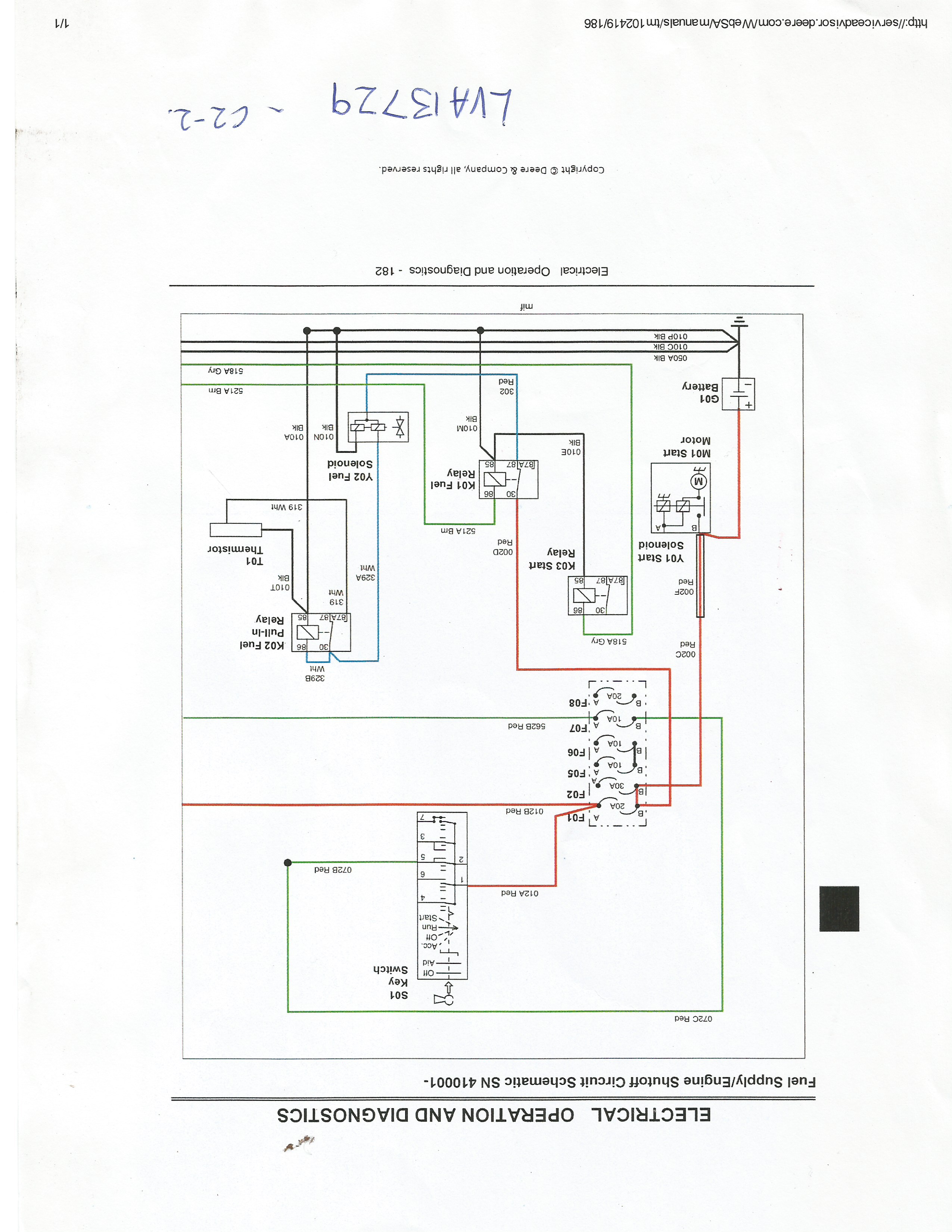

Well, you're in luck... I happen to have a 4105 Fuel Supply/Engine Shutoff Circuit Schematic from when I was trying to diagnose an intermittent fuel problem (yes, it was a biological growth in the tank).
There is a thermistor [T01] 'hanging' off the Fuel Pull-In Relay [K02].
The 4105 is a basic 'bare bones' model tractor so there really aren't any electronic components like a Control Module.

Thanks for the feedback. Yesterday I ran the tractor pretty hard for 4 plus hours bush hogging. When I shut it down it took almost 90 minutes before it would start. This game me some time to dig into the problem. I found no voltage is coming from the pull in relay to the fuel shutoff solenoid. I swapped relays and there was no change. I didn't see a thermistor (my original thought) and I don't think the 4105 has one. If you look at the electrical parts diagram for the 4105 it's not listed. On the electrical parts diagram it shows a timer LVA14556 that goes to that relay. Is anyone familiar with what this timer does? I read somewhere that it turns off the pull in relay after 3 seconds.

Sorry Mate, I don't have a parts diagram for my 4105. The electrical schematic that I posted was given to me by my local JD Dealership free of charge... indeed, they do that all the time. I simply ask for the relevant drawing/diagram/schematic at the Service/Parts department and they print it off for me. Very helpful and a mechanic has always been available to discuss any problem I've ever had whenever I've visited, in person, the dealership.
With regards to the thermistor... it's probably physically located somewhere else on the tractor; where, I don't know. An electrical schematic simply shows how things are connected to each other and the position of relays when operating.
The schematic has a hand-written "LVA13729" & "C2-2" at the bottom. It could be an alternate number for the timer... or not.

It is the thermistor,,
This "circuit" that holds the fuel solenoid "in the run position" is a careful balance of two electromagnets,
a powerful magnet, and a weaker one.
To simplify,, the thermistor MUST cool off and become more conductive for the two magnets to have enough power to pull the fuel injection pump lever into the "run" position.
Some replacement thermistors come with wires connected,, and what do they do,,??
They put MULTIPLE heavy layers of heat shrink on the soldered assembly,, and the thermistor.
Guess what!?? the heat shrink keeps the thermistor from cooling.
So, what you need, (it is what I needed) ,, is a new thermistor, and "wire tie" the thermistor in the harness in such a way that the thermistor is hanging out in free air.
I changed from the heat shrink covered thermistor to a properly installed free hanging thermistor.
My delay to restart went from 35/45 seconds,, down to 7 seconds.
I think that for my tractor, that is the best that it can get.
The thermistor will always need to cool,, some time WILL ALWAYS be required.
