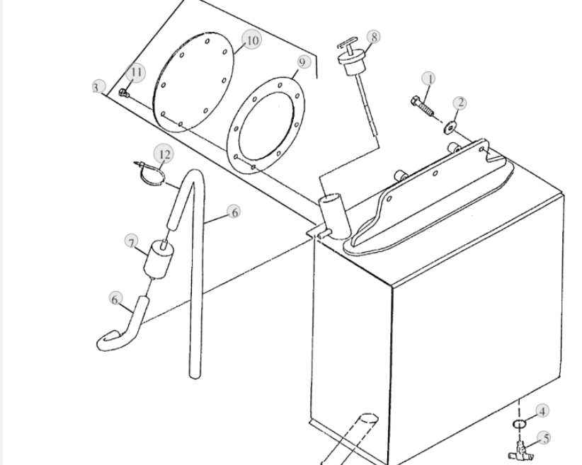

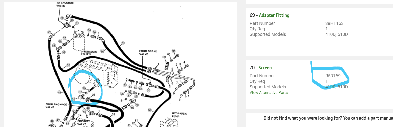

I would suggest to temporarily remove or consider replacing the air filter(key 7) if you haven't already performed this task or try to operate with hyd oil reservoir dipstick temporarily removed. If hyd screen(key 70) has not been checked/cleaned I highly advise to perform this task before proceeding any further.
