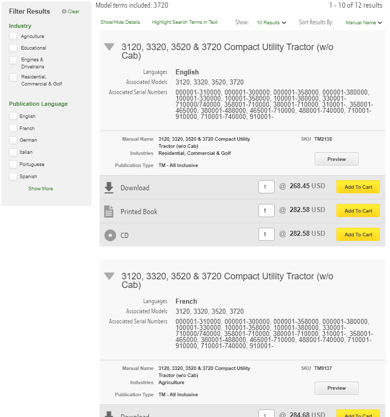

I am on the look out for a TM2138 technical manual for the 4 3720's we have, the 2005 version of the TM2138 is not correct, our tractors have a different electrical system (Fuse box and wiring looms), we have non cab models. \
In regards to the 5076 EN 4wd with cab, ANY manuals and information will be greatly appreciated. We have 4 of these we want to keep on spec, so we will greatly appreciate technical manuals for these too.

I just checked JD publications dept & only found 1 tech manual in English WO cab which is TM 2138

Indeed I have, our local and regional and even national dealers refused to sell us a copy.
The issue with online stuff is our currency strength, the TM2138 from the JD webpage is about a 10th of the cost of a second hand tractor.
/ JD 3720 + JD 5076 Technical manual #5
You mentioned your TM2138 is a 2005 version. I am sure if you order a new one today, it will have the information you need. The later versions of the tractor were different and the earlier manuals were printed before those changes were made. On the 5076en, there are a few different manuals needed. The diagnostic manual is a TM610019, the repair manual is TM609919 and the manual for the power reverser transmission is CTM900519 These are all part numbers for the english versions.
