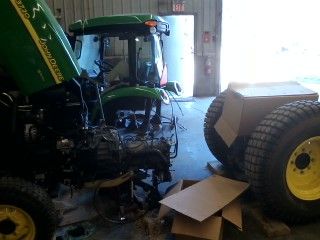

I don't mind one, two or three small issues with a new machine, but this is getting crazy. I think this tractor might have been built on a Friday.
1st fix was the rear window. It sat right down on the rear fenders it actually scraped paint. Dealer came out and had to drop the tank to fix problem. Took an hour or so, not a big deal I guess....
2nd fix was a leaky gasket. Steering pump leaked oil all over the engine. Dealer came out took everything apart installed new gasket took a couple hours. No big deal I guess...
3rd,4th and 5th fix delt with my front blower/tractor. Tractor blew two hyd. rams on the blower. The 3rd time out the dealer checked the tractors pressure. It spiked too high so he turned it down. Guess we'll see if it worked haven't used it too much (winter ended) so we'll see...
Now this. It just sucks... :(

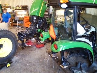

Maybe I'm missing something...why is it split?
If Roy is missing somthing, I'm missing it too. What's gone wrong with it now, and did the dealer do all the work at your shop, including splitting the tractor?
/ Jd 3720 broken into pieces
It doesn't go/stay in high range (c) right I get a grinding noise going down the road. This is mostly when I throttle down from high speeds..
Those are the photos I took today at their shop. Everything else I mentioned was done at my house.

Update:
Good news, the 3720 is back together. :D
From what I can tell everything seems to be right. I mowed for 2 1/2 hours today and it ran great. Took it down the road and it seems like a different tractor. No noise in high range, and it ran smooth!
No exactly sure what was replaced (they don't give you a print out) but the tech told me, shift fork, gears, sleeves springs, detent balls? They also recharged the a/c.
Anyway, I'm off the ledge for now. I hope this is the last of it.
