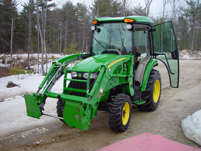

i have narrowed it down to these two tractors. i was wondering what people thought about either one. also your like and dislikes. i was primarly going to use it in my landscaping company and to do bush hog.

well, do you have a skid steer? need specifics for your uses, I use a 2305 in my landscaping business, and it's great for some things, but it won't lift a pallet of sod or block. I'd say if it'll fit the needs the 20 series is hands down better for your commercial application, but you may regret not going to a larger frame 4x20 tractor.
/ JD 3520 vs 3038E
dont do much sod work. i would use it more for moving mulch around and rocks with the bucket. and also for grading drive ways. i do have a skid steer but want to add a tractor to the fleet. i think im going for the 3520 with the HST transimition

Absouletly love my Cabbed 3520....but HATE the 300cx...to be clear...it works good...but its a little "Too Loose" for my tastes....
/ JD 3520 vs 3038E
so is the 300x loader better than the 300cx that was my other question thanks for the imput i think im going to buy the 3520 but imput on loader would be nice thanks in advance
/ JD 3520 vs 3038E #7
I was looking at the 3038 machine also. I ended up getting a 06 3720 for just a bit more.
If you are buying from scratch, get the 300cx loader. Mine has the 300x loader, and I wish it had a bit more umph to it. It is just a few hundred more for the bigger loader. Mine came with the 300x and there is nothing wrong with it; however if you are going to use it commercially, time is money and all that. The bigger loader might save you a few scoops here and there.

with the loaders for the 3520 which one is the better loader the 300x or the 300cx. thanks for the imput i had decidedon the 3520.
/ JD 3520 vs 3038E #13
most people go for the 300cx. i think it's a little more heavy duty, but don't quote me on that.
/ JD 3520 vs 3038E
#14
thanks that what i was thnking that it was a little heavy to but just wanted to make sure
/ JD 3520 vs 3038E #15
Definitely go for the 300cx!!!! More lift capacity, more lift height..... It is a great loader over the 300x..... It's a great loader, just wish it could be made totally tight at the masts. Me personally, I don't care about the quick park feature of it, my loader stays on all of the time... I just wish there was a way to lock it in so there is no slop at all at the loader masts, and I know that is the same thing that Spudland Dave was saying also... the loader works great, lifts great, plenty of strength, plenty of lift height, but has a little movement at the posts.....
but don't cheap out and get the 300x.... why they make this loader is beyond me.... they should only offer the 300cx on all 3000 Twenty series tractors, and give just a little discount. Most people who have the 300x will admit they wish they had the CX instead... for a few hundred dollars extra it is worth it..
/ JD 3520 vs 3038E #16
Oh... also I forgot to mention.... get the Heavy Duty Bucket too..... don't get the Standard Duty... it is not a reinforced bucket at all, and they will bend and warp on you very easily, so make sure you get the Heavy Duty bucket.... I myself use the 73" bucket with the reversible cutting edge option.... it is nice... 73" or 66" Heavy Duty is fine.. Don't get the 60" because it doesn't overlap the width of your tires enough...
