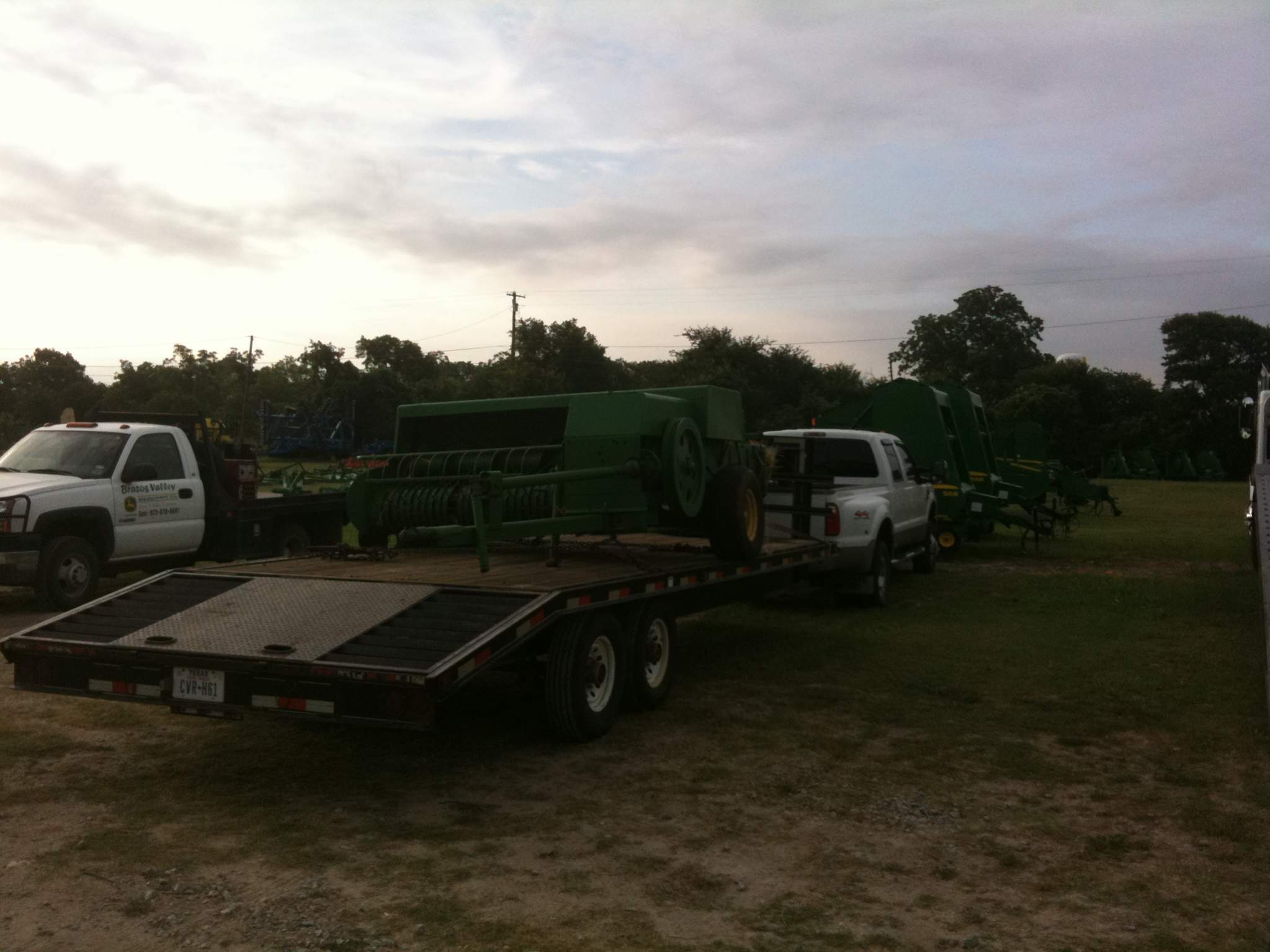

Here are some pics.

The pick up has all kinds of twine wrapped up in it.
The gauge wheel is there but had been patched.
The paint job is ugly. I don't think anybody would try to steal it. I kinda wish it has original paint. :)
