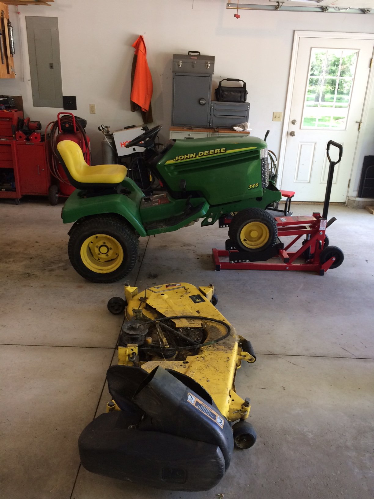

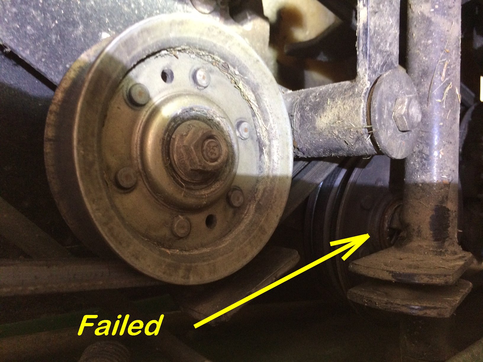

I brought it into the garage this morning, and was determined to find where it was coming from. I removed the deck, and crawled underneath to check what I could find. I took Zebra5 suggestion, thinkign it may have been the main drive belt idler pulley, and what I found was the front idler pulley was fine. I looked further and found the second pulleytowards the rear, and it was totally wasted, and the bolt was in there, but the center of the pulley was gone. I don't know how it stayed in place. I have to order the parts, or might just go to the dealer and get them. What a relief that it's not that Kawasaki 20HP engine.

Good pics..
Looks to be pulley p/n AM37249.
I like the looks of the mower jack/lift.
Will you work on that pulley from underneath? or remove the fender deck and footrest then work from above?

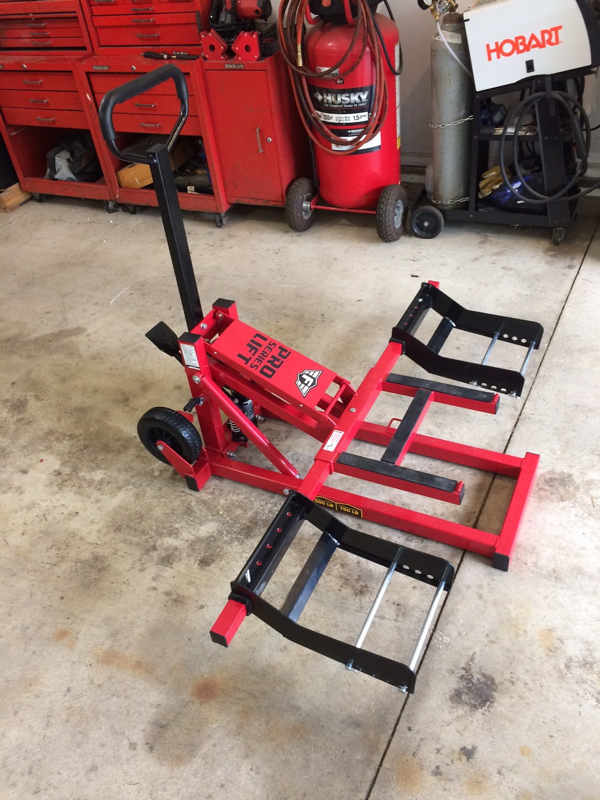

The part number I have is AM 118447. The Mower Jack is a 750# capacity Fischer, and it's at only about 1/2 the height it can lift. I finally bought the mower lift for working on my lawn tractors, and my new zero turn.....especially nice for the deck removals, AND, blade changes/sharpenings.

Going to look into that mower jack, as it looks handy compared to what I use now. tks

I have the same Fisher lift. Other than taking a lot of space when not used, I love it.
