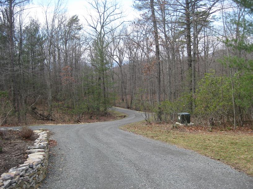

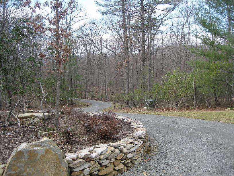

Well I've taken the plunge and purchased approximately 14 acres of mostly wooded land in Fauquier County, VA. Less than 1/2 acre is cleared and as such I've purchased an LD120 riding lawn mower to cut the grass. I've actually use a 21" push mower to cut it in a few hours but figured a riding mower would allow my wife to help :)

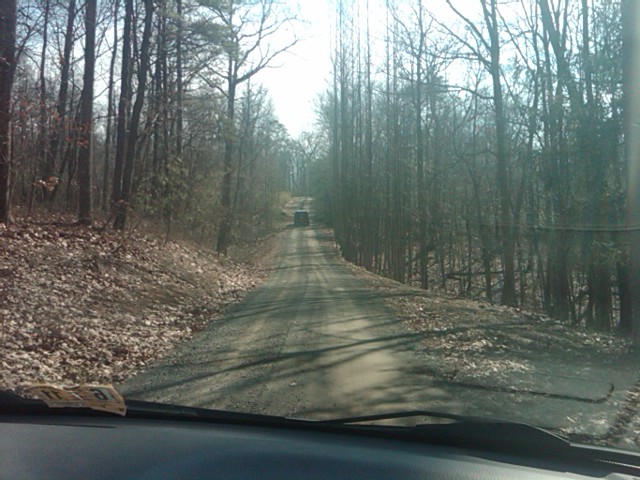

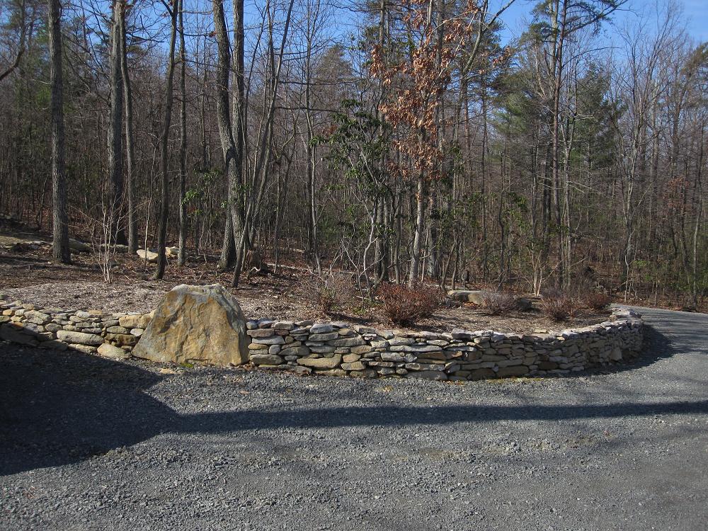

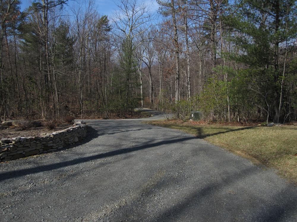

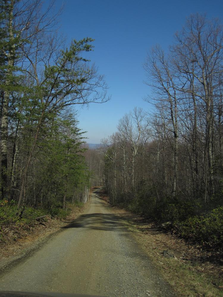

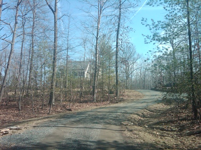

My next challenge is the driveway. It is gravel and over 1800 feet long with quite an incline. I've attached some photos of it appropriately labelled in hopes of given some perspective of what I am dealing with.
I bought the house from the builder who was previously maintaining the driveway and he recommended at least a 30hp tractor in order to handle the slope and be able to drag the driveway. I believe he was using a 10 year old Kubota 3010 to get the job done.
My primary tasks for the tractor would be caring for the gravel driveway, snow removal, and some general loader work such as hauling cut firewood, and leveling ground for a garden.
The JD 3320 is my top contender at this point although I've seen some recent posts related to high center of gravity. Although I don't anticipate doing much work across the slope of my property, the driveway is quite steep and plowing snow is one of the main tasks for this tractor.
I'd welcome any advice on:
1. Whether I'm crazy to consider this tractor for the tasks I've described above.
2. Should I consider the cab? I realize it is a bit more in price but heck you only live once, right?
3. For dealing with the driveway I've heard no less than ten conflicting opinions. Use a box blade, use a york rake, get a land plane. Front blade is best. Help!
4. I stopped in my local JD dealer and had him give me a quote for the stock 3320 with the 300CX loader. I haven't tried to negotiate yet, just wanted to see what the starting price would be. He quoted me 25K. Seems high to me but again - I'm new. Thoughts?
Thanks in advance for all help.

I have a 3120 and love it. I think a 3320 would be good for you. I like the bx blade for dirt and gravel work.
/ JD 3320 - Overkill? #3
3320 sounds perfect. bigger or smaller would work too but i think you are right on track with the 3320.
i've got one and live on 14 mainly wooded acres. use it to mow the yard with a 72d belly mower, put a 7 foot 3 point blower on for snow clearing duties and i use my box blade mostly on my driveway with the occasional drag with a normal 3 point blade.
biggest difference of a 3320 vs a 2000 series for you will be loader capacity and snow blowing ability. I move a lot of downed trees and with a markham grapple on the front i still have enough capacity to grab a lot of branches. i sometimes wish for more loader capacity but make due just fine. with a 2000 series i would probably not be as happy with it's loader abilities.
my 3320 with hydrostat will move my 7 foot lorenz snowblower thru snow amazingly quick. the blower weighs over 900lbs and a smaller tractor would not work too great. i like a 7 footer because i can make 1 quick pass and get the vehicles out even thru a 10 foot drift.

From your description, but not familiar with VA, don't think I'd go any smaller than 3x20. First few minutes the 3x20 may "feel tippy" but set your wheels to wide and with a bit of seat time you'll feel very safe. I have an area where I quite often mow on the side slope and I can tell you my 3320 is less tippy in exactly the same place than my riding tractor.
I had an O/S 3320 and bought a Cab 3320. I'm looking forward to cool in summer, no bugs, dust and heat in the winter. Low trees are not really a factor for me. As for snow / gravel, as you have found, if you ask 10 people you'll get 11 opinions. Better solutions often involve spending more money.
Ask yourself what's the largest load you may want to lift and determine if you want to size the tractor for that. I was very tempted to go with 4x20 to get the extra FL capacity.

I have a very similar 1/2 mile gravel driveway. My L3240 and grader scraper did a very good job of filling the pot holes and building the crown back up. I like the land pride brand scraper because it has the scarifiers that I can lower to scrape through really tough pot holes so they don't come back so easy.
It took me a total of about 6 hours to scrape my road from end to end making numerous passes to build the crown back up. Mind you, nobody had done a single thing to maintain it in about 7 years when the neighbors got together to lay down some gravel so it was in very bad shape. Yours looks much better so whatever you decide, you'll probably have an easier time.

As far as what to use on the drive, why not ask the builder (who had maintained the drive) what he used? The tractor he used is quite comparable to the 3320.
As far as the cab...not a good idea if you intend to work in the unimproved acreage. That, and the cab will raise the tractor's center of gravity (high CofG was one of your concerns...why add to it?)
Fauquier County, VA has a pretty moderate climate...the area does get snow, but blizzards (>10") are the exception not the norm. Snows are normally in the 4"-8" range. A front blade might be a better choice then a blower. But you will want chains.
Speaking of chains, which tires do you want for the tractor? I'd pick R-4s...but you might need to add spacers (recent posts concerning the 3x20 series indicate there is not much gain in swapping the R-4s side to side...I don't know that as a fact...something to ask your dealer).

I think you are right to look at the 3x20 series, it's the right size for what you want. However, I would bump you up one in the series and get the 3520 instead of the 3320. It's going to give you a little more in power to go UP the driveway with a load whether it be a trailer, pulling a car out of the mud, firewood, or a snowblower.
I love my cabs. That said, if you are getting on and off frequently they are a pain. Cabs are great if you will be in the seat for extended periods of time, and for snowblowing in the winter. In the forest, they do get scratched up, but then, the branches won't hit you. The ROPS will catch a lot of branches too though.
If you feel that the tractor is too narrow on slopes, you can use the Prowler skid steer 8 lug wheel spacers (available on eBay) to space out the rear wheels 4" per side. It's not that the tractor has a hight CG so much as you sit up very high on it.

I'm probably late to the OP questions...but: From the looks of your land, its pretty flat area, so I don't see "tippyness" as an issue for most of your work. When working driveways you always have to watch out near the shoulders with any tractor.
I think the 3320 is a pretty stable tractor but I would load the rear tires for extra traction and for loader work and better stability. If after owning you wanted more stability (width) you could always add some 3" spacers to the rear wheels - which may also prove to be of value with chains. Remember tho that more tire width requires more bucket width and more snow blade / blower width. Like Roy sez: tanstaafl ;)
I too would consider a front mounted blade and possibly a rear snow blower for the big snow (if you get that kind of snow). I can see having a cab for winter snow work depending on where you live and how often you get snow....but I dont do snow on my land. (I like an open station tractor for my needs around timber). If you want to take care of snow before going off to work or just like being cozy in the cold / warm.....I would consider a cab.
With your driveway I don't think the 3320 is overkill. Buy enough tractor, you will have it a long time.
