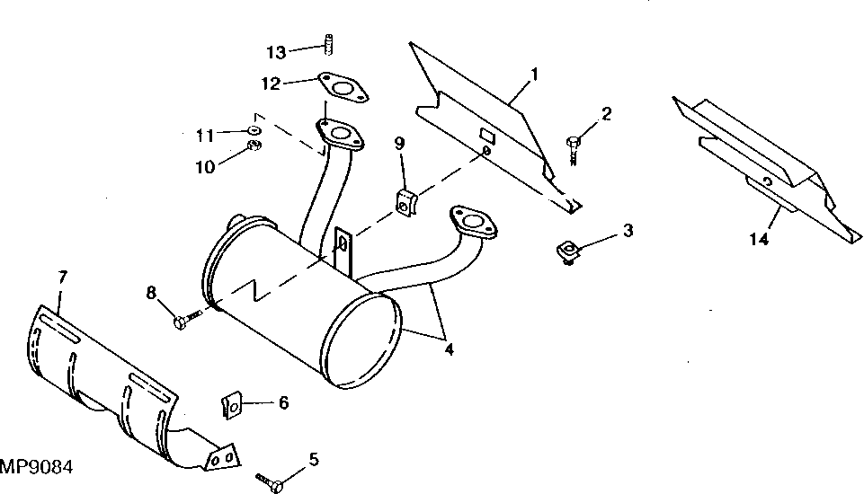

That's a good point I forgot about. Make sure your tractor has the metal heat shield that covers the muffler. The muffler is very close to the carb on that engine.

The parts list show a spark arrestor kit, but I have never seen one installed. If so it would be inside the outlet of the muffler.
They are hard to get out unless they rust and deteriorate and blow themselves out.
It's just a real cheesy little baffle/catalytic converter that supposedly reduces noise etc.
It seems to me that this would make it hotter. A manual will tell you to take these out and clean them.
The only place I have even seen one is on a 4-wheeler or a motorcycle.
Can you stick you finger easily up into the end?
A HOLE in the muffler could cause excessive heat depending on where it's at, but you normally get abnormal noise with a hole.
They can possibly be welded by a muffler shop.
IF you really think this is the problem, order some new gaskets and take it off to inspect it. (Quan 2, Item 12)
