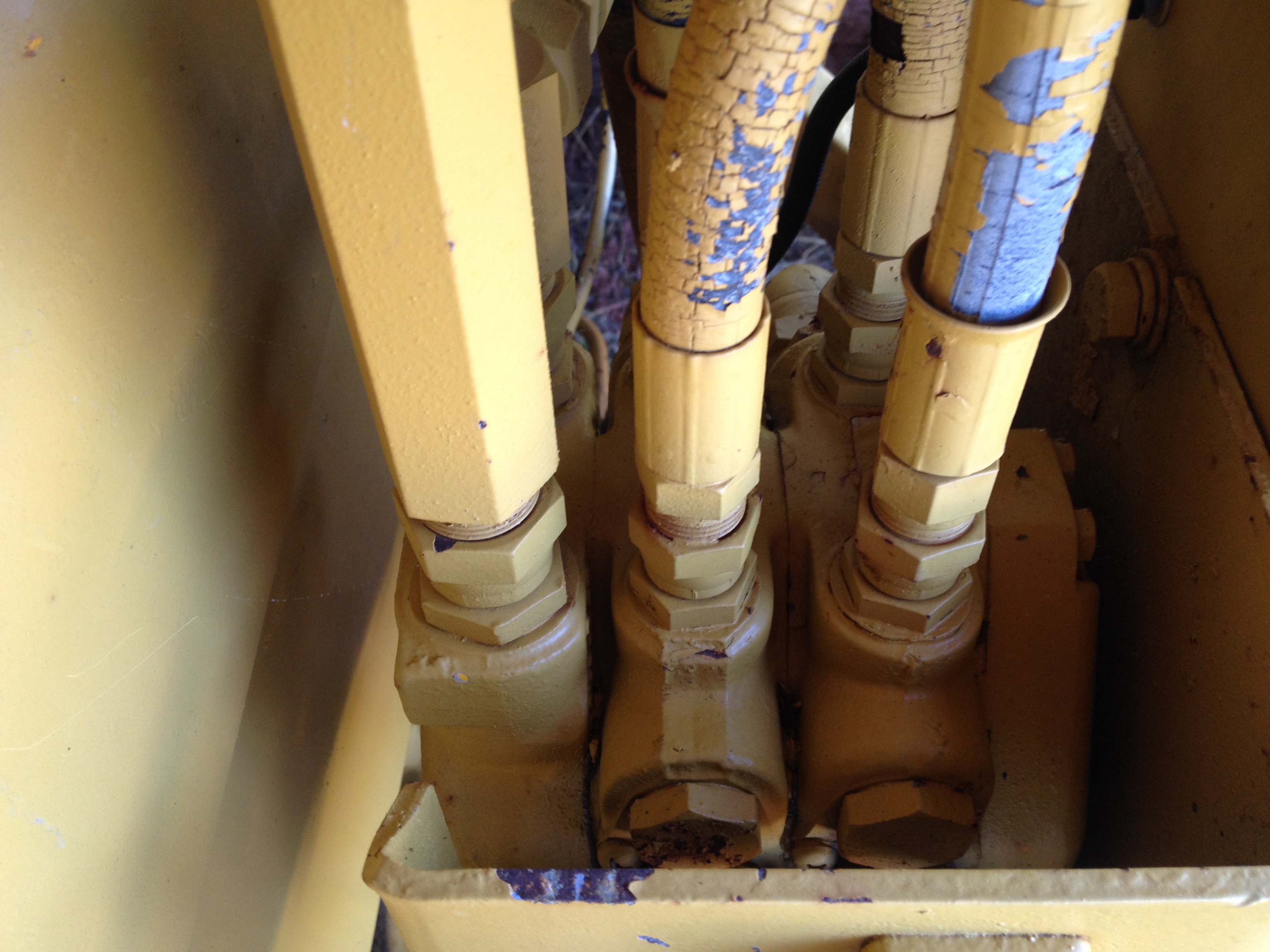

I have recently purchased a 1973 JD 300B loader without a backhoe and It has the 3 point lift, but when I have the 3 point lift raised and raise the loader bucket the 3 point lift drops a little. Everything runs fine until the oil heats up and then the loader gets slow on raising up no matter what the RPM's are. This weekend I will be checking the transmission screen, changing the two filters under the right foot board and putting in new fluid. I have ordered a hydraulic pressure test kit but would like to know where to start for the pressure test.

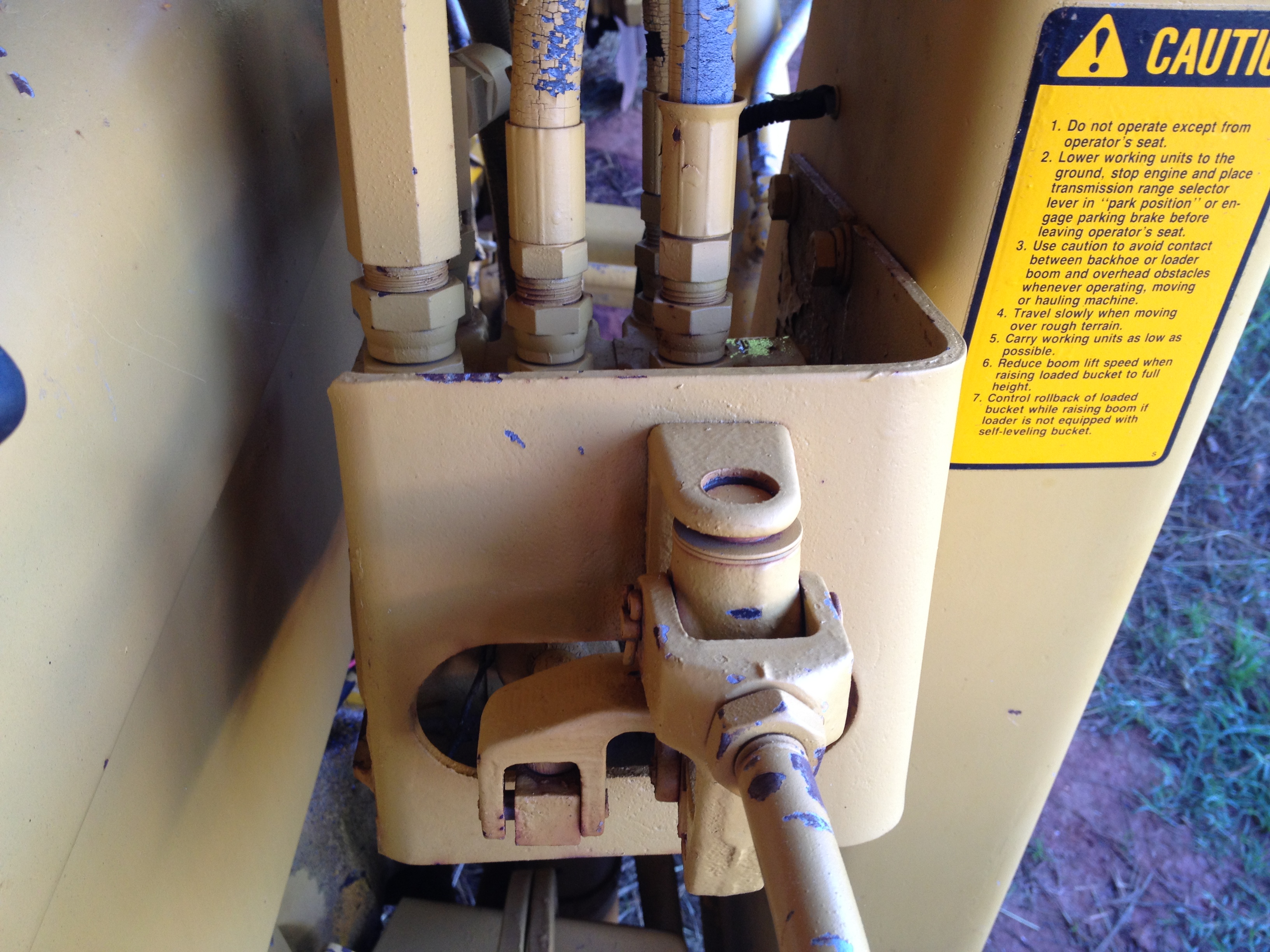

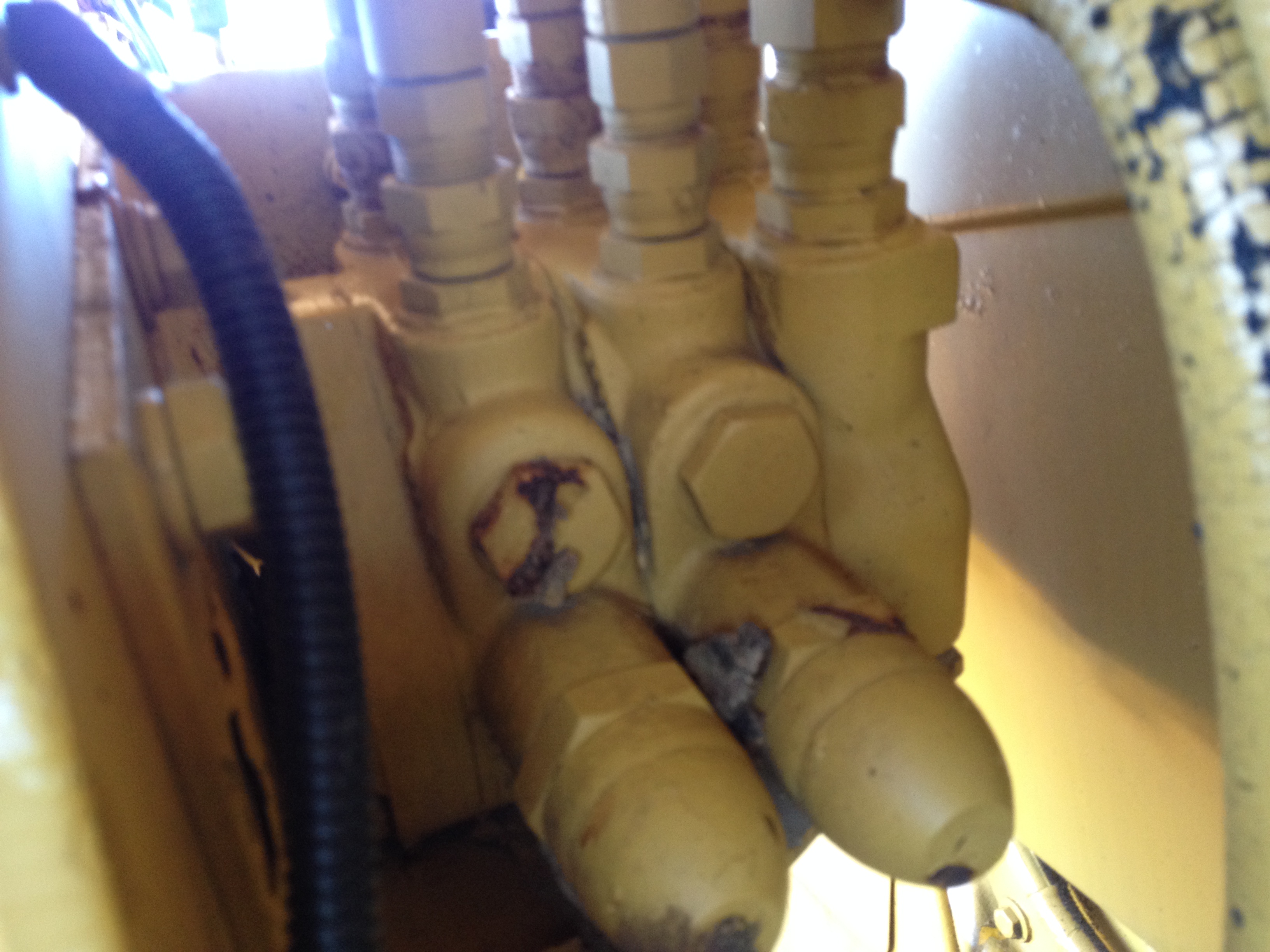

Trans pressure should be 155-165 psi,main hyd 2250 psi. With machine at operating temp with engine running,3 pt raised look in hyd filler hole behind seat for spraying oil which indicates leaking 3 pt control valve seals. Can you post a close up photo of loader control valve? Do you understand that your tractor has closed-center hyd system?

Tx Jim I just looked in the filler hole with tractor running and 3 point raised and yes there was oil coming down from the top of the housing. It wasn't a pressure spray but it was a steady dripping of oil.
Here are some pictures of the loader control valve IMG_1710.JPGIMG_1711.JPGIMG_1714.JPGIMG_1716.JPG
/ JD 300B Hydraulic pressure problems #7

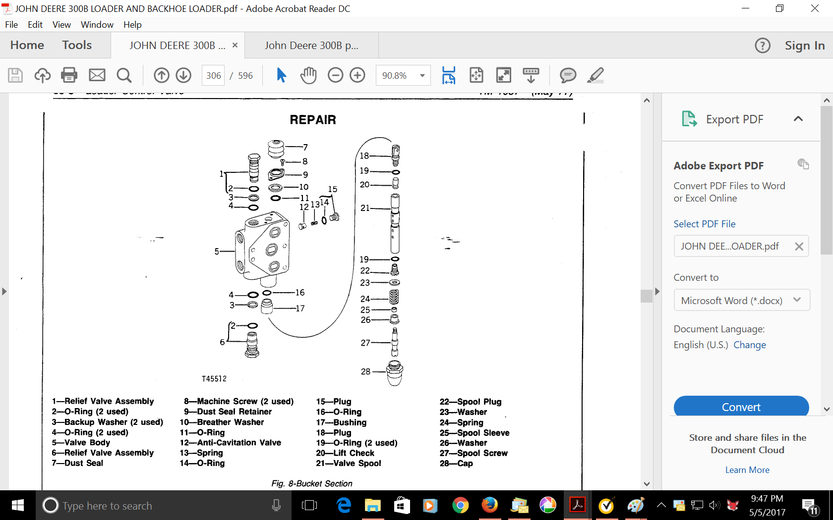

On 3 pt lowering before raising when loader control lever is activated I suspect leaking 3 pt control valves &/or piston is the cause. i suggest to remove from tractor FEL control valve "return hose" then plug orifice on tractor,aim open return hose into hyd filler hole or 5 gallon bucket,start engine with FEL control lever in neutral & no oil should exit return hose. If oil exits return hose then I suggest to check for leaking internal seals on plug(key 19).

On 3 pt lowering before raising when loader control lever is activated I suspect leaking 3 pt control valves &/or piston is the cause. I also suggest to check for leaking internal seals on plug(key 19).
What part is this picture so I can look it up in my parts book?
#9
I see now this is the loader control valve thanks Tx Jim I recieved my high pressure test kit yesterday and will be getting into this over the weekend.

I checked the Transmission pump and got 130psi when I would raise or lower the 3 point it would drop to 30 psi and then build back up to 130. it would do this when i raised or lowered the FEL also. as soon as the tractor was cut off it dropped to 0 and the 3 point dropped to the ground. I looked into the hyd fill hole again after the tractor heated up good and it is spraying more than I thought. Going to get parts to rebuild the rockshaft cylinder and see what that does.

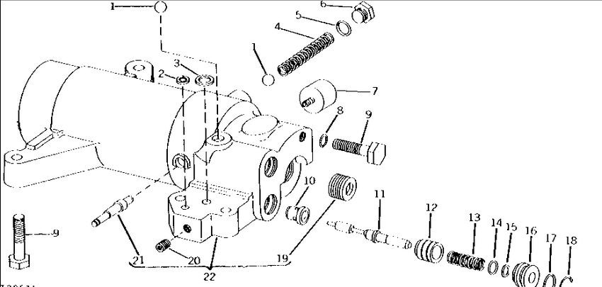

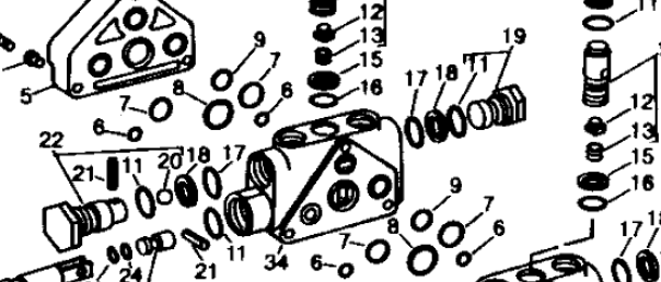

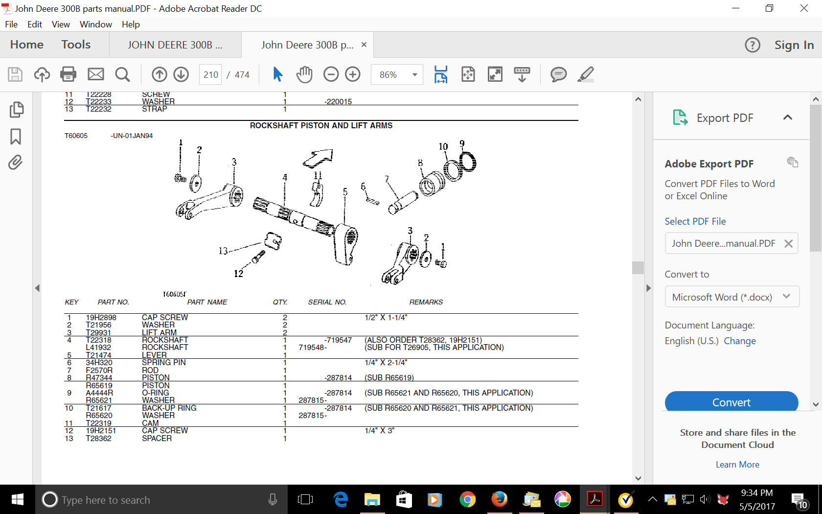

#16
Check trans pump pressure with reverser in both fwd & rev. I think trans pump pressure can be shimmed up a little. I'll suggest to R&R RS piston seal & control valve seals. You'll need to replace the quad ring that sits in a recess on RH frt topside of trans case. T17882 RING,SEALING ADD 1.56 USD
Tx Jim are the seals on here?
/ JD 300B Hydraulic pressure problems #17
Along with replacing keys 9 & 10 in your 2nd photo you should replace o-rings & backup washers on this photo. The piston housing is located under rockshaft housing.
Ok I'll get all the ones mentioned and replace them,
I did the pressure test while putting the reverser in both for and rev with no pressure drop a steady 125 psi. So I checked pressure when moving the rockshaft lift, Pressure would be 125 and when I pulled the lever to raise it would drop to 50 psi until it raised then back to 125 psi.
It would be 125 psi steady and I could raise or lower the FEL and the pressure drops to 50 PSI.

OK is there anything on the FEL control valve that needs replacing?
/ JD 300B Hydraulic pressure problems #20
I would recommend checking o-ring/back up washer(keys 17 & 18) on FEL control valve which I think has to do with keeping valve in closed-center mode.
