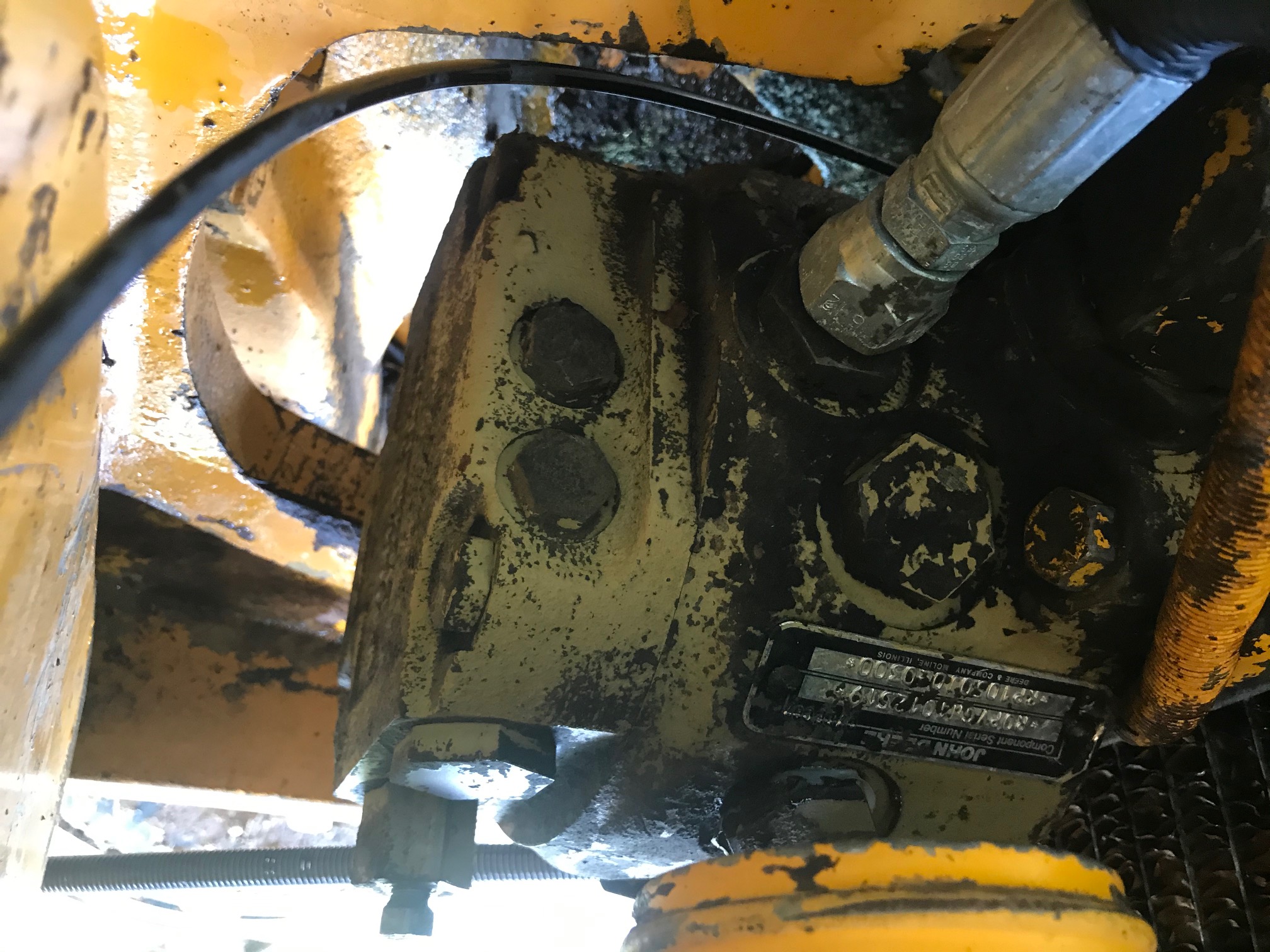

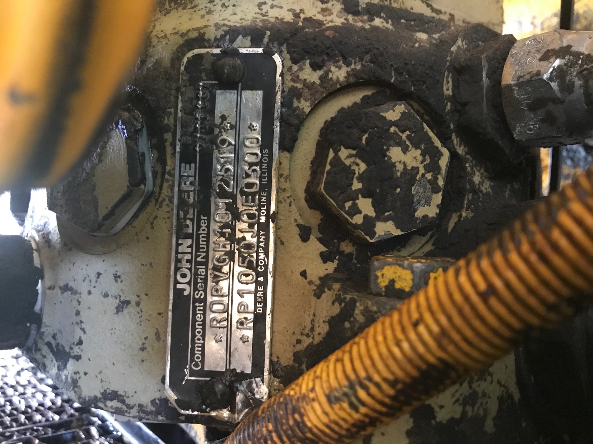

What is your tractor's serial #? Does hyd pump have a serial # plate?
/ Jd 300b hard to start when hot
Tractor serial number is 300BD 281699T
Back hoe serial number is 9250 A 038713T
I saw the pump serial number plate this weekend, I will grab a picture of it Friday. Thank you for your help.

Well I went down Friday with the intention of taking a picture of the pump serial number but I forgot. I moved some trail cameras around. Knocked out the last 3 pins and got them to take grease, now everything will take grease on the backhoe. When I pulled up back at home I remembered why I went down there. I値l try to do a better job remembering this weekend
I made it down today here are the pictures
54065FDD-2897-4369-9662-4D27EB2E22D4.jpeg559FA8FF-DB18-41CA-A84D-FA57F951DBBA.jpegB5E3B269-9685-4EEB-8765-04088EA57A95.jpeg
#11

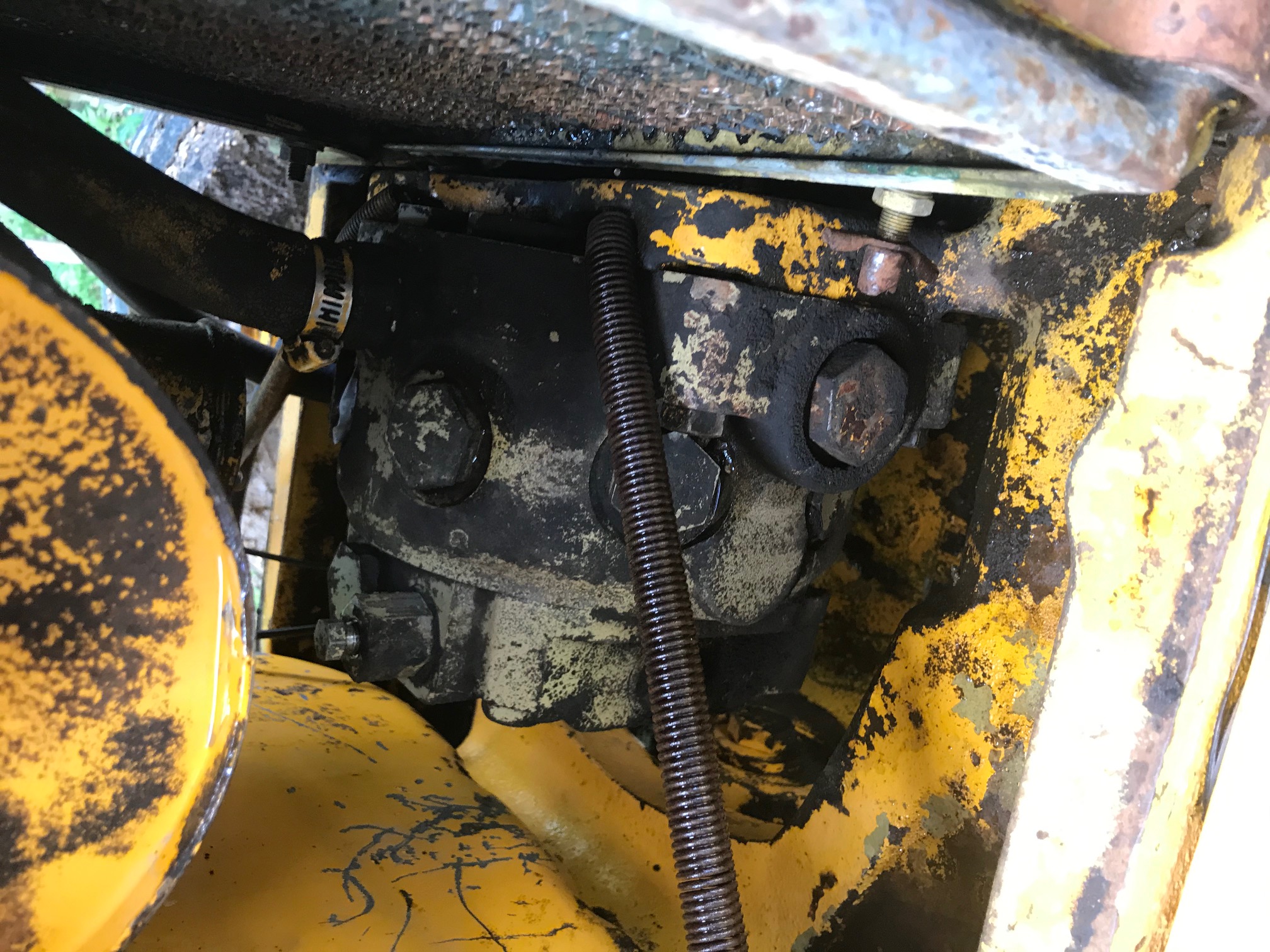

Is the red arrow where the solenoid screws in? 80FD487A-8165-46B6-A7EE-AE0A2C27B45E.jpeg
/ Jd 300b hard to start when hot #12
Your tractors hyd pump appears to be the non-serialized type which would require a more expensive electric controlled valve(RE40463 @ $871.66). From viewing your photo it appears that your tractor's hyd pump has a manually operated destroking screw(see photo below)
Thank you for your help. I didn't mind spending the $250 for the solenoid but for the $850 and as little as the backhoe is used I think i'll give the screw a try. I think i read somewhere the process is to screw down until resistance is felt then a couple turns to get it started. after started back it back out. is this correct?
/ Jd 300b hard to start when hot #14
Yes that's correct.
#15
Yes that's correct.
Thanks Jim, I believe this fixed my issue, I went down there Friday and it was slow to start. I used a 1/2 wrench to tighten it down. After that it spun over fast and cranked right up. Once I backed the bolt back out the hydraulics came back. Now I just need to find a good spot to keep a 1/2 wrench stored on the backhoe.
