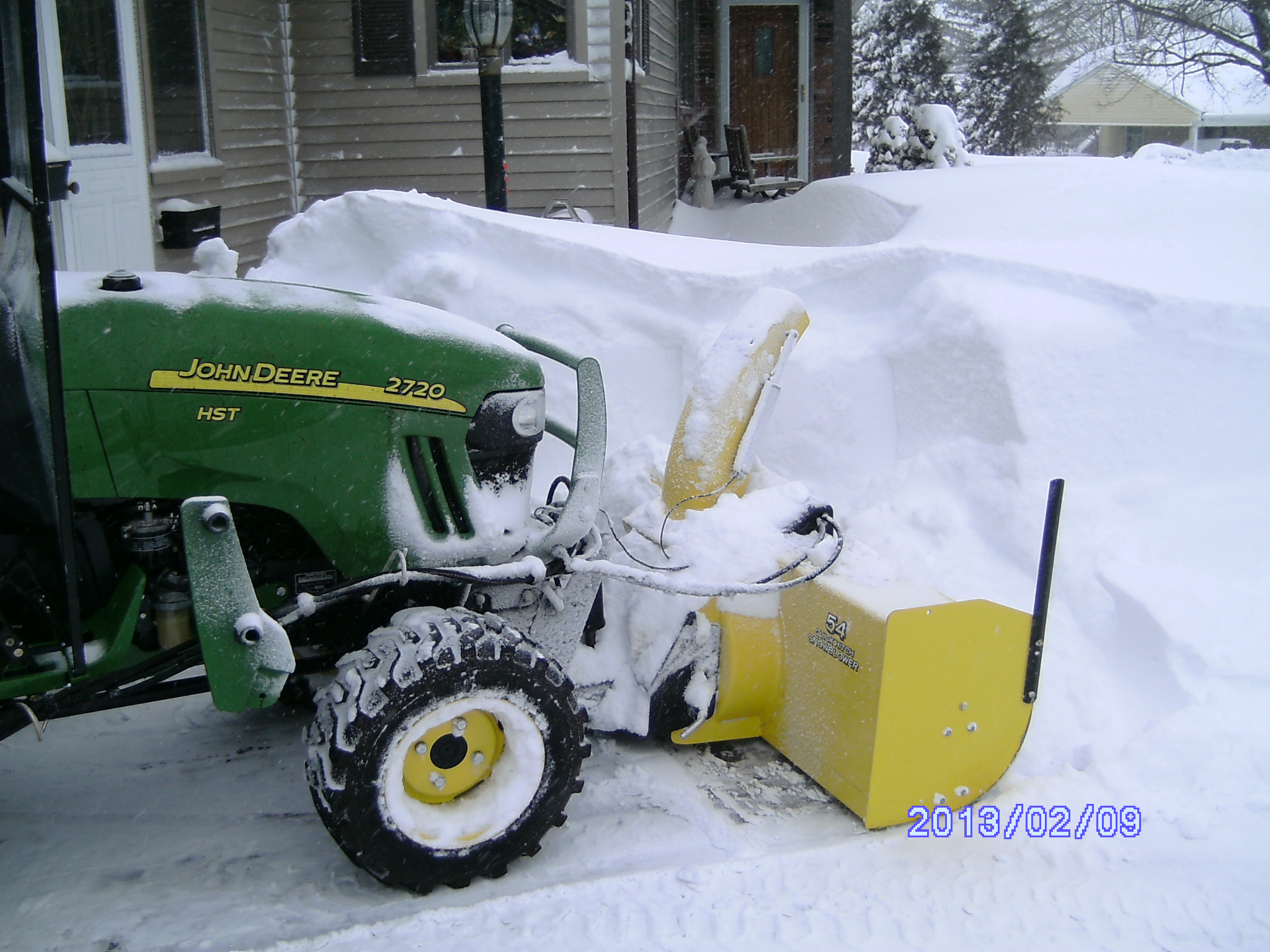

I have a 2011 2720 JD with a 54 Snow Blower. This weekend Connecticut received a big snow storm. I always check fluids very closely before heading out into such a large storm. Some of the snow drifts I had to move were over 7 feet tall. JD really should increase the height of this front mounted blower.
Anyway, I always check Transmission/Hydraulic fluid by both the site glass and the dip stick. When I stated out the site glass was almost to the top (just a small bubble) and the dip stick showed about 1/8 inch below the FULL mark.
8 hours of Run time later, and 4 hours of cooling off, parked in the same spot in the garage the site glass is now in the middle and the dip stick shows about 3/8 inch below the FULL mark. Based on å…¸op off experience I estimate about ï½¼ of a quart disappeared during that 8 hours of run time.
I looked over the entire tractor and could not find any evidence of a fluid leak. I still have the break oil in the transmission, I just approaching 50 hours and will be doing the change in the spring.
However I have never heard of a machine or owned a machine that ç*¥sed Transmission oil.
Anyone have any ideas where the oil went?
I second thing I noticed when blowing snow hard (chute going full bore, I wish the chute was bigger) occasionally I smell something getting hot, almost a burning smell, I back off for a little bit and the smell disappears. I first noticed this smell with the tiller last fall and I thought it was the clutch on the tiller. Now I am think it is something on the tractor.
Has anybody else had this experience?

Find a scenario to measure the oil in the glass without any different variables and you will then know if you have a leak.
I check mine only when cold before start up and it is always in the same spot with a small bubble at the top. Check it again when stone cold....
/ JD 2720 Hydralic Fluid & Snow Blower #3
I have a 2720 & 54" blower also. Was your blower resting on the floor both times? If your blower was raised and the chute turned all the way it could result in some extra consumption by the two front-mounted hydraulic cylinders?
My sight glass is all over the place. One time it's full the next empty. It seems you must have the tractor perfectly level and leave it sit a long time for an accurate measurement. Which for your example, 4 hours would seem plenty.

Agreed, you don't have to worry about it. Your oil is not going no where, unless you have a leak, and this, you would notice it pretty quickly. As jgayman have said, sometime it will be either top, middle or bottom of the site glass.
