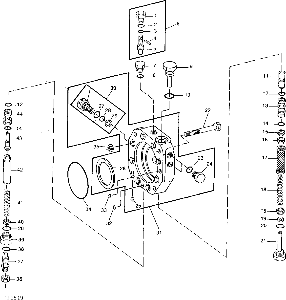

With 3pt raised,engine running look inside hyd filler hole at the rear of tractor for spraying oil. This is a very common hyd leak problem on JD utility tractors. The stroke control valve(parts keys 42,43&44) that controls pressure is in the head of the frt pump. Stand-by should be in the 2250-2350 psi range. The valve on RH side back by hyd filter is the pressure control valve that gives steering priority hyd pressure. If tractor has ind pto(control lever between gearshift levers) there's a trans test port under sheet metal cover the gearshift lever protrude through.

In the drawing Jim posted there is also a filter screen (#17) that I would check too.
/ JD 2440 hydraulic squeal #6
Steve
You're correct and thanks. That filter gets forgotten about.

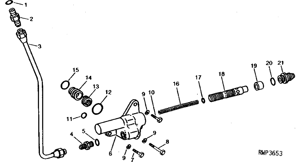

Today I drained the oil, it was clean and no burn smell. Main filter was clean, no debris visible. Screen was about half covered with bits of rubber , only one metal thread like debris. After reading the above info I wanted to pull the filter in the front pump but it was so covered I had to stop and pressure wash which led to fixing the psi washer first. Got it cleaned and will check that filter tomorrow. I wanted to ask about the steering priority flow valve. Can it be taken apart and inspected after removal. I would do front valve/ filter and priority flow valve before reinstalling filters and fluid. Then check pressure and 3pt leak as per above. And yes the tractor does have independent PTO. Thanks for the help so far.
/ JD 2440 hydraulic squeal #8
Yes the pressure control valve can come apart. You will want to get orings #11, 12, 13, 15, and 20 to reassemble. RWP3653________UN01JAN94.gif

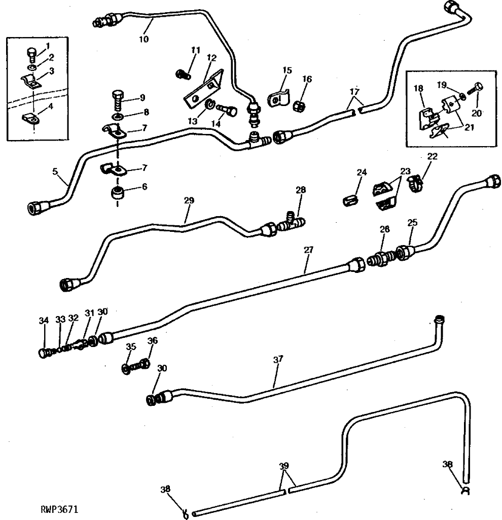

First you need to lower stand-by pressure to 2350-2400 psi maximum. Are the hyd line clamps(parts keys #18 & 21) in place and snug?? I've seen tractors with these missing and lines rattle/vibrate. What type valve controls loader???

The tubes supplying oil to the hyd pto have been known to leaking robbing supply oil from trans pump to main pump. For diagnostics remove and cap power steering line(parts key #10) and operate hyd's and see if noise is still present.
