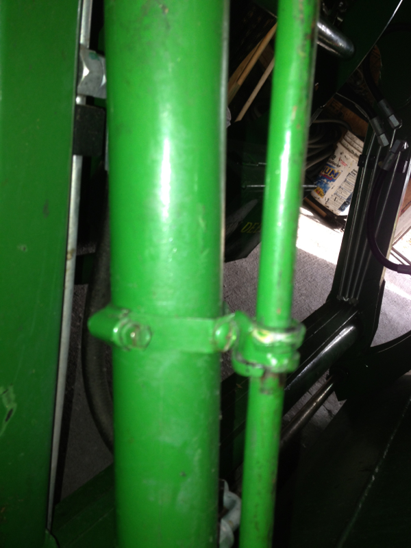

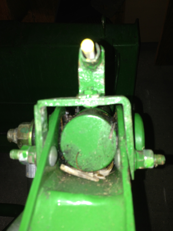

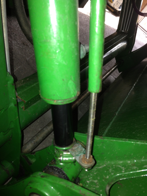

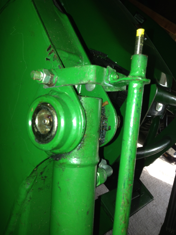

I made the Bucket leveler shortly after purchasing my 2010/2305. Normally not needed in my opinion, but I was moving a lot of dirt ( 20 ton ) on my pond dam and it came in handy. While turning and adjusting level, I could pull up to the pile and drop- level every time. I have attached a few pics - very simply done.
I used aluminum initially for the level rod but it caught on vines in brush and broke to easy. Now it's steel all thread. A hose clamp holds the bottom "L" bracket with al thread mounted between jam nuts, The top part was tricky- bent channel bracket then drilled hole in "L" bracket and brazed onto channel. Steel pipe thru top "l" bracket is also welded. The steel pipe is supported in the center by a hose clamp and Adel clamp. Thought some might like an idea to play with. Regards, Bill V

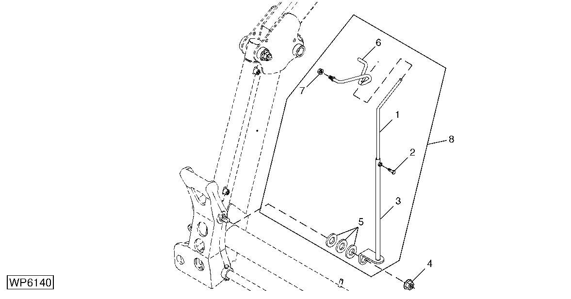

From JD parts my friend (for the 200cx loader), do yourself a favor and learn how to use it ;) There is a link in my signature to help if you need it. That sucks that your dealer had no clue as well.
BUCKET LEVEL INDICATOR
Cart key PART NO. PART NAME QTY SERIAL NO. 200X 200CX REMARKS
1 Rod 1 X X (ORDER BW15476)
2 19M7162 Cap Screw 1 X X M8 X 16
3 Tube 1 X X (ORDER BW15476)
4 14M7291 Flange Nut 1 X X M16
5 24M3527 Washer 3 X X 17 X 24 X 2 mm
6 Bracket 1 X X (ORDER BW15476)
7 14M7296 Flange Nut 1 X X M10
8 BW15476 Bucket Level Indicator 1 X X COMPLETE GOODS/SHIP BUNDLE
