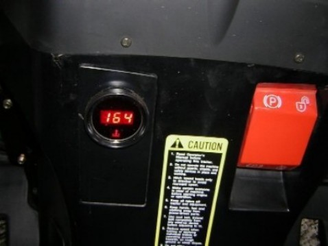

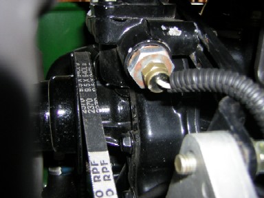

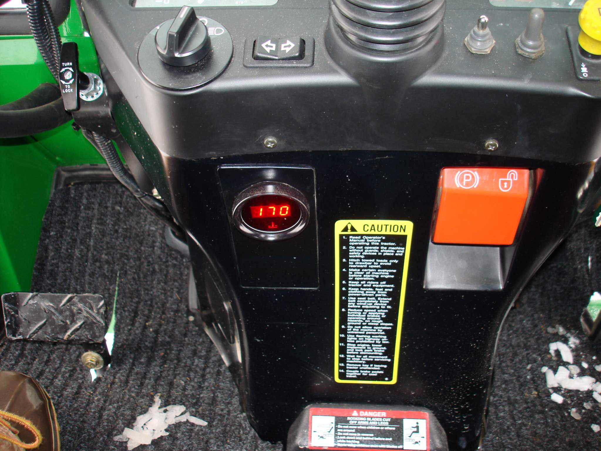

SnowDay 071.jpgSend.jpgTemp.jpgI installed a digital gauge on mine the year after I bought the tractor. I drilled and tapped the plug in the thermostat housing above the alternator for the sensor. If I'm working it hard and the coolant temp is 180° or higher I let it cool back down to 160° before I shut it off. Only takes a minute or 2.
