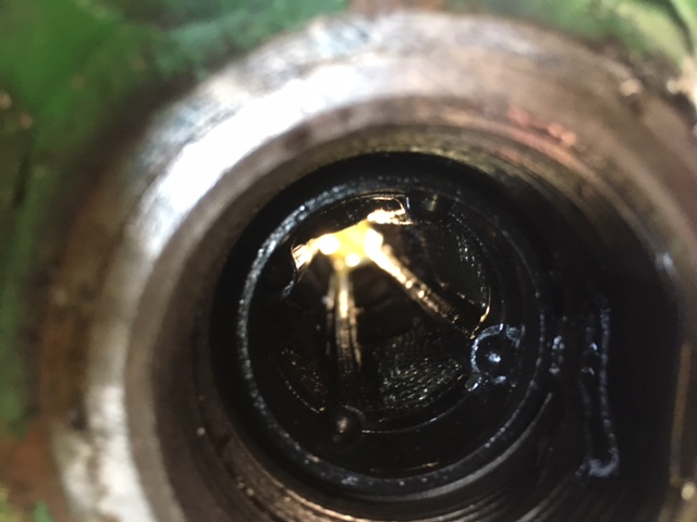

Rear lift and steering go out after about 10 minutes of use. When machine and oil get up to operating temp.
Checked the pick up screen, found none- can see right through. BTW, used a cold chisel to start plugs open. Used chanel locks to tighten back up.
First question-how bad is it to leave this out.
BTW, I opened this and also removed filter canister without draining oil by hooking a vacuum (full suction) to filler hole.
So, I have ordered a new front pump. Should be here tomorrow.
In the meantime, (after reading anothers forum post) I will check the valve that seems easy enough to get to on top of the pump for debri.
Does anyone have any thoughts on any of this or about the removal of items to get to the front pump?
Thanks!

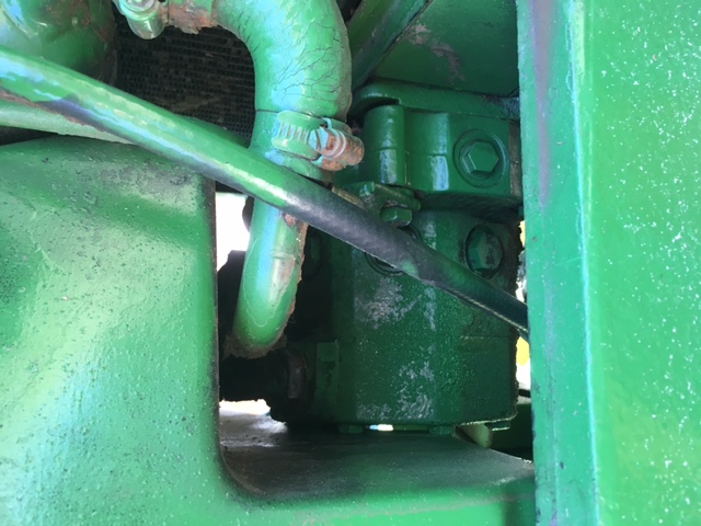

I bought a JD this time because I thought they would be easier to work on than the MF that I have had in the past. IE pump outside of case. But now Im understanding I may have to remove rockshaft cover or crack the case in this one too :( (to get to an inside pump?)
What is a way of troubleshooting? I do see the resouvoir mounted on top of the pump. is there something I can tell from that?
Again, Everything works just fine for about 10 minutes and then the rear lift and the power steering rapidly lose function. Sometines, if I let it idle, the lift might move up a bit. Other times, if I rev it up, the lift might move up a bit.

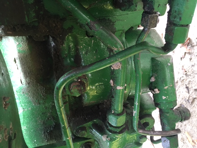

There are two steel iles on right side of tractor that have hose connectors. Im guessing these are low pressure hoses. Does one of them provide the front pump? Which one?
Couldnt I crack the connection to see if there is 5 GPM there, that way?

Should be a low pressure line from transmission to front pump inlet. Then the same low pressure line continues up to the cooler and sometimes a reservoir tank. When Transmission supply exceeds front pump demand the extra oil flows theough the cooler, to the tank and then back to the transmission case . The 3rd line is 2250psi down the right side of the tractor to the PS, priority valve, rockshaft supply and SCV supply.
The free parts book on the JD web site shows the location of the valves. The service manual shows the test ports and what the pressure should be and when.
