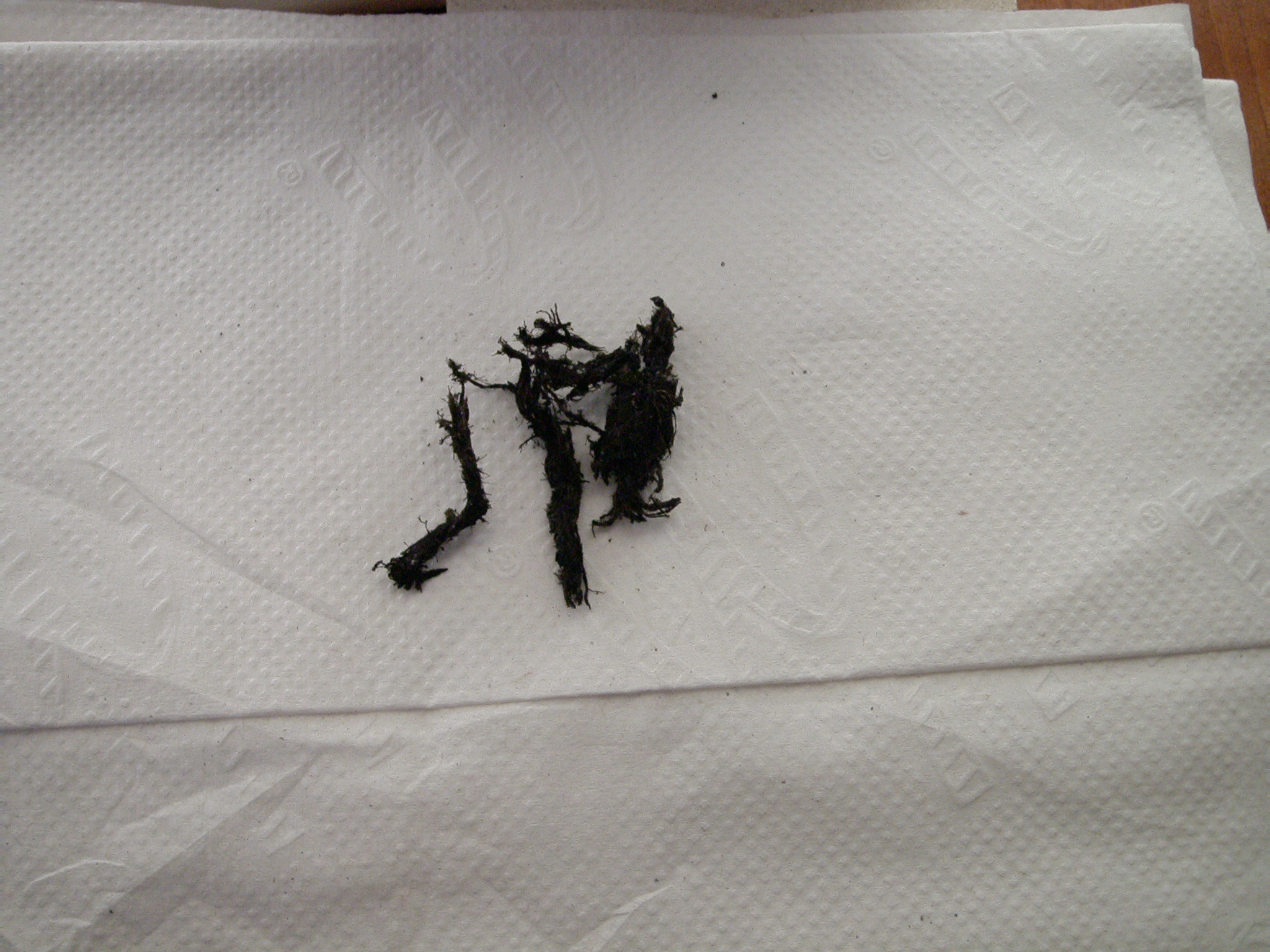

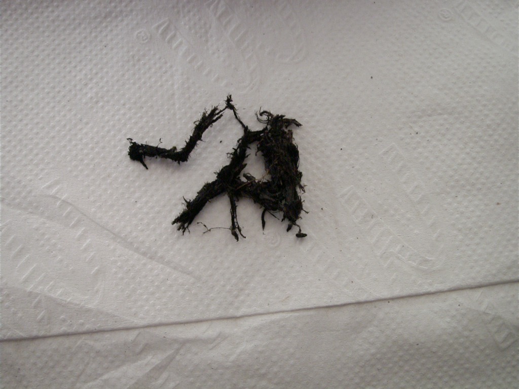

I took the little access plate that allows you to grease the throw-out bearing off today and started it up and this coming flying out.

It appears the clutch disk has disintegrated. When you last used it and it quit, were you drifting any with clutch pushed in? Situations like pushing up a hill in a low forward gear and then pushing in the clutch and allowing it to drift back down the hill in reverse while transmission is in forward can cause damage such as this.
/ JD 2040 clutch problems
#11
Yes I was,I had it in low forward and the gearshift in 3 and was pushing in the clutch and letting it roll backwards and then putting the blade down and pulling back up the hill again.

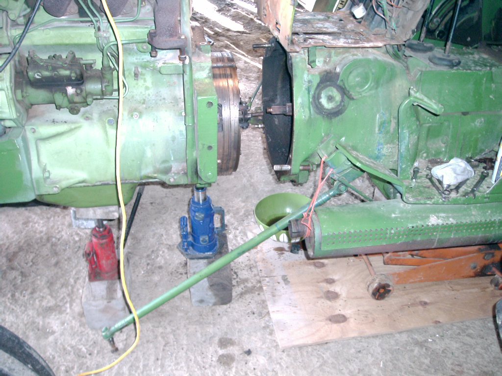

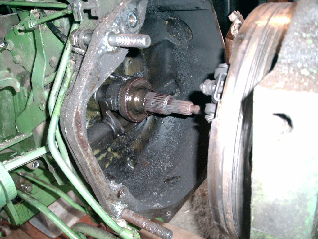

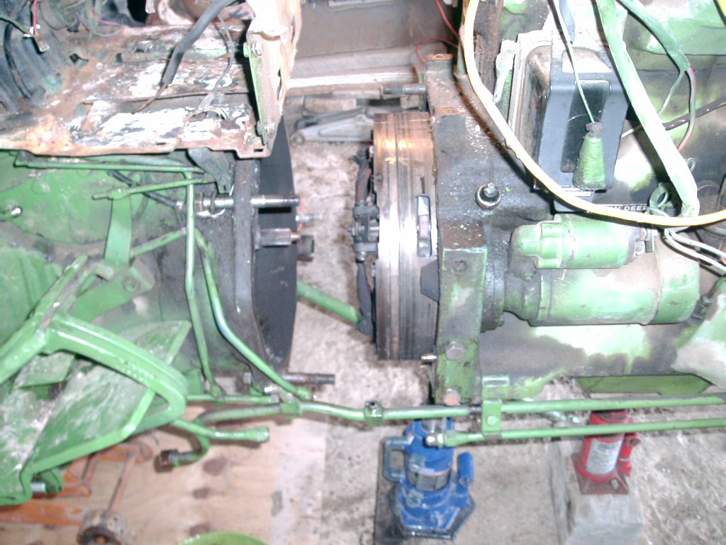

#14

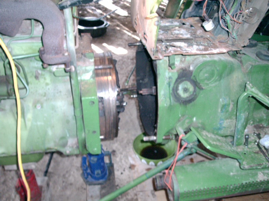

Well I found my problem,clutch disk was wore out.Some of the rivets are missing and the pads are just wore out.It lasted 36 years,pretty good by my accounts.Pilot bearing was not smooth rolling either.Replace that too.Got lucky because the flywheel plate & the clutch plate had no rivet wear marks in them,still smooth on both.
#15

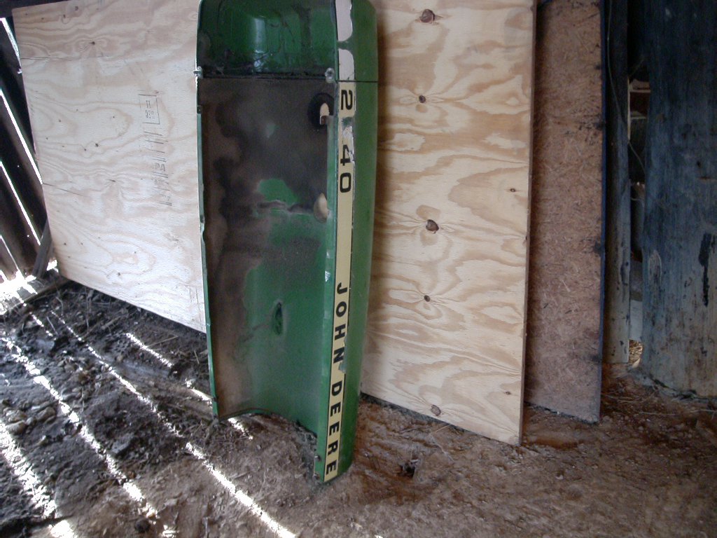

More pictures.My biggest problem was the water temperature sending unit.I think the last picture is it.I sprayed PB blaster on it and let it set all night.Broke a 17 mm wrench trying to bend it a little in a vice so it would fit in there and clear the top of the exhaust manifold.Nothing left to do now but buying parts and putting it back together.

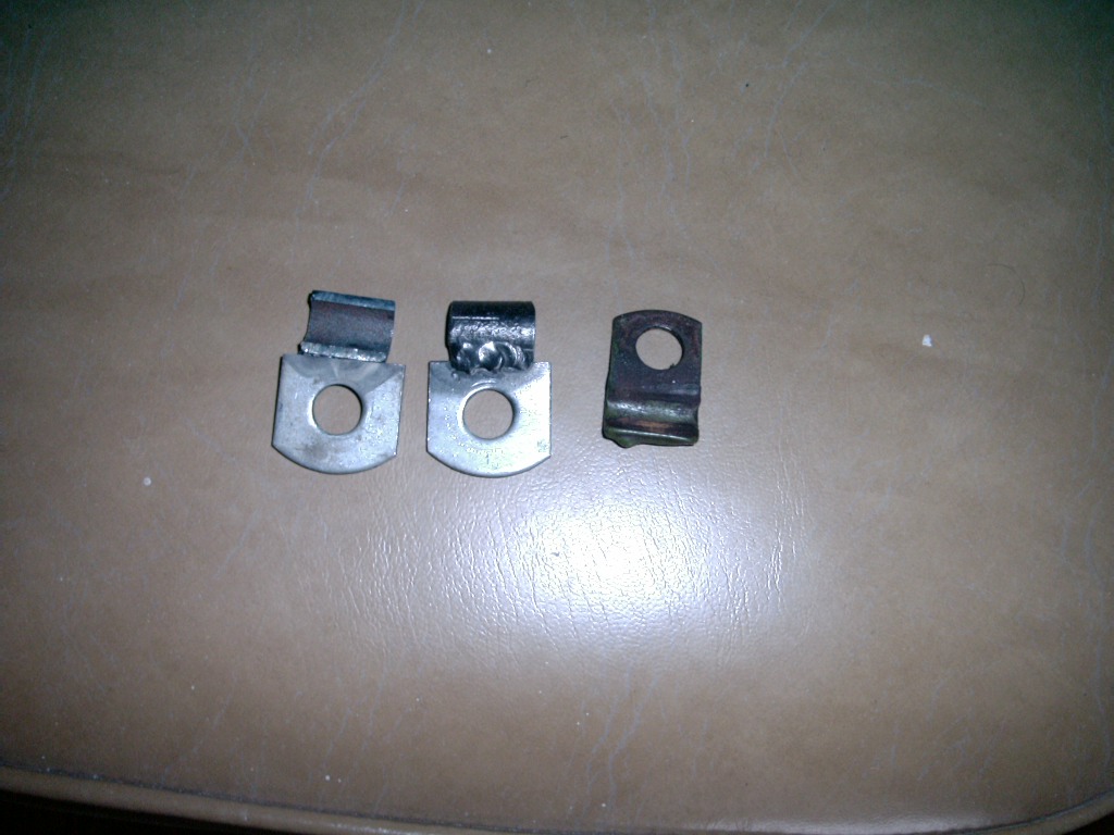

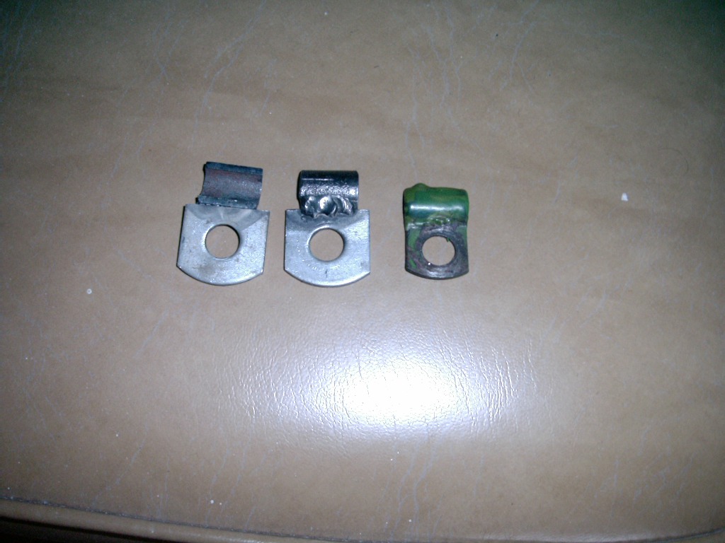

I noticed I was missing 2 little clamps that go around a smaller hydraulic line from looking at the parts schematic.I still had 2 on back toward the transmission so I took 1 off to have something to go by and welded up 2 to replace the 2 missing.I took a 1" piece of 3/8" pipe and cut it in half and then welded a tab on it for the bolt to go thru.I then painted them JD green to prevent rusting.
