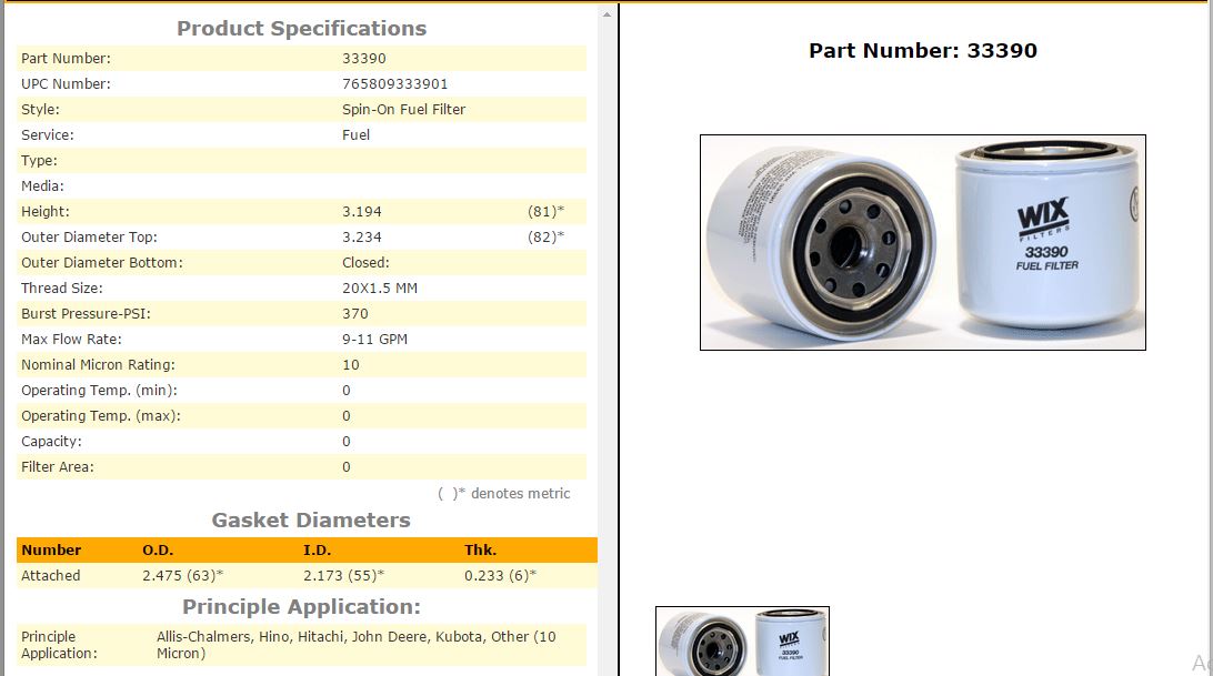

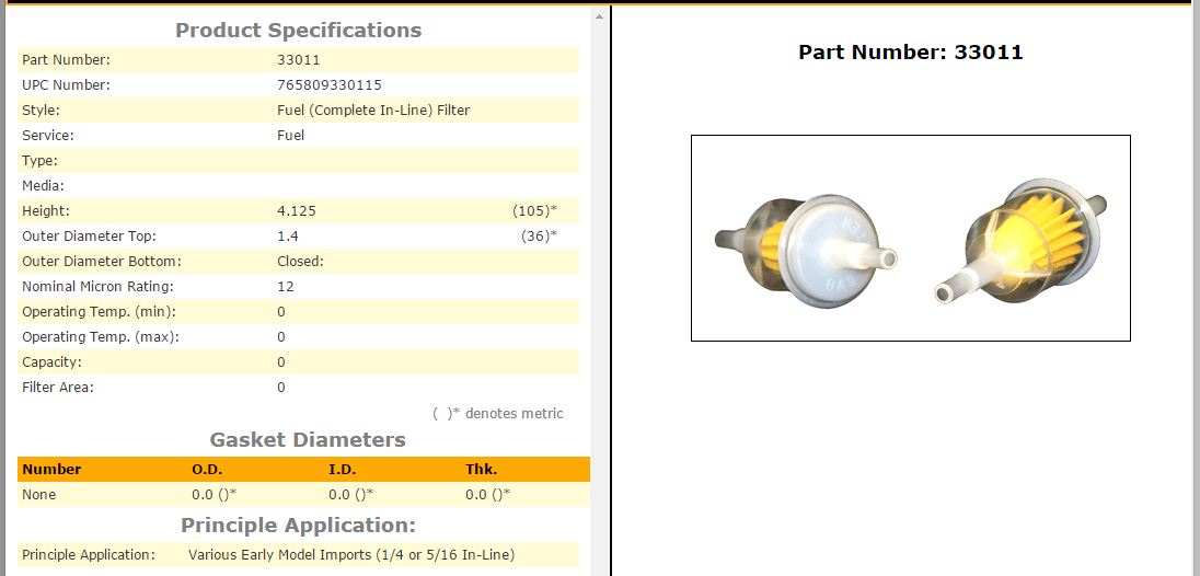

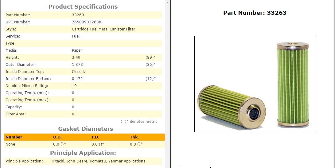

/ JD 2025 #5
Hiya,
I don't have access to the Deere spec pages however it's generally accepted that Deere filters are sourced through Wix/Donaldson and here are the specs from them.
The 1025 series uses a 1/4" in-line filter rated at 12 microns next to the tank, then a water/debris filter combo with a pleated paper element rated at 19 microns. The 2025r has the same combo separator/filter with a 19 micron rating and no in-line prior to it. The next series up, the 2520/2720/2032r use a water/debris separator first with a screen/strainer type filter then a spin on cartridge after which is 10 micron rated.
I don't know why Deere would put an additional filter on the 1 series at the tank, maybe to save owners money as the small in-line is a few bucks and the filter pair for a 2520 is around 45 bucks.
Tom
1025 inline filter
1025/2025r debris/separator filter
2520/2720/2032r spin-on cartridge filter, the screen separator is a Deere only filter and I can't get specs on that.
