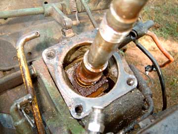

It started with the hydraulic fluid coming out of the steering wheel shaft. And now this is where we're at.

and here's a closer look at the guts of what we're trying to fix.

We're up and running!!! Thanks to all who helped out. There's a lot of good solid advice in these forums. I thank you, my wife thanks you, my son thanks, our dogs thank you, and my JD 2010 thanks you. Now, to get back out there and tractorize the world!!!!

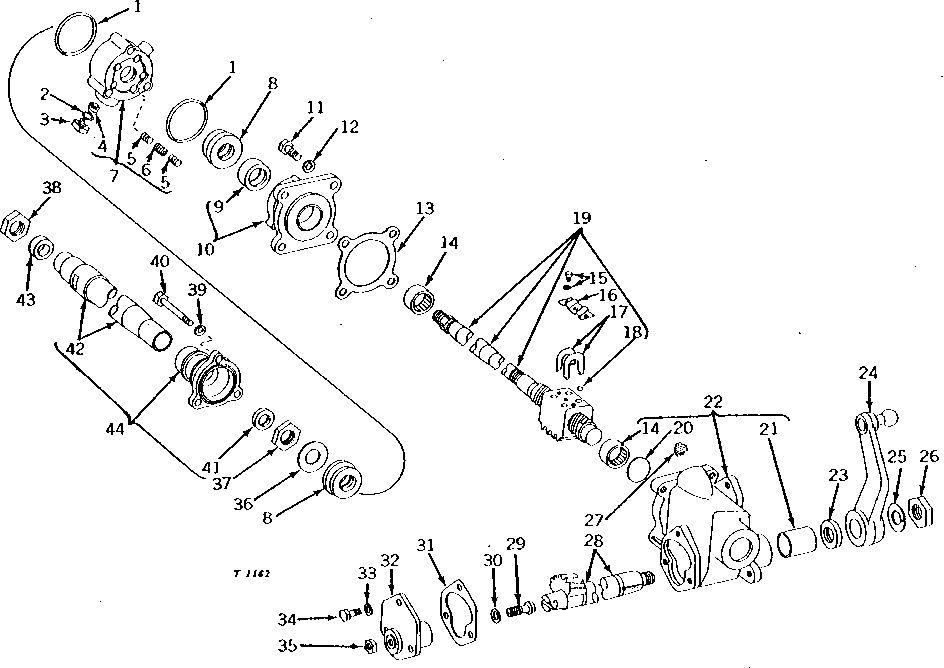

I have a JD 2010, and am experiencing the same issue....hydraulic fluid coming up the steering shaft. What was the solution to your problem? Just replace a seal?
   / JD 2010 Power Steering #7
Might try a PM to StevenPaul, but his activity shows last to be 2009.
There may be others who can chime in and help you too.
The parts breakdown can be found on jdparts.com, if that helps.
   / JD 2010 Power Steering #8
I think you need to replace seal(parts key #9)
