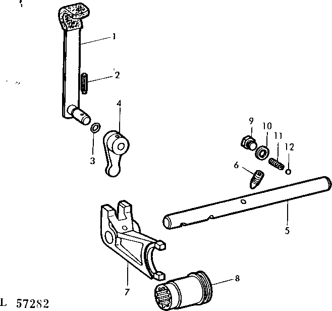

I am trying to change the PTO oil seal and I am having a little trouble getting the cover off. I tried a gear puller but there isn't enough of a lip on the left side. I was wondering if I'm doing it wrong or is there an easier way.
Thx
Attica
   / JD 1530 #2
You need to hold shift lever(parts key 1) forward when pulling rear pto shaft out of tractor so shift collar(parts key 8) doesn't fall off pto input shaft.
   / JD 1530 #3
Tap the PTO SEALHOUSING LIGHTLY WITH A HAMMER And drive the frontwheels in a ditch then you do not have to drain the tran oil Then pull out
   / JD 1530
Tap the PTO SEALHOUSING TIGHTLY WITH A HAMMER And drive the frontwheels in a ditch then you do not have to drain the tran oil Then pull out
Thx. I was going to try that but I was afraid I might crack it.
