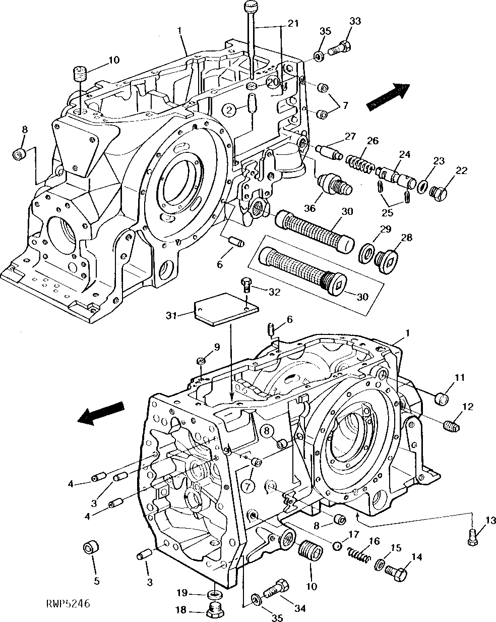

NO. How long since hyd filter was changed & sump screen(parts key 30) was checked/cleaned. Then I'd suggest to check trans pump pressure. It should be around 165 psi.

Not sure on when services last, I will R&R filter/screen. Any hints on where to tap into for pressure check?
You can check trans./pto clutch pressure on shifter cover under sheet metal cover that the 2 gearshift levers protrude through.
