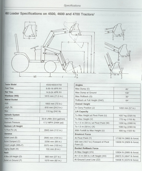

Art, nice to see you're still around too! All these brochures and such are hard to figure out. I would like to post a pic of the JD 460 loader specs and you can tell me how it compares to the Kubota LA853 lift specs. It's kind of hard since Kubota is fairly vague on at what height specs are recorded.
By the way, I was using the specs for the LA853 from Kubota's website.
Kubota Tractor Corporation - L Series - Grand L30 Compact Tractors Attachments
Billy, it looks like if anyones was hard to read it would be Kubota's! I started out to look thru the boxes of old literature that I have to find the one that was ever so lacking and misleading when there was a switch to the pivot pin in reading the jd literature but yet they didn't disclose it when the rest of the industry was using the ASAE standards of in the bucket. The mid height range for load is new and is just becoming a point of reference and I believe that comes from the skid steer market. Could it have been a mistake? Possibly but when the company that has the highest investment in marketing for the last thirty years in this industry does it, doesn't it just make you wonder?
