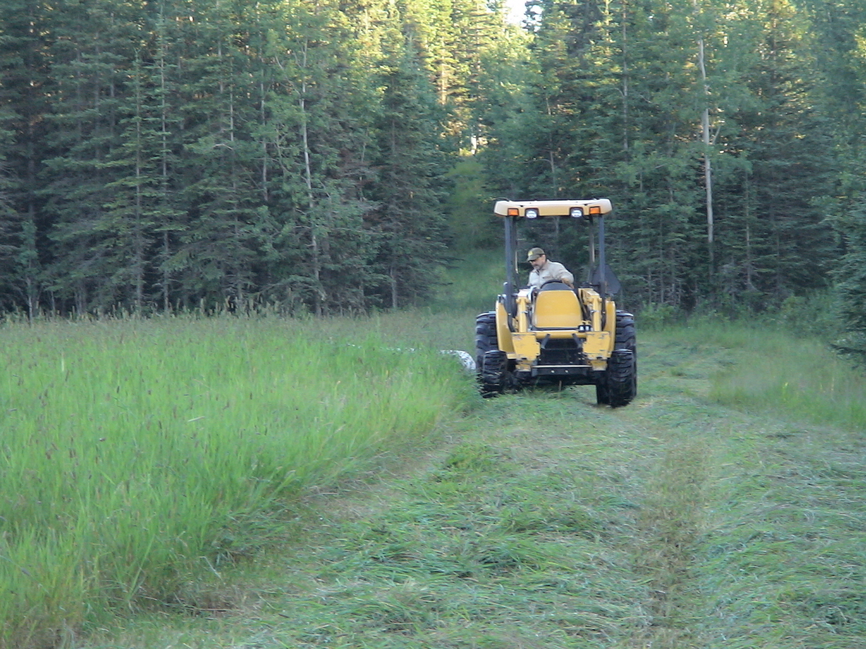

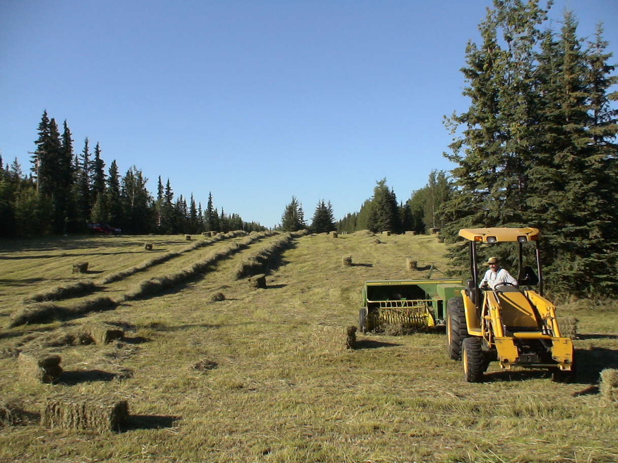

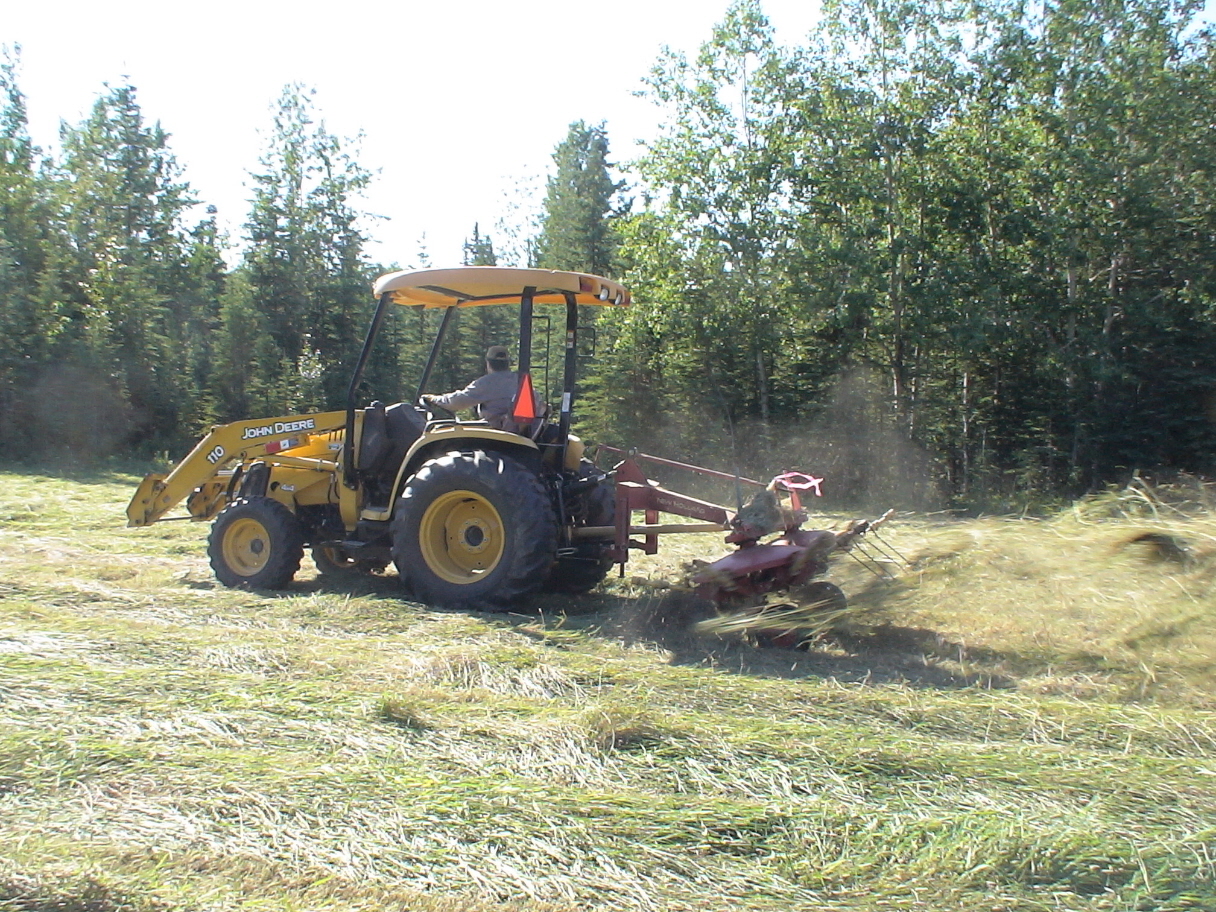

Just finished baling the winter feed for our horses and chickens... yes, chickens need hay, too! :D
The 110 did great - everything from running the Kuhn disc mower to the JD 336 baler.

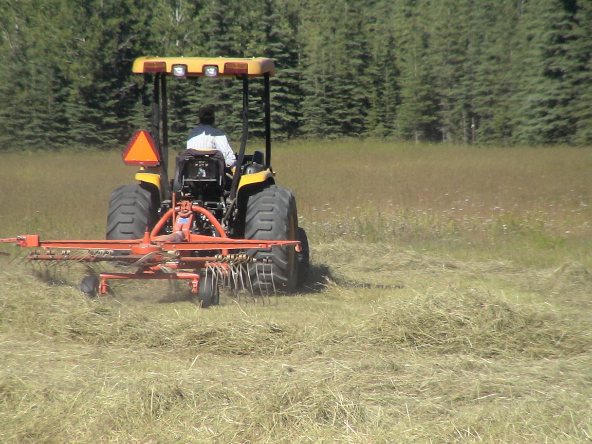

nice looking country you have there! first time i've seen a tlb haying. looks like you're rake is missing quite a lot of hay. how much do you need to get through the long winters up there? does that mower have a conditioner?

Nice pictures! Sure is strange seeing that 110 without the 'hoe on it!

I wondered if I could use mine for hay -- the question is answered.
Thanks. Not a good pic of the raking - the Kuhn does a really good job of cleaning up the field. Way, way better job than any of the side delivery or dump rakes that I've used in the past.
It doesn't "rope" or twist the hay together in the windrow like you can get with a side delivery rake (especially if you're turning the windrow over) and is so much faster and efficient than the old-fashioned dump rakes. And it "fluffs" the hay up in the windrow that significantly improves drying.
We need about 200 - 50lb bales per horse per year. When we have cold spells; each horse will eat darn near 2 bales per day! 'Course they're always gonna waste some hay - so, that's what I feed 'em - a couple bales each per day.
No conditioner. That takes a bunch more Hp than the 110 can deliver! You really need about 75hp @ pto for a disc mower/conditioner combination.
My biggest concern was the JD336 baler. I wasn't confident that 33hp @ pto would be enough to turn out good bales - consistently. But we baled almost 500 bales and it didn't miss a single bale!!! :thumbsup:

Way cool - how did the baler run?
The baler did a super job! Didn't miss a bale. I went thru it and thru it and thru it... likely $800 in part's and extra pieces - but it didn't let me down! :thumbsup:
This year was one of the wettest and latest hay season's on record. Anchorage set the wettest July ever recorded.
I was trying to work deal's for hayledge and buying trucked in hay - before we had a 4 1/2 day sunny break.
But the hay's in the barn -- Yeeehaaa! :D
Workin' on the neighbor's hay yesterday and today. They didn't get their's up during the weather window I hit (they've got about 70 acres of hay) so, we're trying to get it in the barn now.
