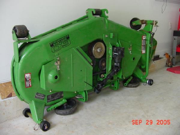

BT, he has (or has made something simular) to these: Mower Deck Axles,Carrera,Cayman,John Deere,Kubota
Here is my deck on them:
The problem with having one axles pivot could be the instability that could occur when turning.

Good idea there, and tks for the pic. See a few additional mods that could be made to the basic idea. Hope the OP sees the possibilities.

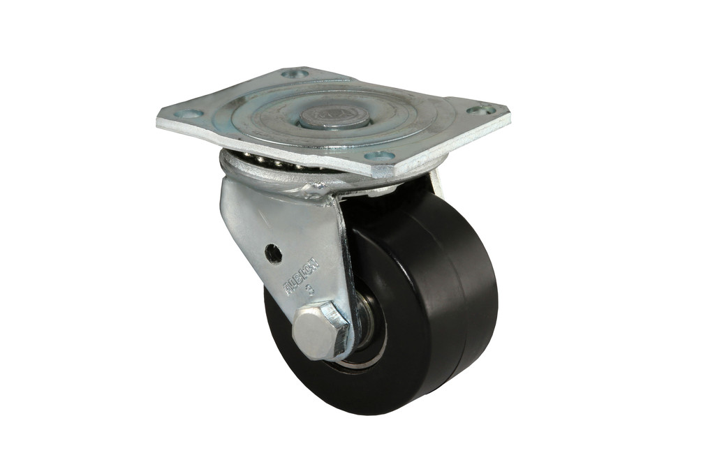

Get a couple of these.
Either weld or bolt them onto a pipe that fits in the place of the current roller wheels.
Richard

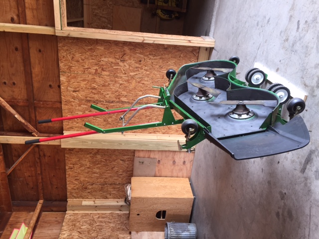

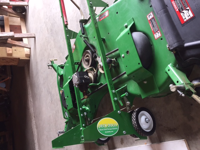

I decided to give the Deck Dolly a try with the longer handles. As often I have to clean the deck (seem like am always mowing when it is wet) I am looking for the fastest way to clean it!
/ JD 1025 MOWER DECK STAND
#12

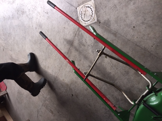

I assembled and installed the deck dolly today. You were correct - you need to be a horse to lift and move the JD 60 deck. To remedy the situation, I installed /bolted on fiberglass handles from an old post hole digger which gave a 2' extension on the 6' handles. Now I can easily raise and move the deck!
/ JD 1025 MOWER DECK STAND #13
Pictures James, would be great.. ;)
/ JD 1025 MOWER DECK STAND #14
Thanks for reporting back James, I'd like to see a pic also.
/ JD 1025 MOWER DECK STAND #16
Looks good, I think even this weak-kneed guy could lift it now.
