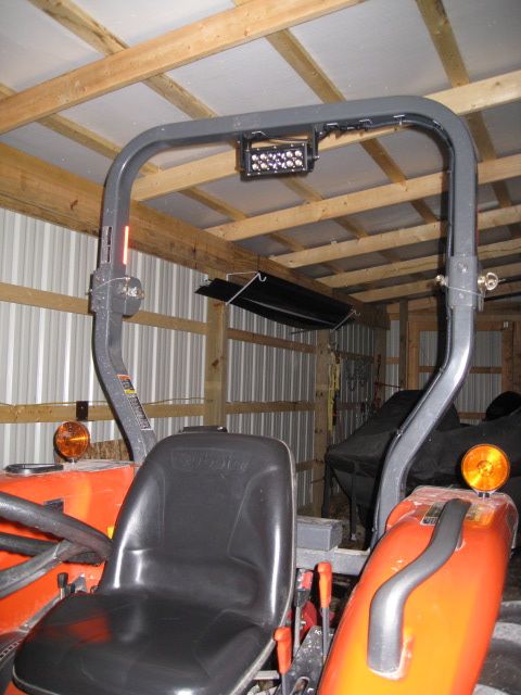

Any in particular you'd recommend?
I'm thinking about adding either a couple of inexpensive small LED work lights or a small bar to the front and rear of my tractor. If I used a bar it would probably be in the 18-24" range.

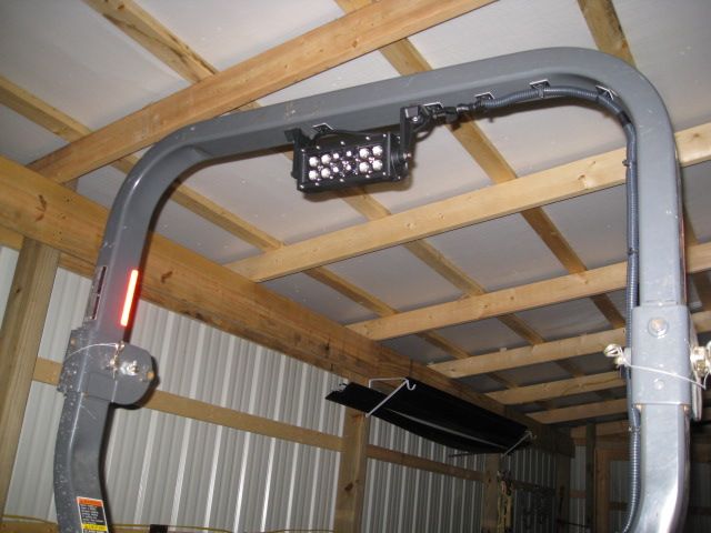

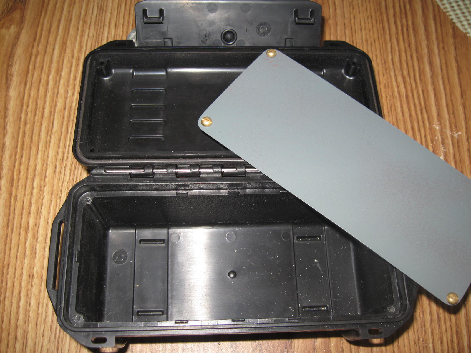

Others have more experience on what types of lights to get for a tractor but I think for a tractor instead of a light bar you'd be best served by a number of spot lights pointing in different directions. The 60ー floods only throw light out about 20-30 feet and the 20ー floods reach out further. These lights are kind of a compromise between spots and floods with 30ー beam and are what I plan on mounting onto my tractor when I get it.
FWIW, all cree means is that there is a little lens over the LED emitter that helps aim the light onto its reflector better. On these little lights, the cree lens is tiny, barely the size of the emitter and on light bars, the cree lens is larger, and part of a molded assembly that covers multiple LEDs. See the attachment for photo detail.

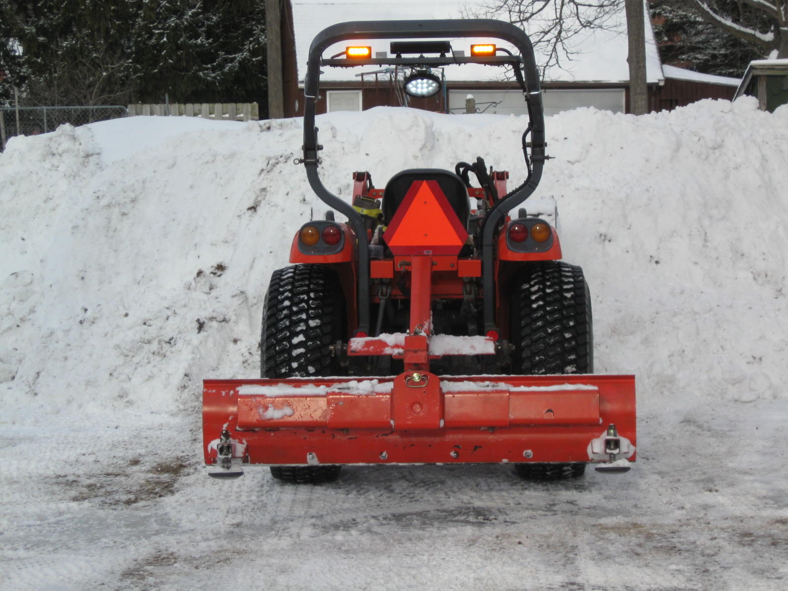

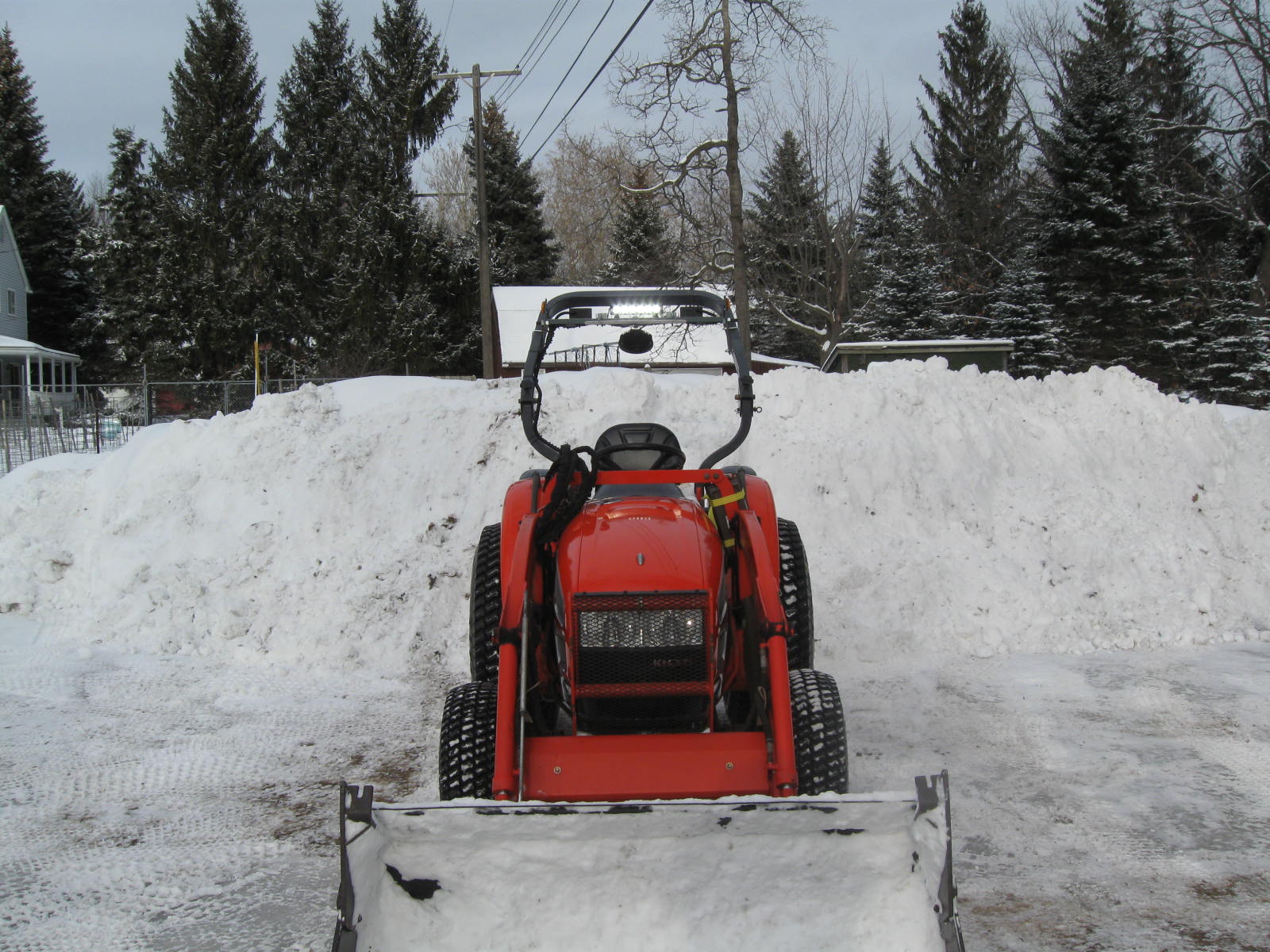

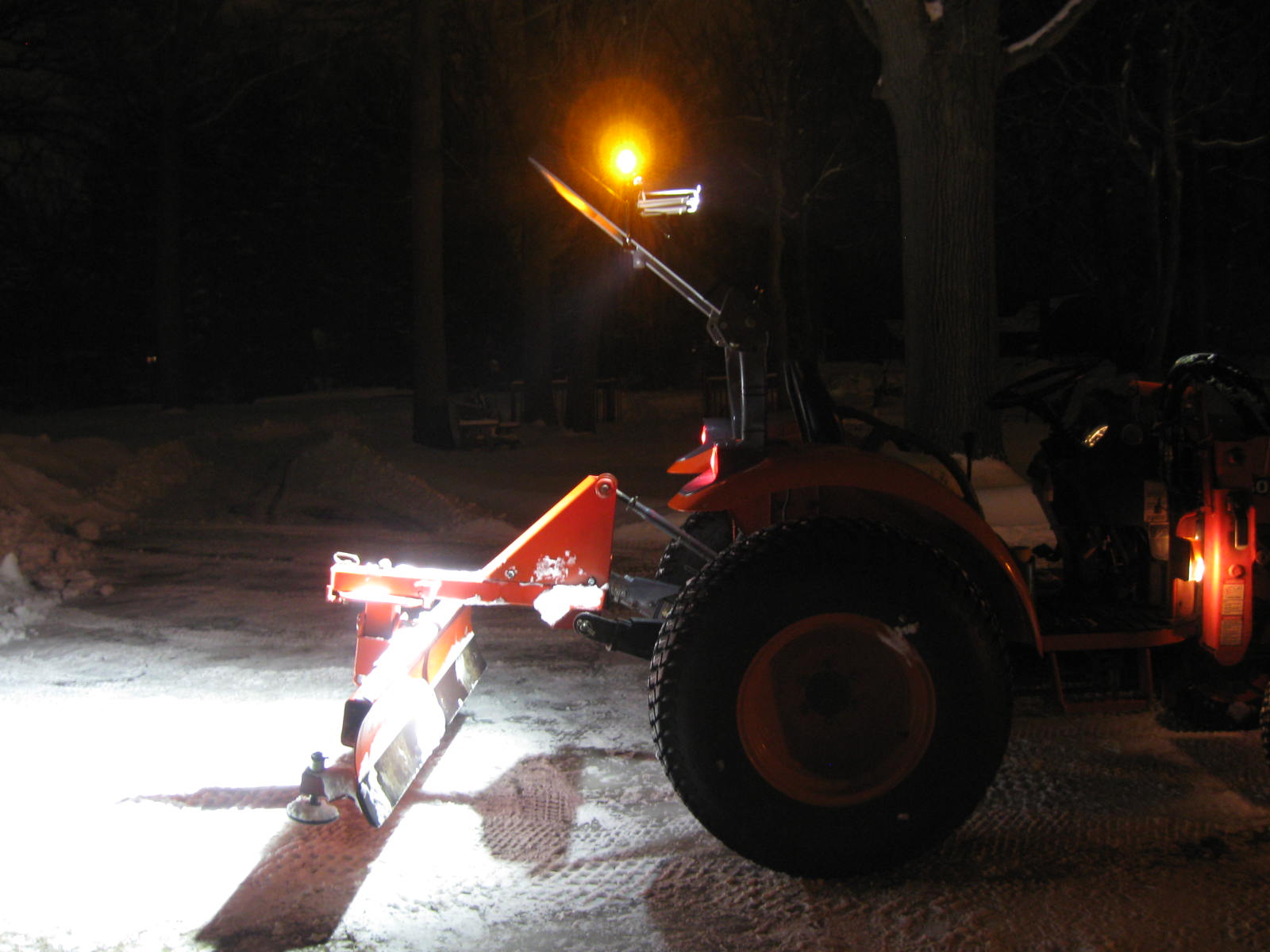

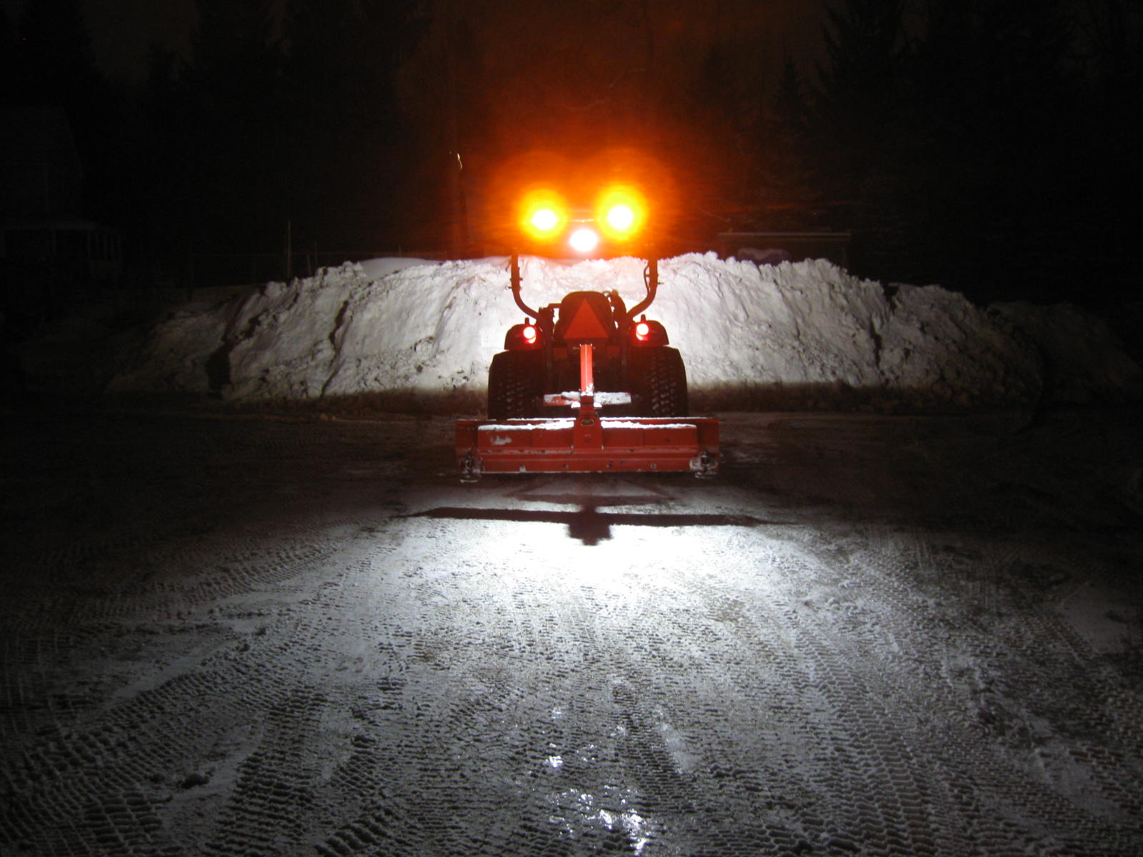

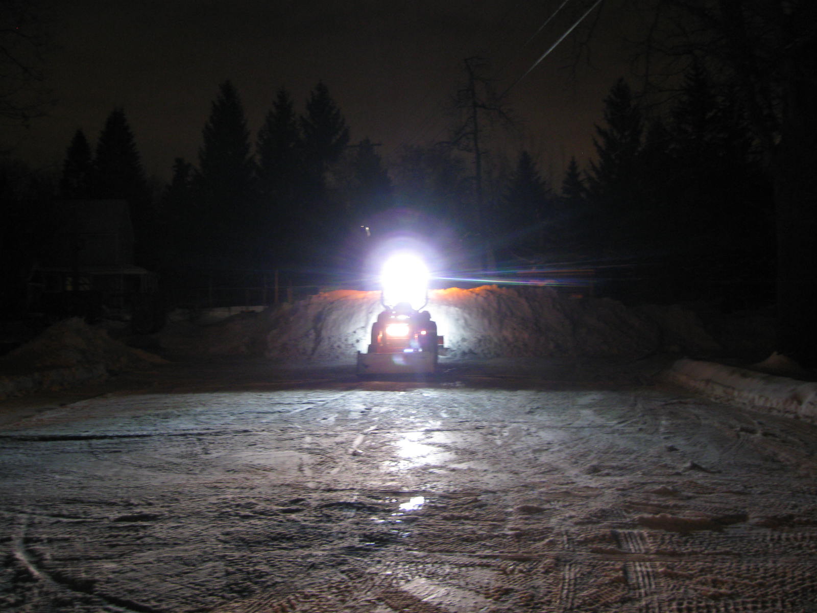

It looks great.. The headlight seems to be very bright.. Can I use these led lights for the truck lighting at the front of my truck??
Welcome David! I believe you have your question answered! :thumbsup: I will say....... I'm very pleased with my set up. It has all worked out quite well.

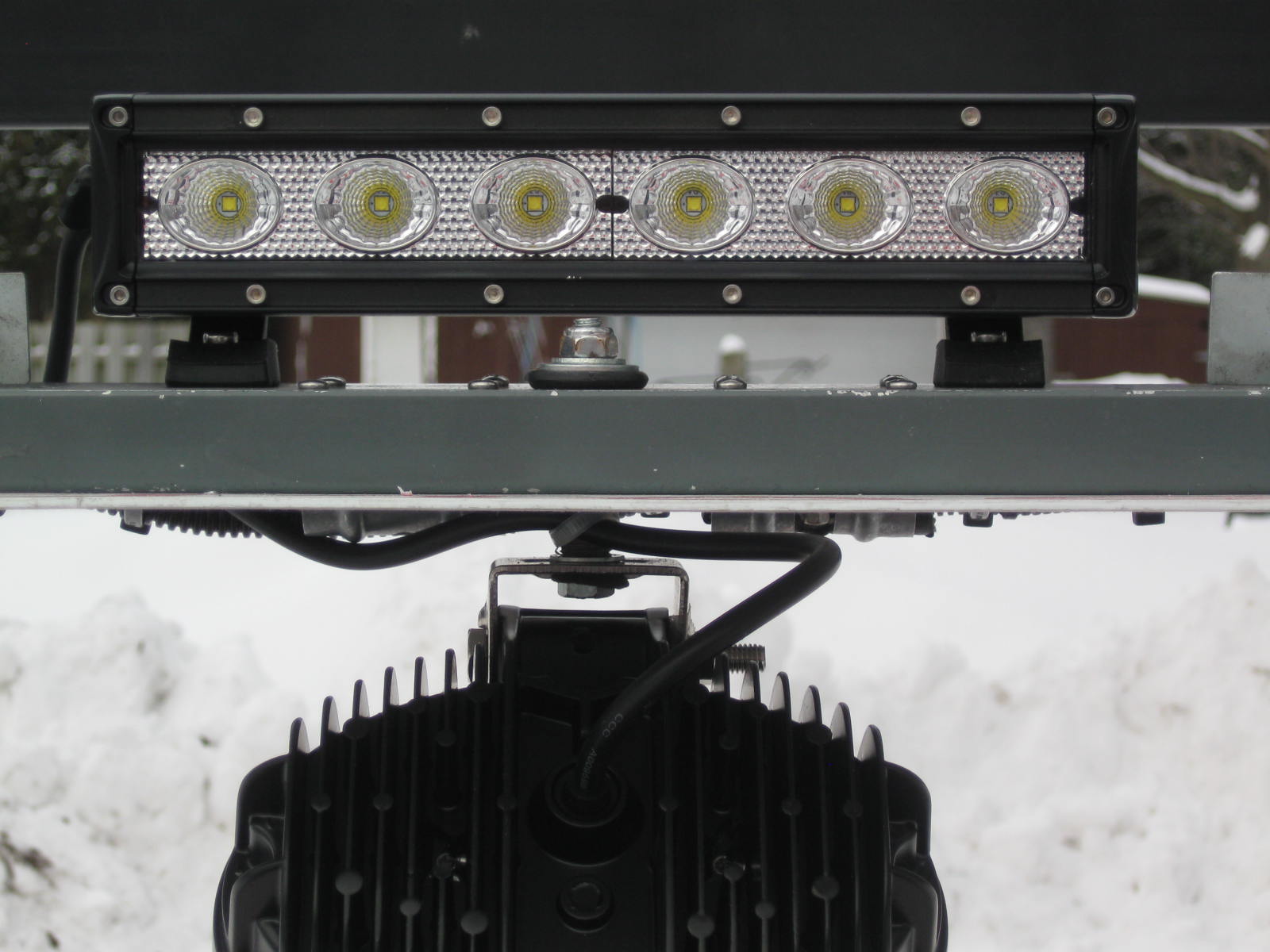

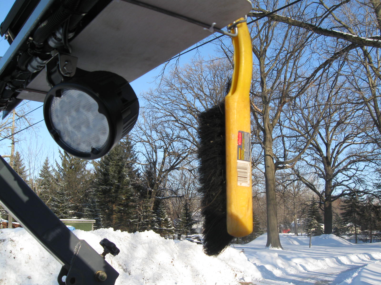

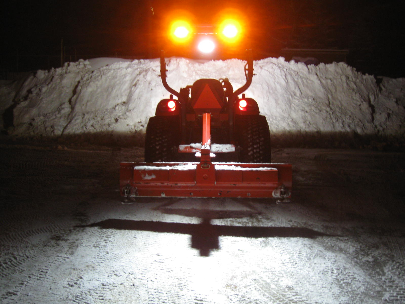

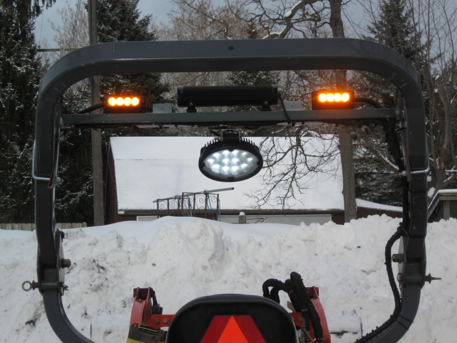

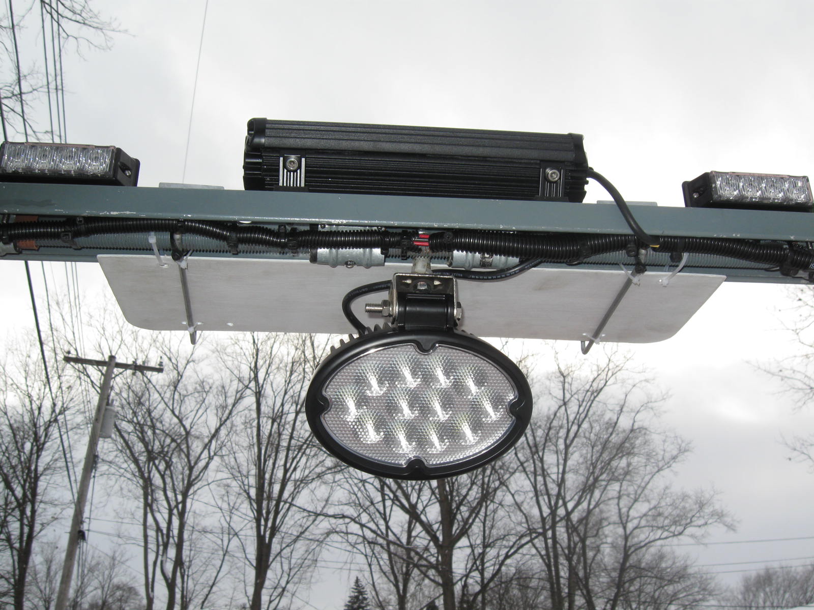

The rear facing light is an oval shaped flood, is 36 watts and has a patterned lens that emits an incredibly balanced/even spread of light. Oval flood was a 'TMH Lighting' product purchased through Amazon.
Can you link to which light you bought? What are the lumens and beam spread?

Info from TMH lighting website: TMH-LED-R-36W-TMH Technology Co.,LTD
Amazon link: Mine is the TMH 36watt oval. There is also a TMH 60watt version for $10 more.
Amazon.com: TMH CREE LED work light oval: Automotive
I believe these now ship from China. When I purchased Amazon had them in stock.
These 36watt LED oval work lights were $38, they are currently $33.50. Orders are currently "fulfilled by Amazon" which means Amazon has them instock for more efficient shipping.
