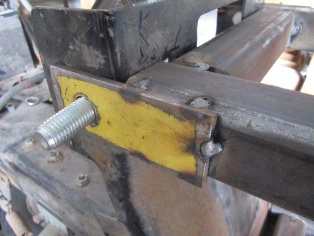

I put in some shop time the last few days and hung some of the parts on the tractor. As I feared, the front of the tractor will be off the ground without significant ballast in the form of a dozer blade plus weights. Of course, while digging, the outriggers - which I have yet to build - will shift the balance somewhere between the pivot and the bucket.
The photos show the boom and dipper attached to the pivot to determine the amount of swing. I think it might be a bit limited but I will go with it for now. I have a way to increase it if needed. BTW, that pivot swings smoothly and I'm hoping it's as strong as it looks.

That looks Great!! You've made some good progress. The outriggers will make a huge difference in the balance, but I still think you'll want a blade with down pressure or some other way of stabilizing the front. Keep in mind that when you dig with the hoe the forces all reverse and you're putting pressure down on the front rather than lifting it up.

That's what I keep telling myself, Iplayfarmer!:cool: I'm just hoping that the gear I'm placing forward of the front wheels will supply the needed weight for when I'm moving it around. In addition to the dozer blade, I will mount the hydraulic fluid reservoir and filter out front between the dozer and the grill of the tractor. The tank is quite large and will hold more reserve oil than the system normally would need but the extra weight it provides will justify it, I believe. Any additional weight will have to be in the form of "suitcase weights" which I can fashion from just about anything I have lying around. Most likely a couple of stout boxes filled with rocks.:laughing::laughing:
