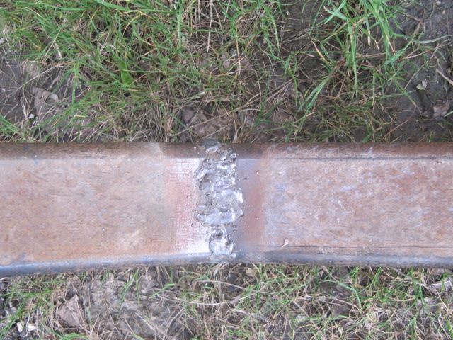

I was able to get in some shop time today. I put a kink in the boom cutting free hand again. Careful measuring and marker work paid off and when i bent the beam to close the gap, the edges matched almost perfectly.:thumbsup: Clamping in the vise and minimal shimming was all it took to match them up.
In the first photo you will see I have left the 5" side unwelded. Since I will be welding 1/4" plate on each side for mounting the cylinders for operating the boom and the dipper, effectively covering that gap, I'm wondering whether I need to fill it. If I don't weld it I don't have to grind it! Second picture shows what I have welded. Not finished there yet. I'll fill a little more and then grind it a bit.

I'm no expert, but I would think that welding, grinding, and then plating it would be much stronger than just plating it.

One of the reasons I'm thinking I could skip that step is because that hunk of steel is about twice the size and strength I really need. I bought it because the price was right. But if plating it is deemed to be insufficient, I'll fill it and grind it like a good little boy.:D:p

Fill it, grind it, then add the gusset plates. I know grinding welds sucks; but you'll kick yourself down the road should you have to fix the boom because you didn't want to grind a couple of welds.

Thanks for the advice guys!:) Looks like filling and grinding is the better route. Thanks.

That's a pretty impressive fit considering you cut it freehand. Good Job!
