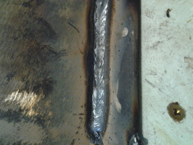

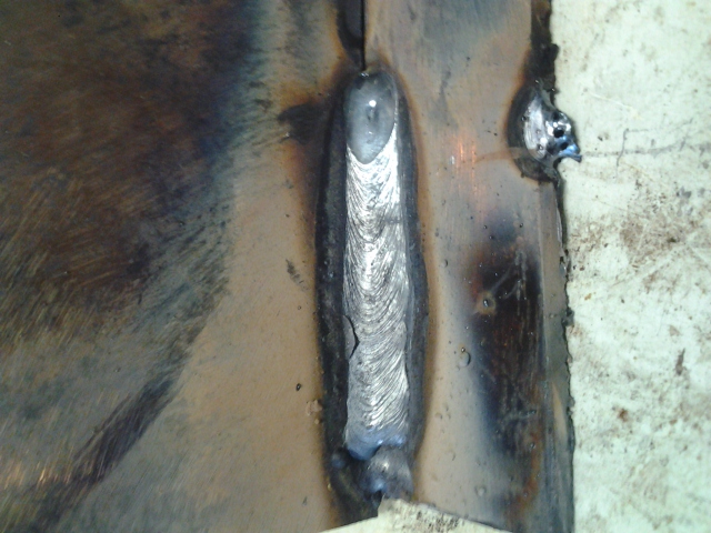

Well, after 6 months, I am finally back to welding. I got my stickweld 250 wired up yesterday, and with simon's help I got it right on my second try.... Darn 3ph cable... LOL
Anyways, I burned a few rods today, and I was surprised how fast it came back to me. These were my first welds since November.... 7018 1/8. Amperage was somewhere between 120 and 130. I still have no clue how to set the arc force, but this one does seem to change a lot. The first one I went a bit fast on, and it shows. The second one isn't too bad...
I think another few pounds of rods, and I will be back to making consistently nice and strong welds. If only I had some steel.... I am all out of plate, and those little bits were the last of my scrap. The rest is likely part of a Chinese toaster now.
Anyways, here are some pictures. I am loving this stickweld 250! The Bernard shortstub makes it a joy to run.

I forgot to mention, I had the polarity wrong for the ugly one....
7018 really doesn't like dcen....LOL
The way I look at arc force when welding with 7018. If I'm running vertical up hill I want a dry puddle. So I turn the arc force up. If I'm running over head I don't mind a little wetter / flowing puddle. So I turn the arc force down some. If I'm welding flat only, I want a wet / really flowing puddle, so I'll turn the arc force down a lot.
High number = dry puddle.
Lower number = wet / flowing puddle.
When doing open root with 6010, I'll turn the arc force all the way up. Any other welding with 6010 is pretty much the same settings as with 7018.

Arc force really only kicks in when your arc is too tight to the work. It adds amperage to keep the rod from sticking. Turn it way up and you can push the rod through a 1/2" plate without sticking... Great advancement in stick welding along with Arc Force. If Buzz Boxes had those features they would be $1000.00..I need to mess with it when doing out of possition stuff. Unsure what to expect from overhead.,
