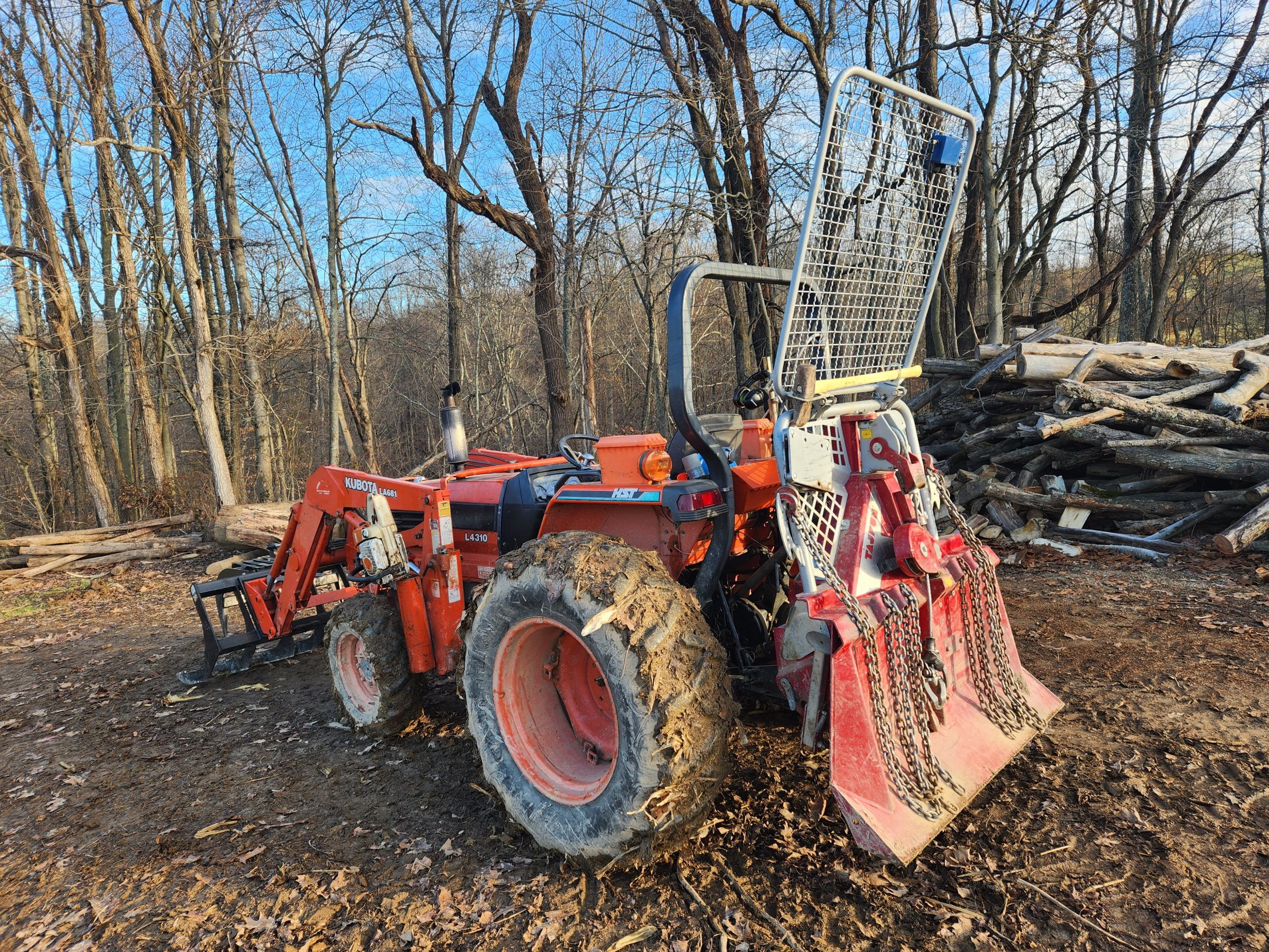

What have you guys built to skid logs out?
I have heard of more problems with Farmi-style rigs, and I'm looking for simple rigs that just plain work for a part time logger.
Bonus for photos...
I have a tajfun winch I use on a 43 hp Kubota L4310 I have skidded thousands of logs without any problems
