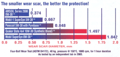

/forums/images/graemlins/confused.gif Maybe Robin can sell more replacement parts and engines that way!!!! /forums/images/graemlins/shocked.gif /forums/images/graemlins/smirk.gif
/forums/images/graemlins/grin.gif /forums/images/graemlins/grin.gif /forums/images/graemlins/grin.gif /forums/images/graemlins/grin.gif

MR Potter
Do you own a pt or any tractor. I had asked for recommendations before on the correct oil that you would run in the pt's and you never responded.
