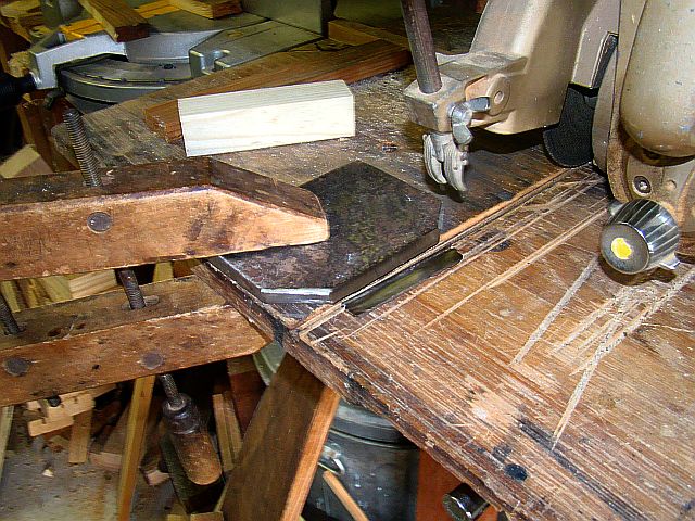

Found a 1/2 " steel plate almost the right size.
Had to nip corners and then remove 1/4" on one side.

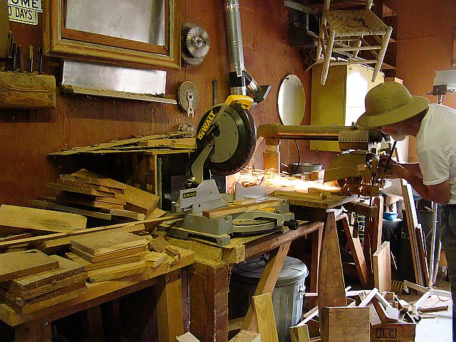

How do you like my combo wood/metal radial arm saw?
Took many passes to cut. Did not even get too hot to touch.
I know it's a mess, but if I didn't save stuff I would not have had the 1/2inch plate.:D

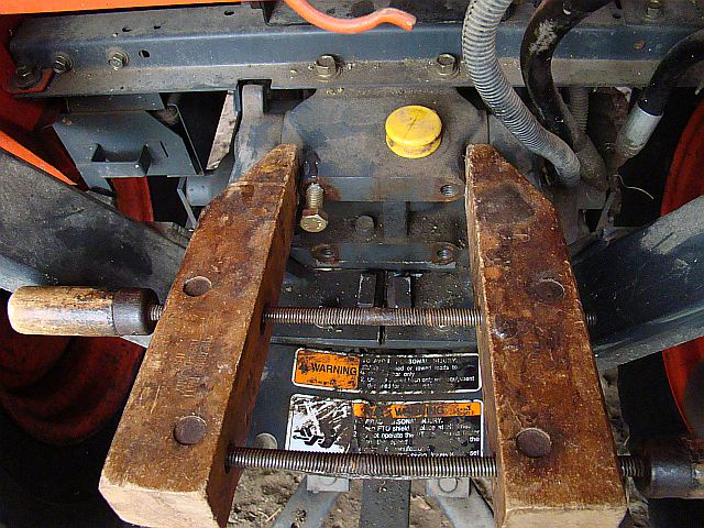

Cut wooden spacer to clamp between the brackets for welding NOT good idea.
Wooden spacer let the brackets move when welding and holes were too far apart.

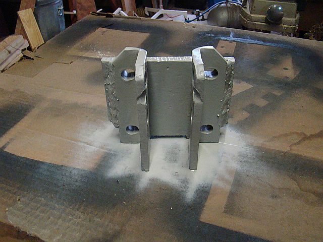

Now I know what caused the break. When I added TnT I did not check clearances close. The top cylinder was forcing the brackets apart. Your can see the evidence in the picture. I have cut out a little extra now and the top cylinder does not touch when lifted to the max.
So dear friends, when you start mixing and mis-matching be sure to check all movement from one extreme to the next.
JB weld broken chard back in place with bolt covered with paste wax to keep JB out of threads
Tighten bolts in three unbroken holes then tighten bolt in JB welded hole just snug twist of the wrist. Had used 4 minute JB did hold.
Hooked up the tiller with the three bolts holding and looks OK for now.
Thanks again for all your concern and replies.
Afterthoughts:
When using a miter saw for cutting metal I have used a smaller diameter abrasive blade than normal. Found this was much easier on the saw. :D
Of course I'm late as usual.:(
Yep, I started with a 7 1/4 blade on my old 10 inch radial arm.
