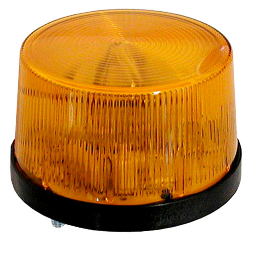

LAGEORGE,
I like your set-up. I used a cheaper version on my Yanmar, for times I was out near the road. They had a bolt pattern on the bottom that exactly matched the mounting of the original turn signals. My good luck. They are Xenon stobes with built in strobe unit. Just run 12V to them. $8.95 each plus shipping. I was not impressed with the bolts in the bottom though, they were epoxied in and 2 of them pulled out when I got over zealous with the wrench. Epoxied them right back in /forums/images/graemlins/grin.gif

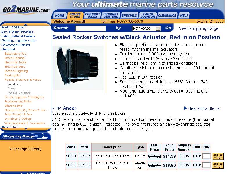

Hey George, very nice installation. I am looking to do the same with my TC24. Can you tell me which switch you were looking at with the LED?
Dave /forums/images/graemlins/smile.gif

I found and LED waterproof switch at go2marine.com. I have included a link to it. I like the LED idea but the switch does not look as promising but then again I do not know I have not used it. The Ancor switches seem to be the same ones used by New Holland so if you want to keep it factory looking you might want to stick with the Ancor switch even though an LED does not light it.
Footnote to installation of the switches in the position I have them mounted on the tractor. The switch is very deep and it kind of presses against the fender. I put some plastic/tape insulation on the fender behind the switches to keep things from shorting out. It is a very tight fit but it seems to be holding up just fine.
George
PS: thanks for the compliment! /forums/images/graemlins/smile.gif
LED Switch at go2marine.com

Found somthing better than a switch!
see the webpage I printed since you can't link to it
George
