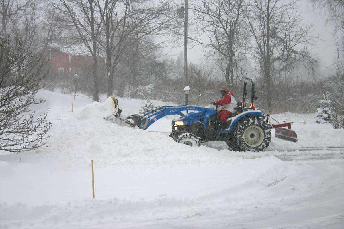

Jim & Bird,
We got a real heavy frost this morning. So heavy I could plow it. Much fun was had! (see attachment).
Larry /forums/images/graemlins/cool.gif

</font><font color="blue" class="small">( We got a real heavy frost this morning. )</font>
Wow! Larry, you sent a chill up my spine. /forums/images/graemlins/shocked.gif I'm so glad I live somewhere I don't have to deal with that stuff. Yesterday morning it was 24º, and this morning it's 49º. Before the day is over, it's supposed to top 70º. You have every bit of my sympathy and admiration for being able to cope with snowfall like that. /forums/images/graemlins/crazy.gif
   / It fell in the tank…… #18
Re: It fell in the tank&#8230;&#8230;
Looks like you were having fun, big boys and their toys. As for me I am getting frustrated waiting for the heavy snowfalls Michigan often gets in December....all that green (pun intended) spent on my new JD and it has been sitting indoors for the past 3 weeks. I WANT SOME SNOW.
   / It fell in the tank…… #19
Yep, Larry, that's a bit heavier frost than I've ever seen personally. /forums/images/graemlins/laugh.gif
