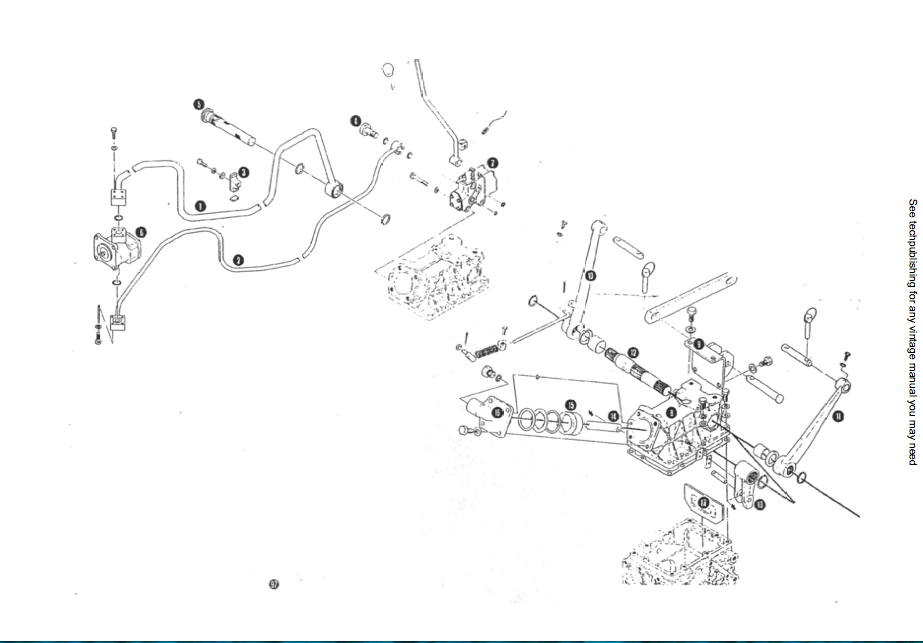

/ Iseki TX2160 hydraulics #12
Hi,
Sorry to hear that you are still having issues. Attached are the only two pages from the service manual that I have about the hydraulics. I wish that I had a better understanding of the hydraulics to help you more, but I usually have to refer to the manual when it comes to the 3point lift. Can you possibly use a mechanics stethoscope to help find the leak? Anyways, I hope that this helps a bit. Sorry for the poor resolution...
