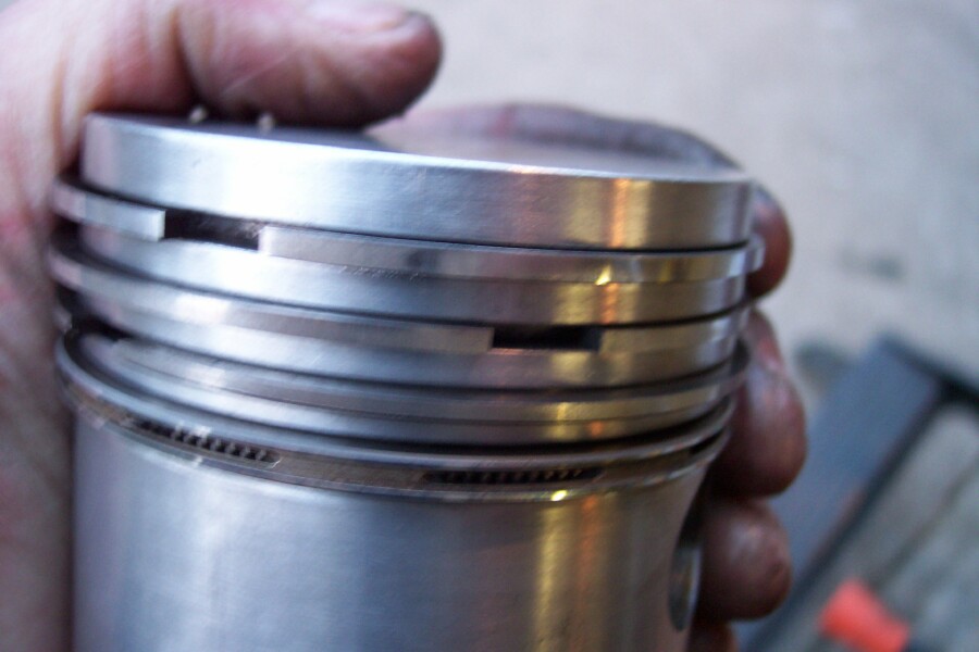

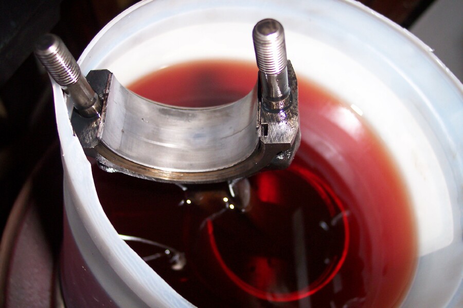

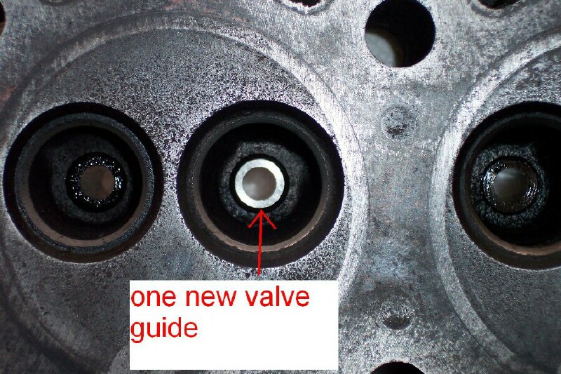

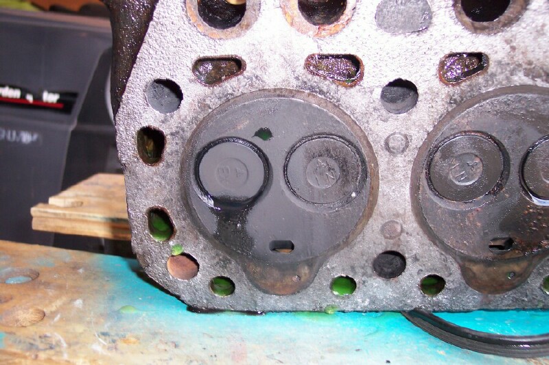

/ Iseki tx1300 no start #10
When I got mine it had no compression in the front cylinder
and less than a 100 in the rear. After I disassembled the
engine enough to remove the pistons I found that
the rings were stuck from sitting for so long. I soaked
the pistons in kerosene for a few weeks and was able
to free up the rings enough to remove them from the pistons.
I then could clean the ring grooves and pistons. I also
deglazed the cylinder walls. The valves were not seating
very well so I lapped them in. I had to do the valve seals
and head gasket but overall getting the engine running
was not that expensive or hard to do. Fixing everything
else started to add up. Also the minimum compression
for this engine is 350lbs normal is 450 lbs.
Also I reused the rings because I didn't want
to spend to much because of the uncertainty of any
other problems. The tractor is running great now
after all the work. It starts right up every time.
