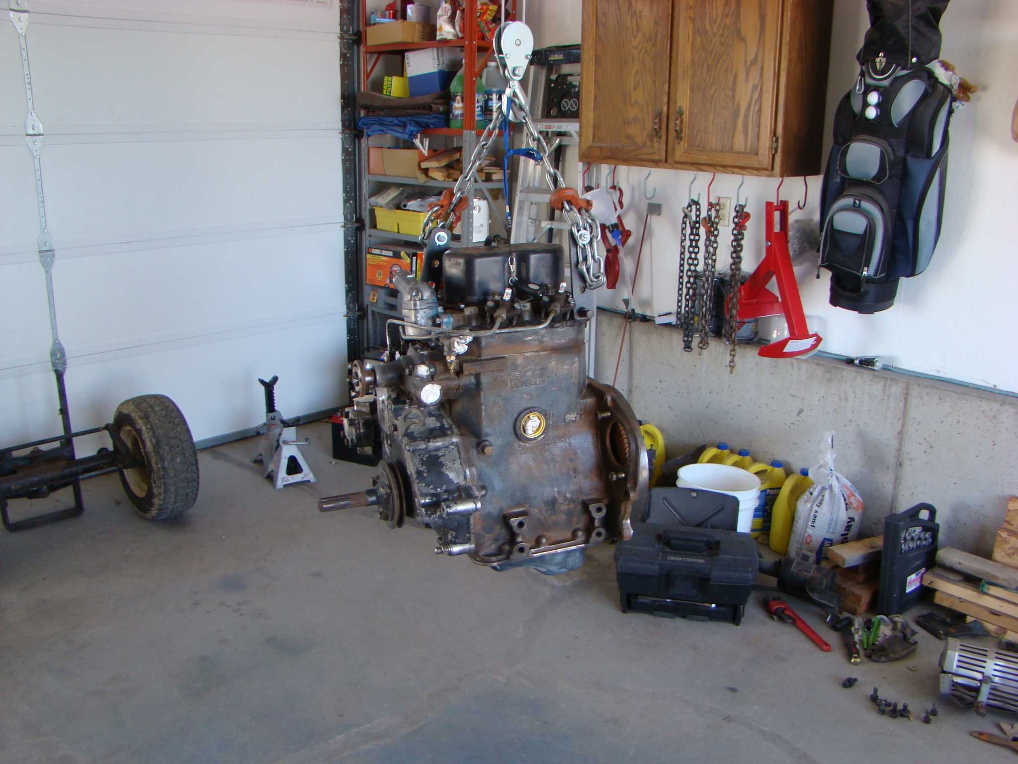

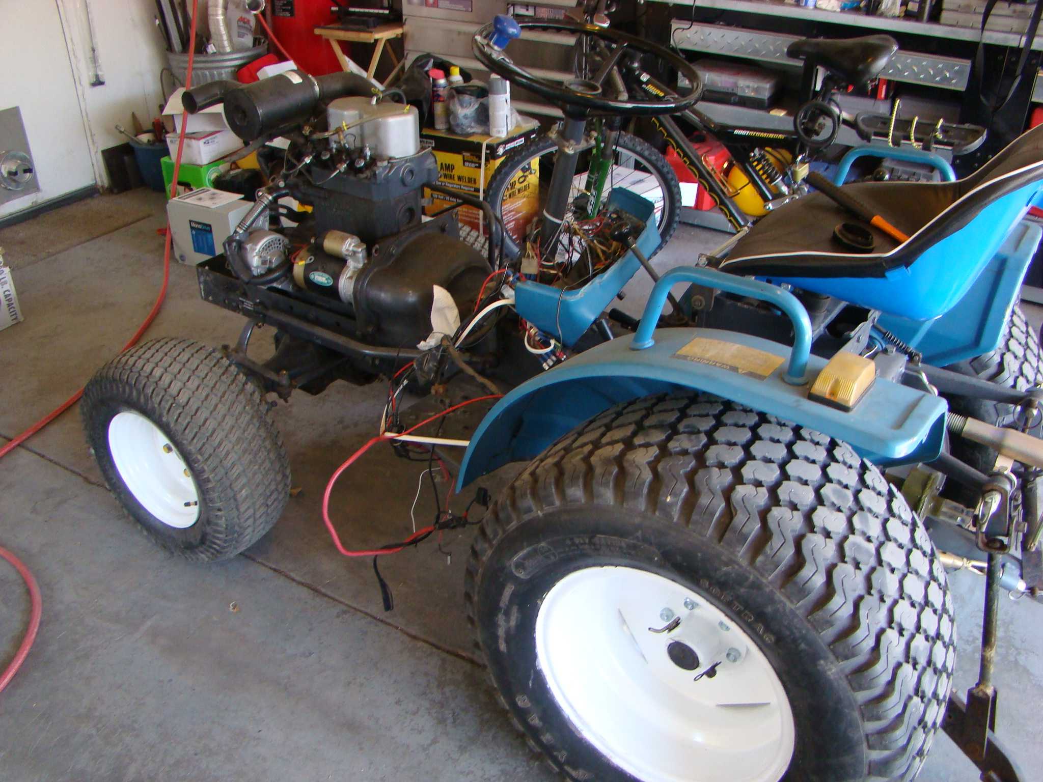

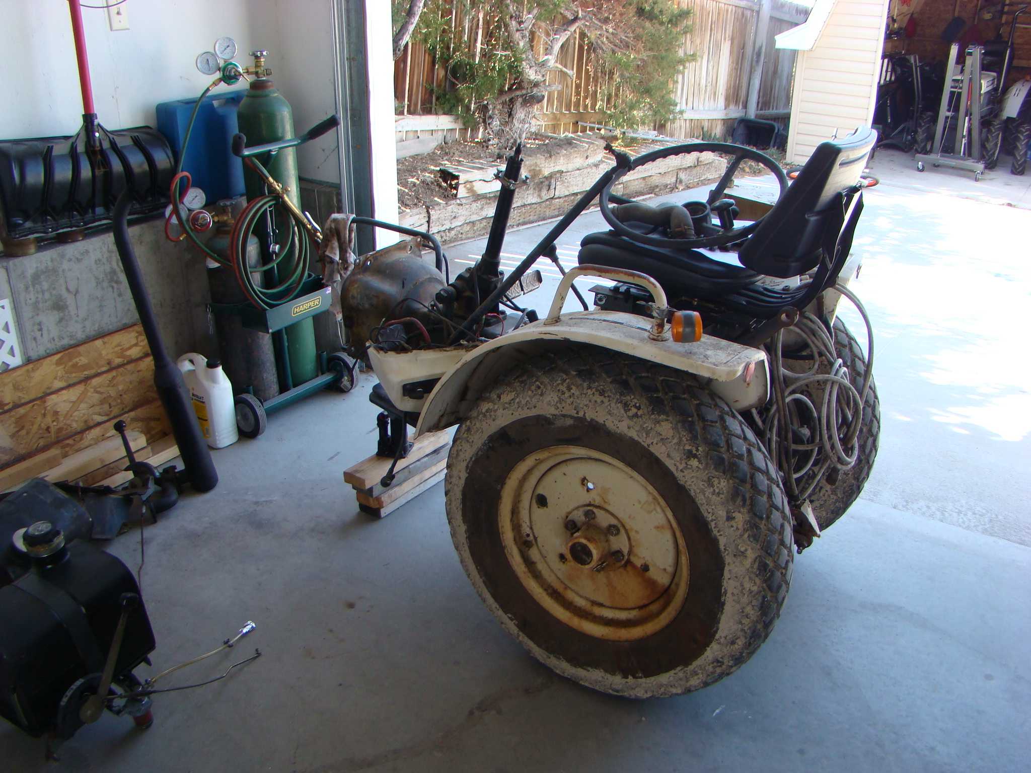

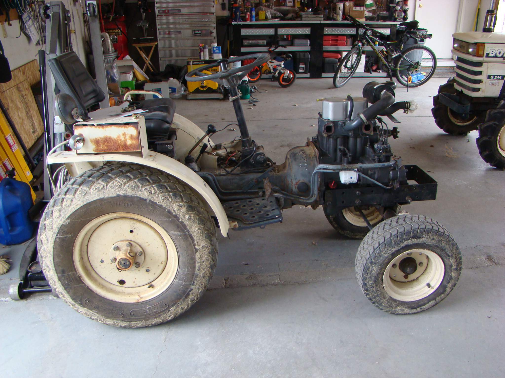

Looks like the weather is going to cooperate here this weekend so I'm going to push forward with a KE70 to KE75 engine swap. I plan on having it finished up by the end of next weekend. I'm not documenting every step, just a few snapshots. The biggest problem I had so far was splitting the TX1500 - the "donor" machine which is the Bolens G172 picture. It was my first split and the clutch was siezed to the spline on the transmission. I did a lot of head-scratching before popping the plug off the clutch hosing, removing the bolts to the flywheel and splitting the tractor with the clutch retained in the clutch housing. Fortunately the Iseki TX1300 slid right apart like it was supposed to but I still have it together until I get the KE75 ready. I ended up destroying the clutch disk removing it from the clutch housing using a puller, torch, and hammer.
I put a thermostat housing on the KE75 from another engine. This caused some interference issues with the fuel injection lines. I just bent them around the housing. Also installed a 400W block heater which can be seen where the starter goes (yes the starter still fits but barely after putting in the heater.) The freeze plug there is 40mm in diameter for those wanting to add one. I believe mine is a Kats off Amazon.
Checked the valve clearnance and had the injector nozzles pop-tested. The KE75 is a good runner and doesn't need anything else at the moment. Will update as I progress. This is a continuation from this thread:

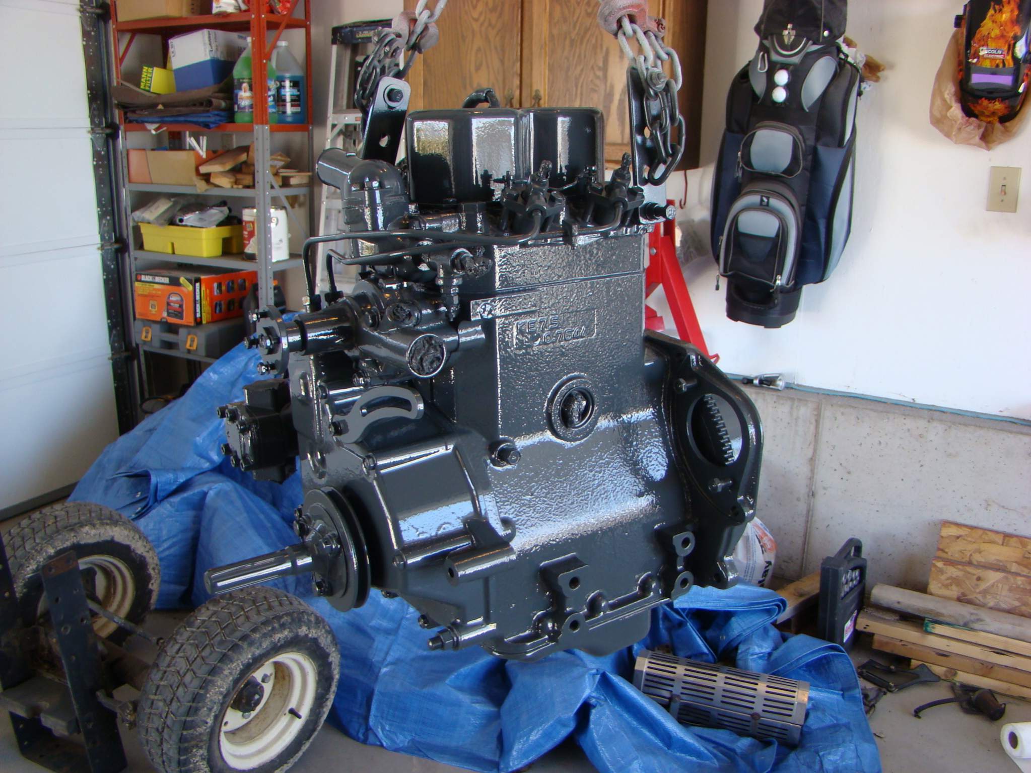

Engine painted Iseki gray and ready to begin swap...

That looks incredible! It should be a great swap! I like the collection you have of Bolens/Iseki's in the background too.. Is there a difference in the length of the two engines?
/ Iseki TX1300 KE75 engine swap
Thanks Mitch. The engines are identical on the outside the best I can tell. I'll find out for sure real soon though :) One of the tractors you see in the background (albeit just the front right tire) is a Satoh S373D or "Beaver III". It has the Mitsubishi K3A engine. That machine was on its last leg when I got it - borderline qualified for the junkyard. The engine ran good though. Four gears in the tranny were toast and one front final drive case was shattered. I knew there was at least one bad gear in the tranny but didn't suspect anything with the front until I got in it to change the seals. The Satoh tractors of this size and time period are very similar to the Isekis but only the engines are identical.

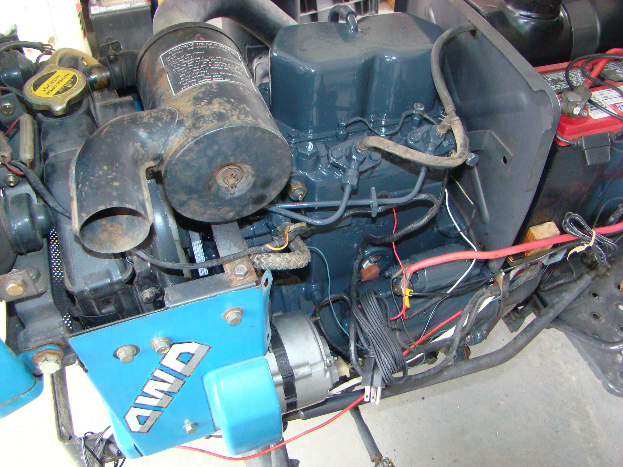

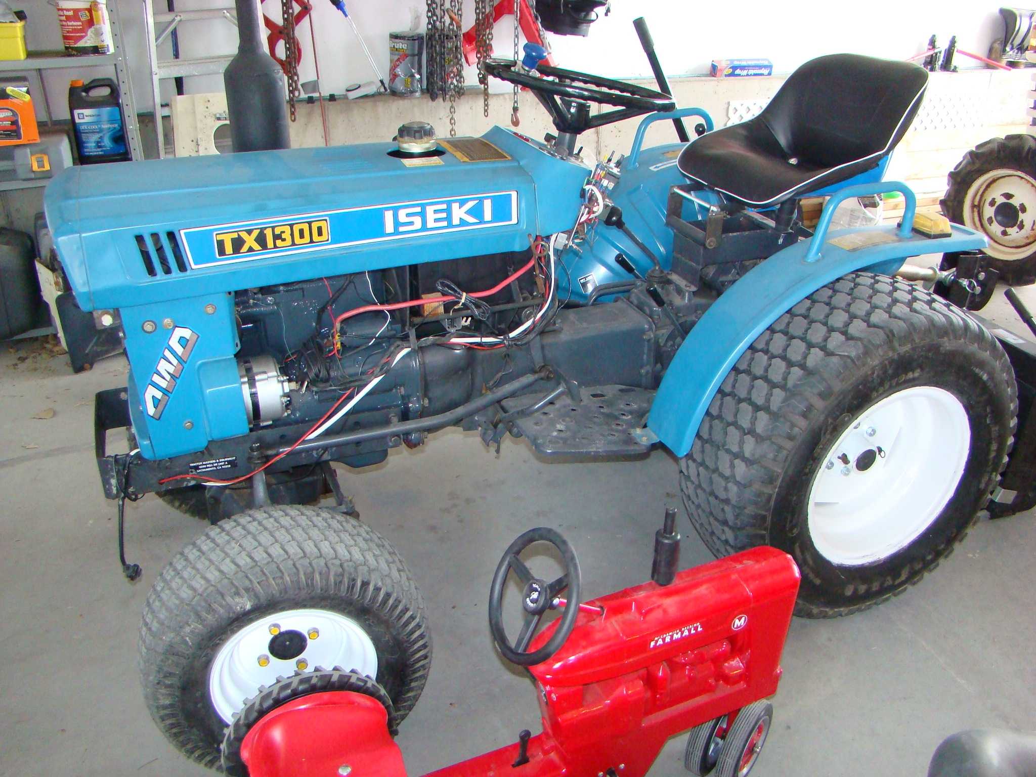

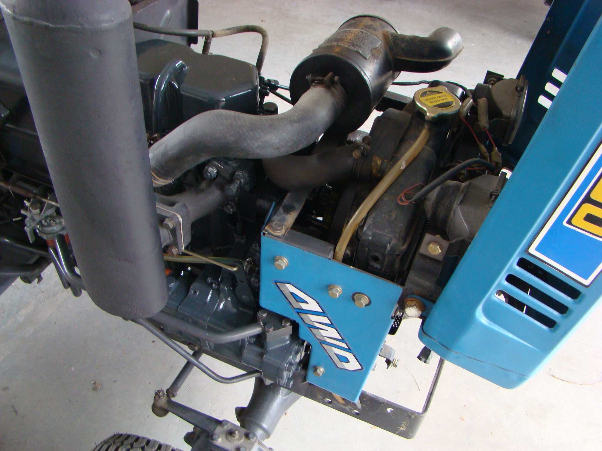

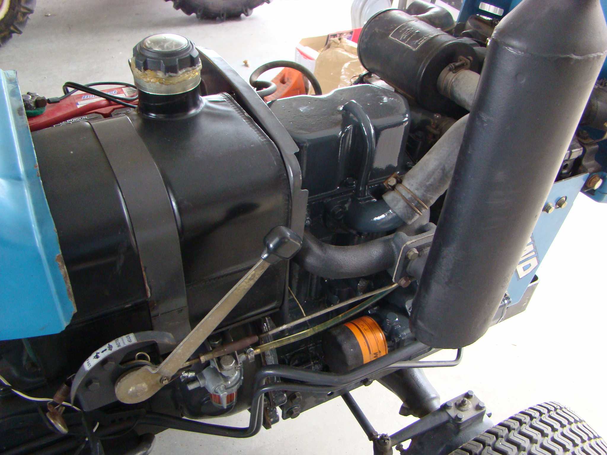

Almost done. Just need to install the front drive shaft. Will get that during the week sometime. Oddly enough the horn doesn't work of all things now. I did have to modify (shorten) the discharge hose going into the top of the radiator to account for the thermostat housing change and also the left side engine guard brace does not attach because of some adding piping for the temp gauge and recirc line. The hose mod is not pretty but appears to work. Everything else was identical. I apologize for the crappy looking intake filter housing. I didn't have time to clean it up.
The G172 now has the KE70 engine. I'll try to finish that next weekend so it at least will move under its own power (albiet weakly).
Had to shoot a pic of the farmall too :)
Now I just need to get some "TX1500" stickers for the side ;)

That looks great! It looks like you made great progress! Where did you find the manifold for the vertical exhaust? I am going to have to change my exhaust eventually, and that would be so much easier to find an exhaust. The only OEM exhaust that I have been able to find is in Europe, and is very expensive! I do know where they have the TX1500 decals.. Hood Decal
I didn't know that you have a G244 too..well, and a farmall:)
Thanks. It was a long weekend. The exhaust manifold came with the tractor. I looked around before for another but couldn't find one. Looks like the horizontal mufflers come with their own built-in manifold with separate pipes so it makes it kind of difficult to go vertical.

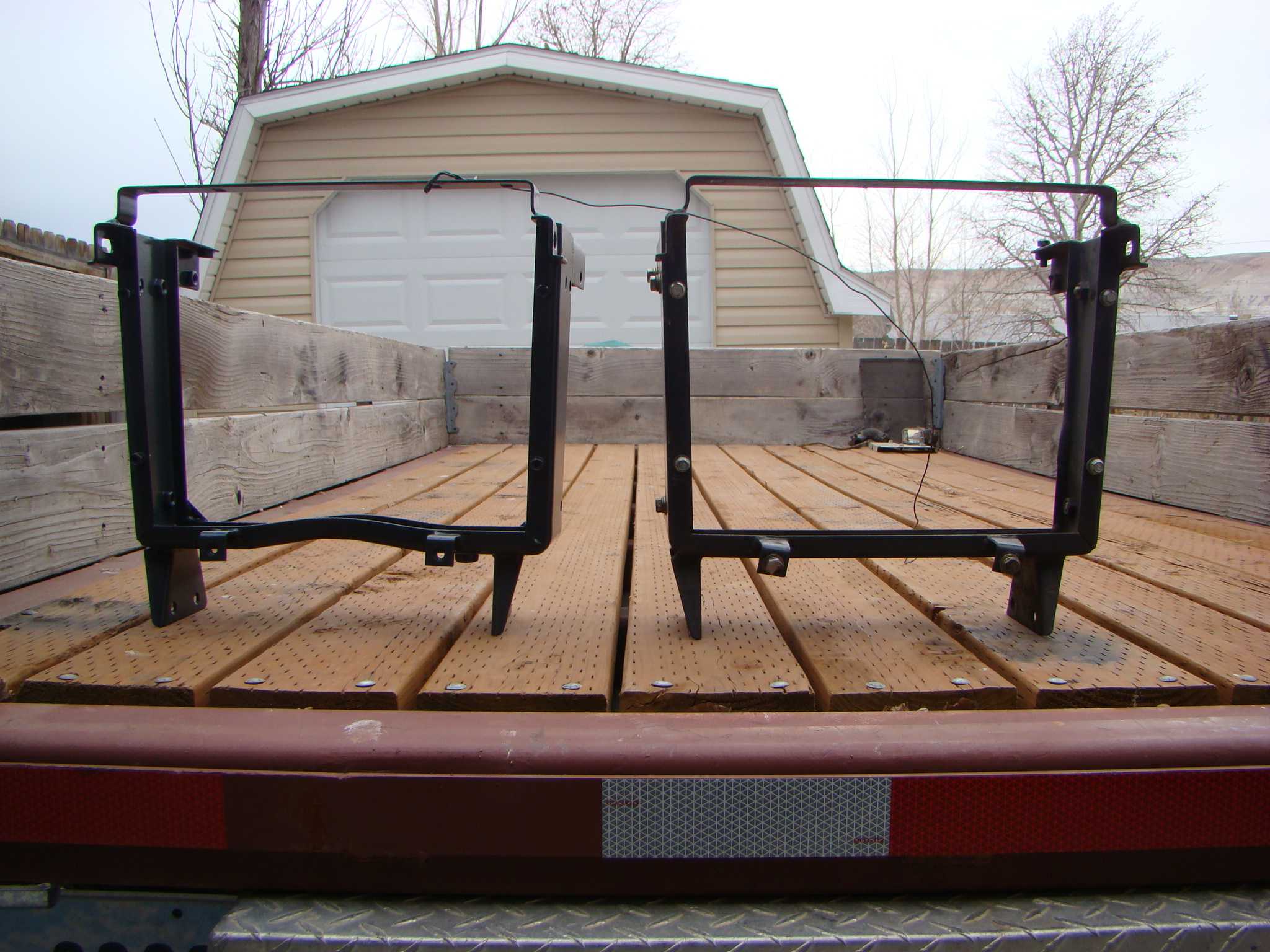

Thought I'd post this for those thinking about installing a front PTO. I ran into a slight problem with the one on the KE75. When I first installed the original radiator and radiator frame from the TX1300 I noticed there wasn't much clearance between the PTO and the frame. Later, I saw it was actually rubbing due to flexing of the frame. After further investigation, I noticed the radiator frame from the G172 had a pressed arch in the bottom to allow for the PTO (see pic). I'm in the process of swapping it now. One other thing, at least in my case - the front bolt pattern that bolts the radiator frame to the front axle/engine frame is closer together on the G172 for some reason. I'll need to drill new holes that are about one diameter wider towards the front of the machine to make them line up with the TX1300 engine frame holes. Please consider these things when adding a front PTO.
