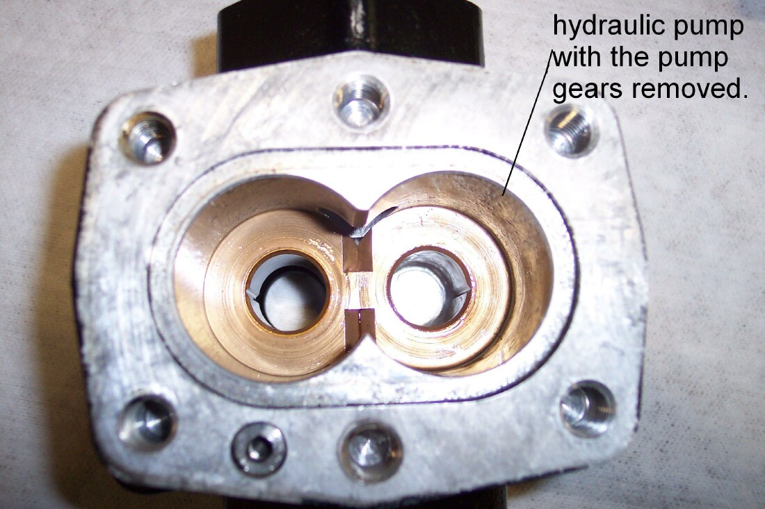

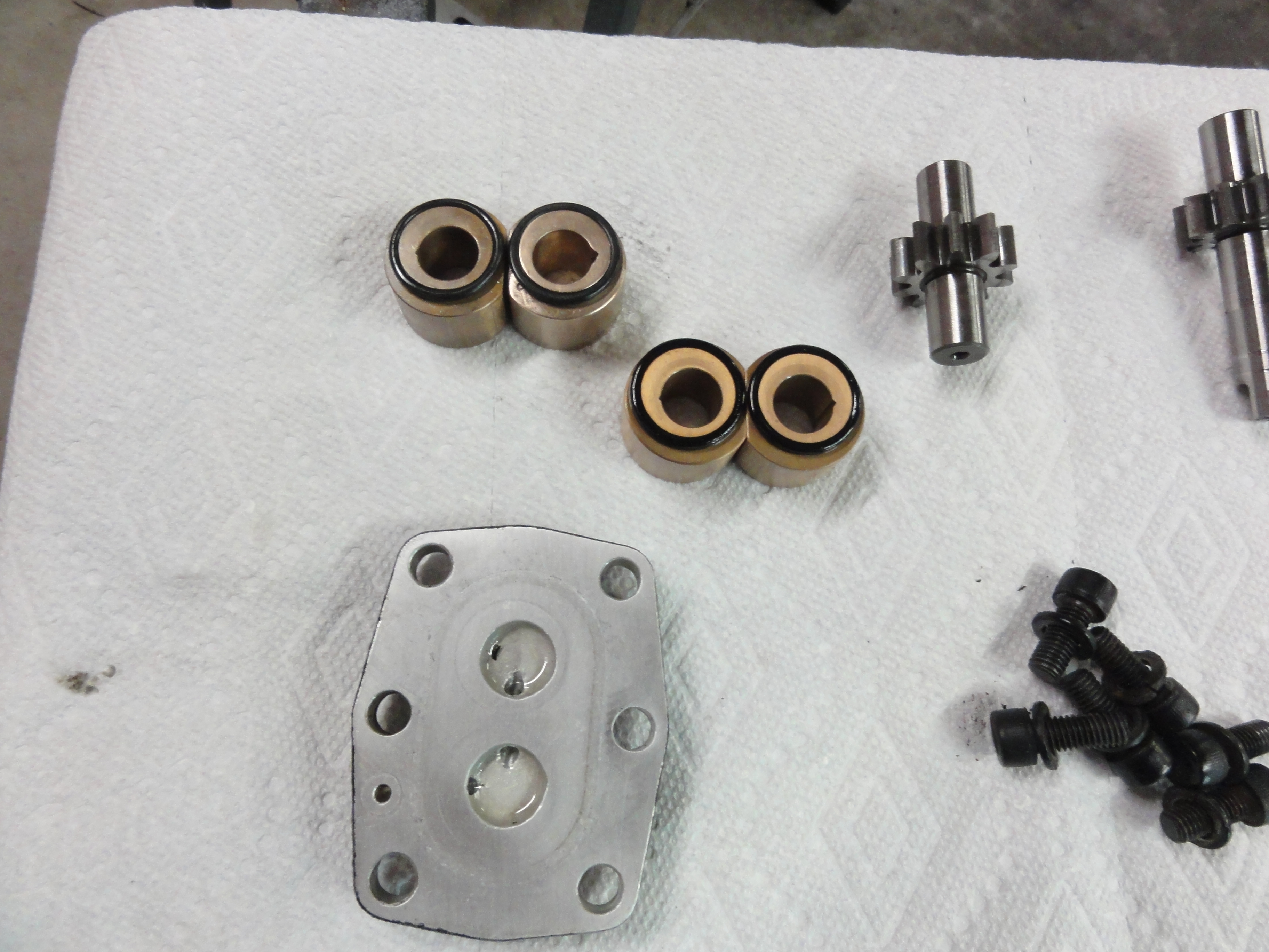

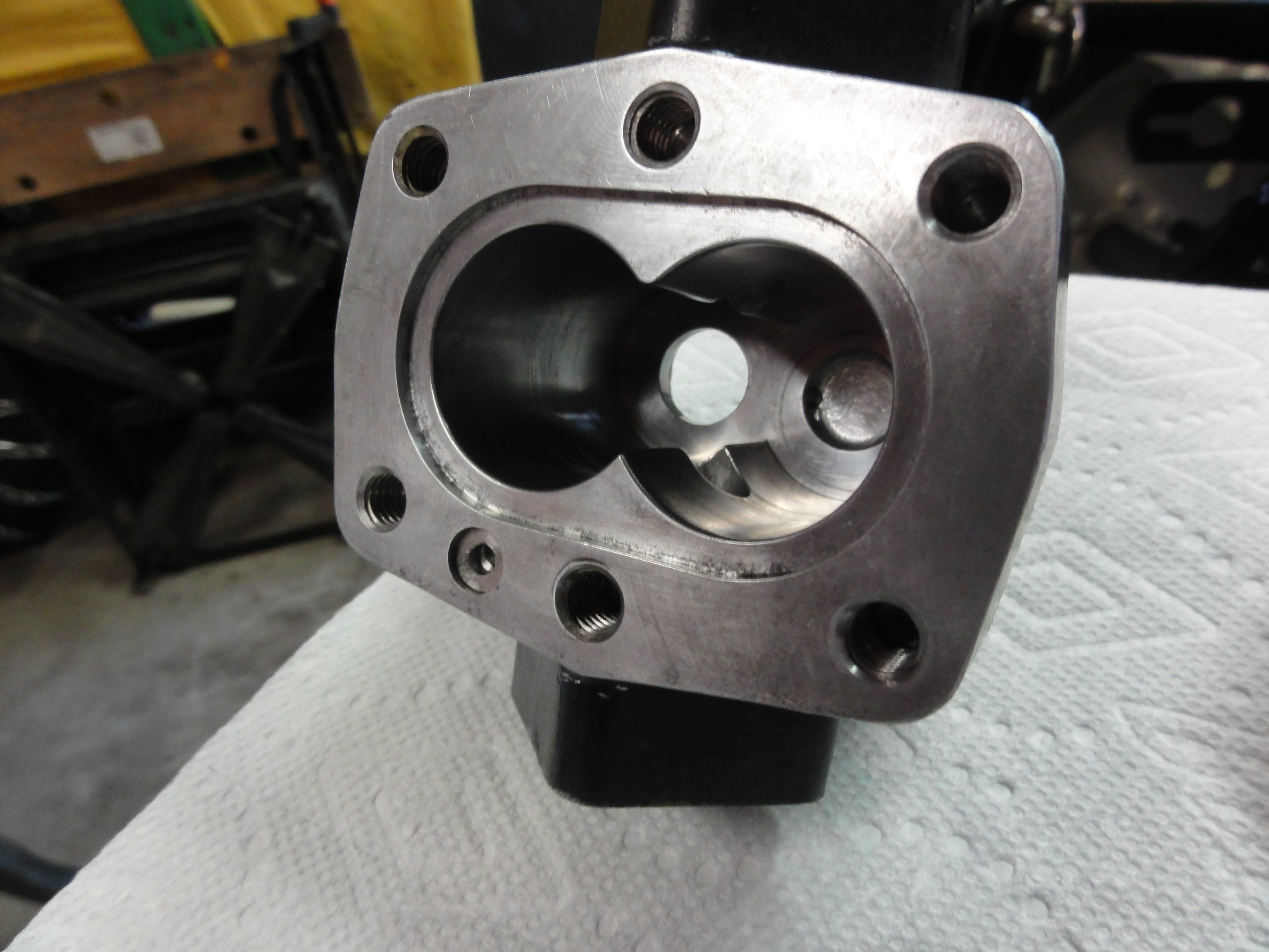

Hey Dan,
The bushings are not meant to be a press fit. They just get stuck over time.
After you get all of them out you will want to clean and polish them
with a piece of crocus cloth or a scotch brite pad. The bushings
should slide in and out easily so when the pump is assembled the o-rings
constantly keep the bushings pressed against the sides of the pump
gears thereby minimizing the amount the gears move back and forth.
This also keeps the gap between the gears and the bushing
to a minimum for better suction in and pressure out. I believe
the bushing are suppose to be able to move freely to compensate
for wear . I think that is why the bushing have a flat on them.
And because the bushings can float the flat keeps them from
spinning in the pump housing bores. But hey that's just
my mechanical though processing of how I think things work.
I don't have any documentation to substantiate any of the above
information, Its just my opinion.

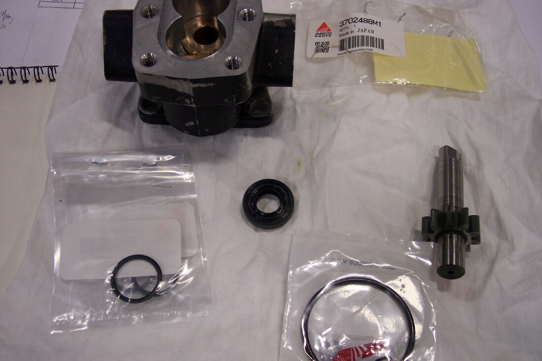

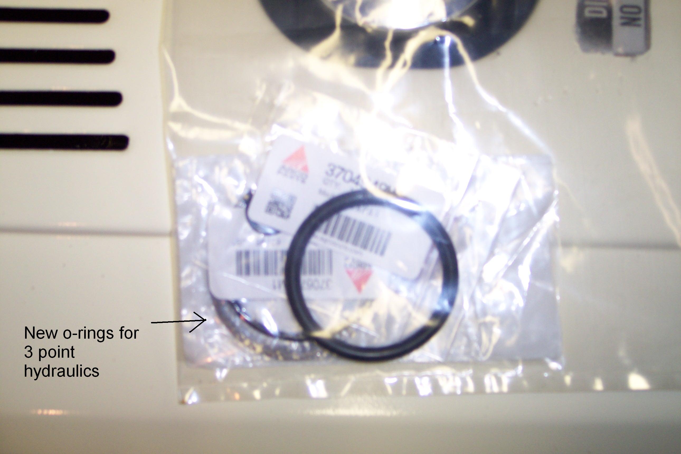

Well a frustrating afternoon, all the new parts for the pump arrived, so duly rebuilt and installed. The pump was getting a good pressure just hand turning it on the bench... but its not the problem! Still no pressure at the lift arm.
I guess now it's either the valve block or the ram cylinder. Not sure which I'll tackle first, probably the valve block since that's easily accessible. It's going to be hard to diagnose anything since I don't have any way of pressure testing it - I'm assuming either the block or the ram is just bleeding all pressure to the tank.
Any thoughts?

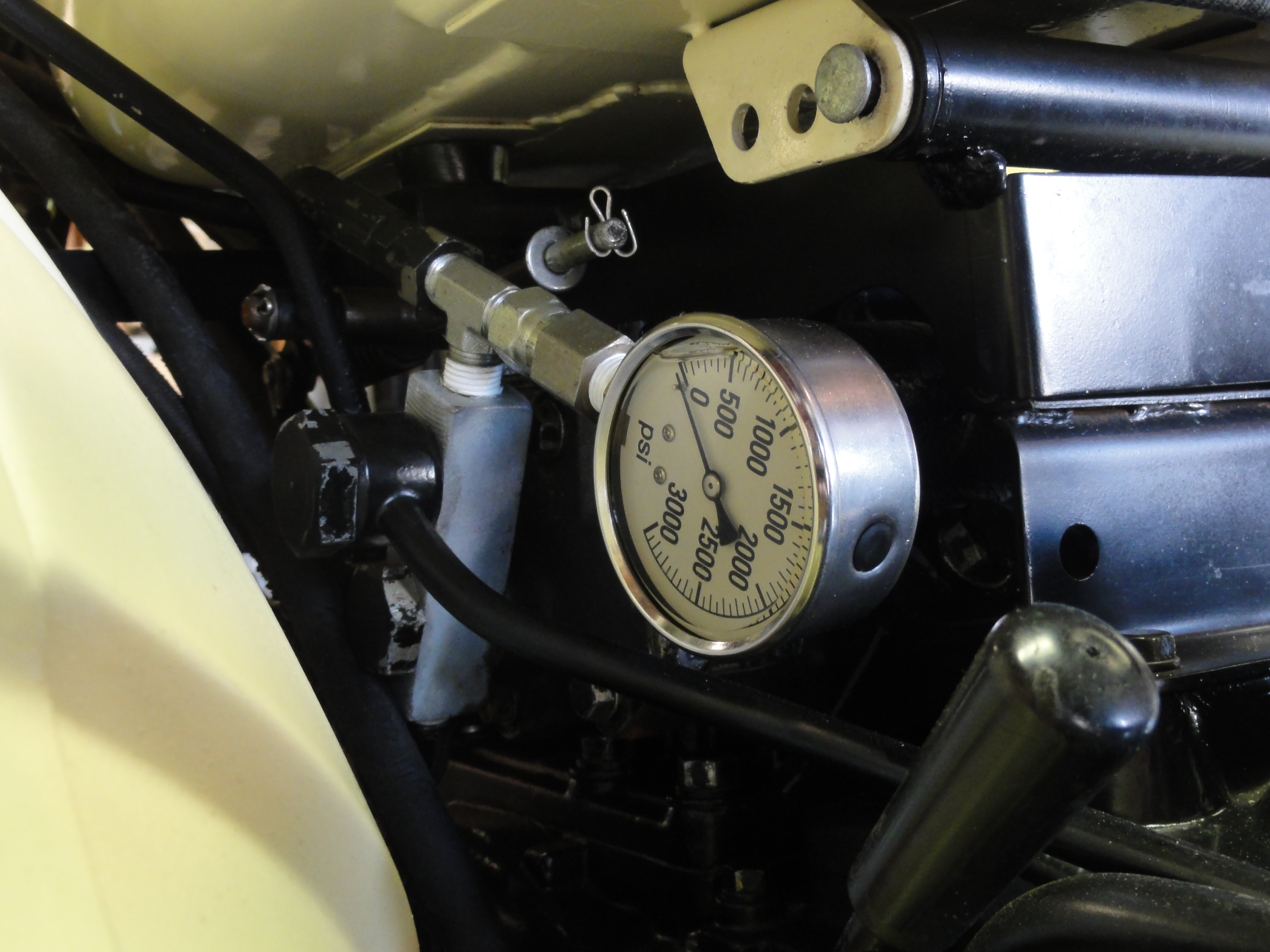

/ Iseki TX1300/1500 Hydraulic Woes #27

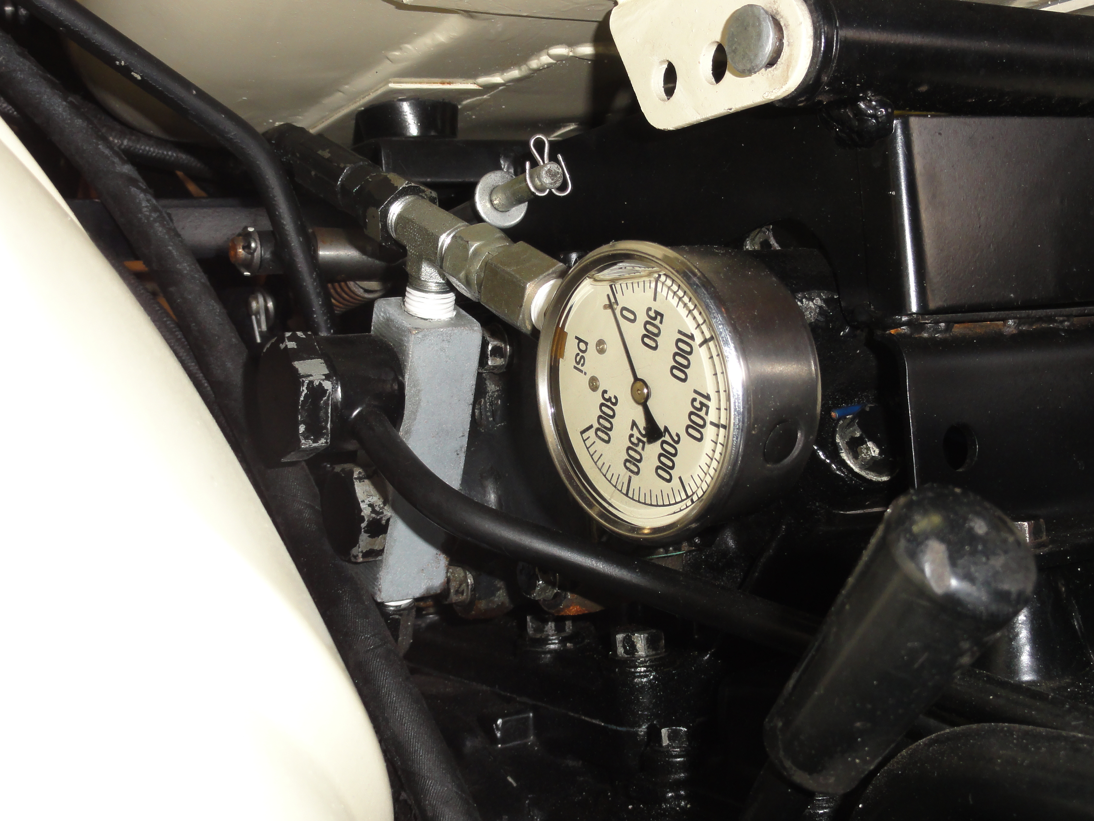

I just read all of the post in this thread and I didn't see where you made
sure the screen was not clogged or where you said anything about
checking to see if something was plugging the pickup line to the pump.
As far as a gauge goes, Here are some pictures of what I did to
keep an eye on the hydraulic pressure. I bought a gauge for
hydraulics and a few fittings and mounted the gauge in line
at my manifold. I can check my pressure any time.

Yes, did check the filter, pretty clean actually. Logically, I didn't ever suspect it as I had good flow through the system.
Still haven't had time to check the block or the piston yet. For the piston it would be nice to have the replacement rings on hand when I do it, so it could be a while.

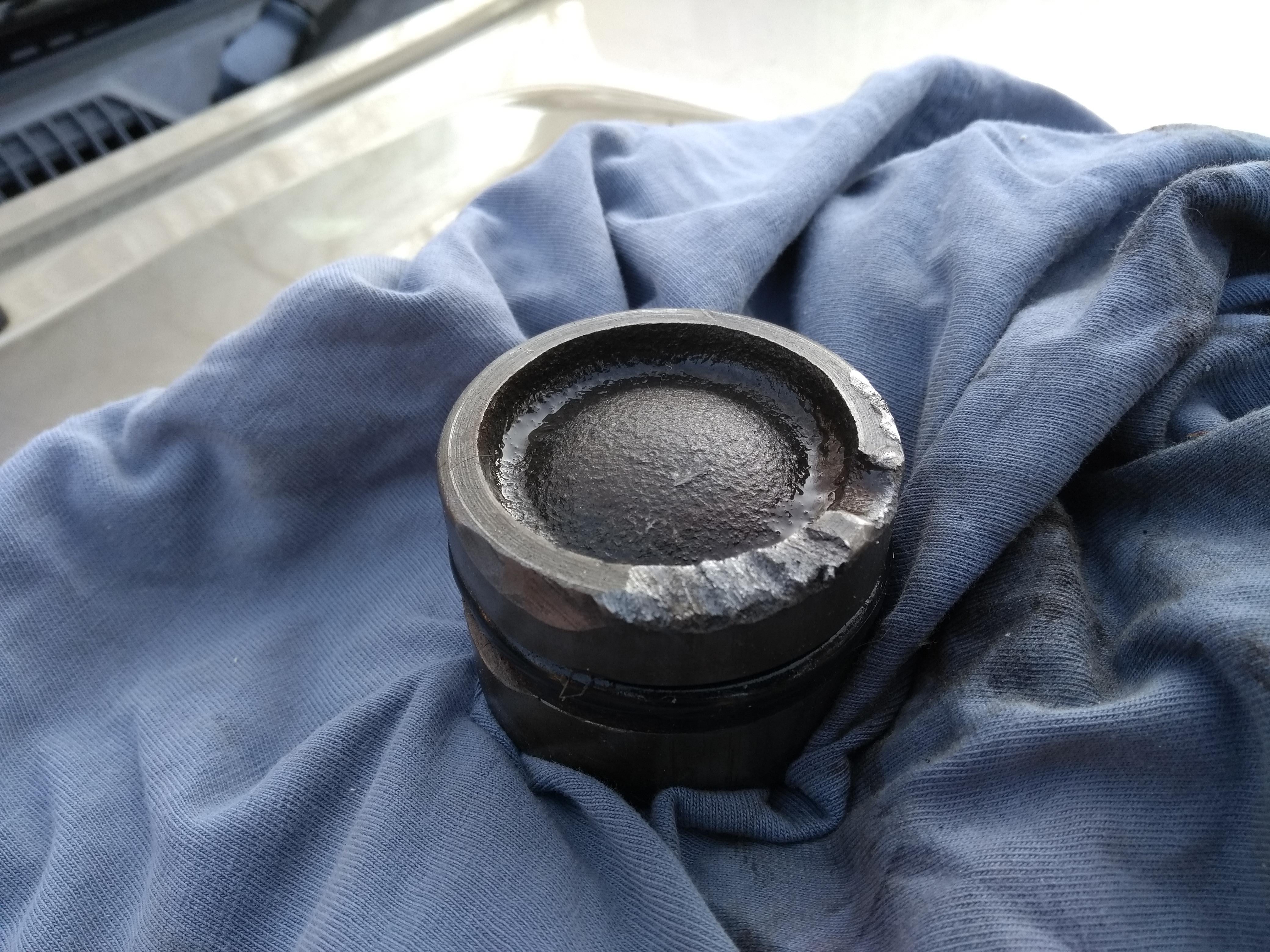

I removed the lift arm assembly last night, to find that the ram had no piston in it! Somehow it had been ejected out of the cylinder into the gear case.
This should not be possible, but yet it has happened. I found the piston in the gear case, badly damaged from grinding against the bevel gear. The ram cylinder seems ok except for some damage at the bottom. It should be repairable.
Very lucky not to destroy the gear case. Lots of flushing coming up.

I only got one shot before my phone battery ran out! Will get more tonight as I need to inspect the ram cylinder to make sure it's repairable.
There is more damage than this!
The grinding from bevel gears in obvious, but there are some more curious indentations that make me wonder if they were caused during the ejection or were already there.

For me it is important to understand the orientation of your piston first.
Is the side with the indentations the one the hydraulic fluid presses against, or, is this the side where a push rod bears?
Post a picture of the other part(s) in contact with this piston.
Often, owners will physically lift the lower 3 pt arms not realizing they could be allowing the push rod to drop out of position.
This is a mistake I too made and as I lifted the lower arms, this movement allowed the push rod of the 3 pt hitch to drop out of place and then when I activated the 3 pt, it pushed out a sickening part of the rear casting on my Nuffield. The roll pin had worn out and the piston pushrod was not being kept in its proper position when the lift arms were raised by hand
This is a 3 pt piston seal detail which I expect should also exist on your tractor..... a nylon backup ring behind the O ring.

Dave, thanks for all that detail. The picture is of the pressure side of the piston.
The piston is definitely condemned! The underside is even worse.
The o rings are in place as per the parts diagrams, no problems there.
I think what you are saying about over extending the arms is probably correct, although I don't recall this happening. I'm also curious about it, as my other TX1500F relies on the arms being fully extended to power the loader. I'm planning on a few experiments when I get time to see at what position the piston can be ejected.
In thinking about this photo I have provided, I now see two nylon backup rings on the same side of the O ring. One nylon ring should be on each side of the O ring to keep it from being extruded into the small gasp between the piston and its cylinder
Before you condemn your piston, lets understand how it works.
Dave M7040
Are you certain its 2 white backing rings and not one with 2 coils,
Chris
