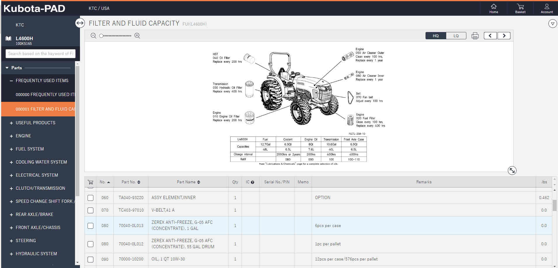

Is Zerex GO5 compatible with Kubota Coolant

The parts list online at Kubota lists Zerex G05 for my L4600H (2013)
